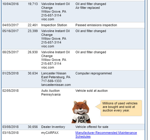

Hello, I would like to buy a car from the dealer but Carfax report shows it is computer reprogrammed. so it okay to buy?

I do not know if it is checked for codes here is Carfax report please take a look and let me know.

I call that service center they said it is recalls with PCM and OCS. I have no idea what it means. Would you please provide me your suggestions.

Hi guys. Reprogramming of the engine computer can be done for numerous reasons. When a recall is involved, those relate to safety concerns, emissions issues, or sometimes customer satisfaction complaints.
There is a software package installed at the factory that provides a base line or starting point the computer uses for fuel metering calculations and spark timing to get the best fuel mileage and lowest emissions. There are "lookup tables" where, based on things like coolant temperature, throttle position, throttle direction of change, throttle rate of change, load on the engine, engine speed, intake air temperature, and dozens of other things, the computer finds the exact specified amount of fuel needed and when to fire the spark plugs. Sometimes the engineers discover that under just the right combination of sensor data and operating conditions, emissions might go above the legal limit for as little as a few seconds. They will update the software to address that, then that updated software will need to be installed in the car's computer.
Things change too when some wear has taken place in the engine. There may be something advantageous in terms of better fuel mileage, smoother shifting, or increased performance that could not be accommodated before the engine's break-in period. Based on the vehicle's mileage, the manufacturer may request the dealer install the pre-planned software update. One car model in particular that I am aware of will develop seriously-reduced engine power at 20,000 miles so the owner takes it to the dealer under warranty. The revised software is installed at that time.
The fact the engine computer was reprogrammed is a good thing. That means whatever the concern was, it was addressed, rather than leaving it for the next person to take care of.
