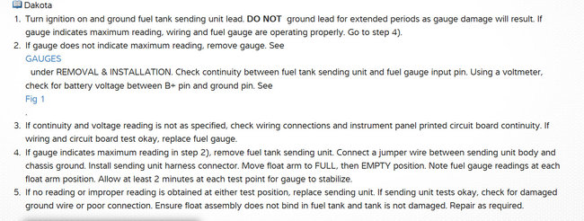

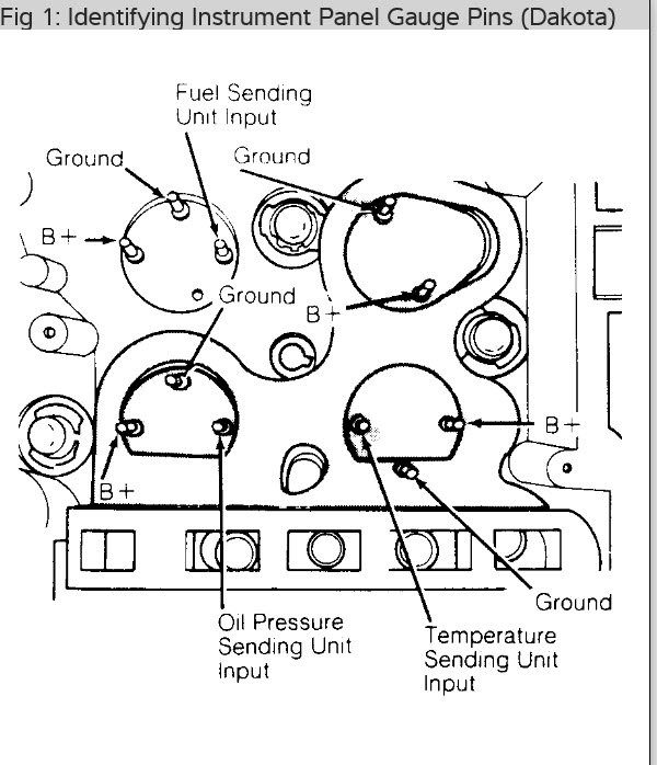

because the dash is digital it can be that and should be checked further to see if it is that or something else. if the pump is going out then it may be a bad connection or something causing the gauges problem as well. Picture shows how to diagnose gauge to see if it is the problem or not. most of the time it is a sender.
