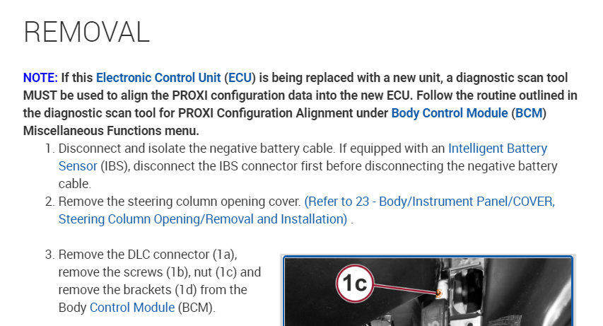

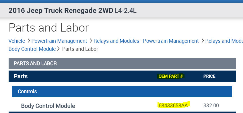

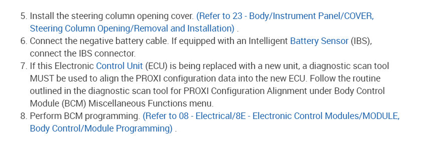

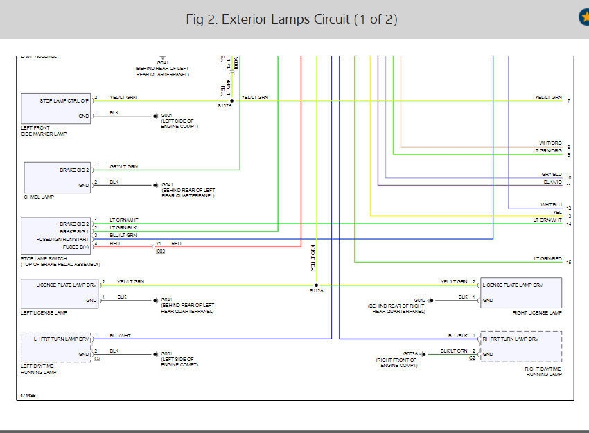

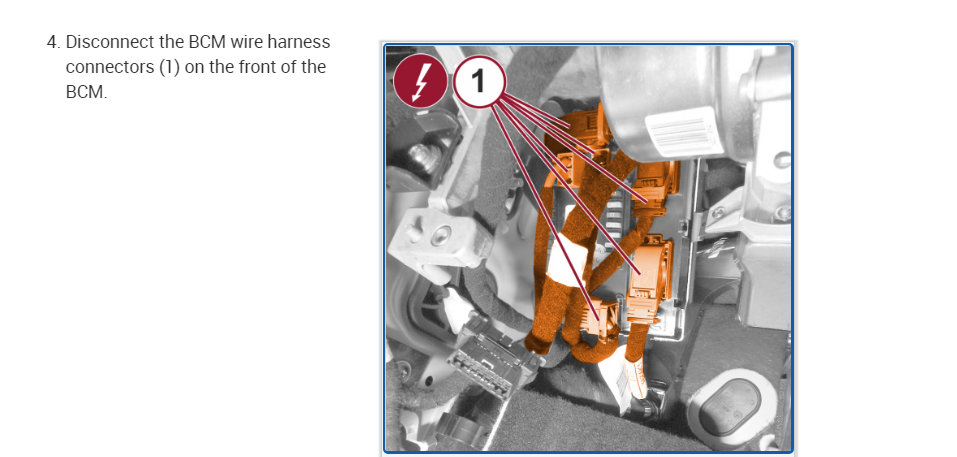

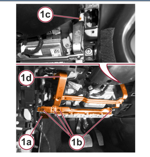

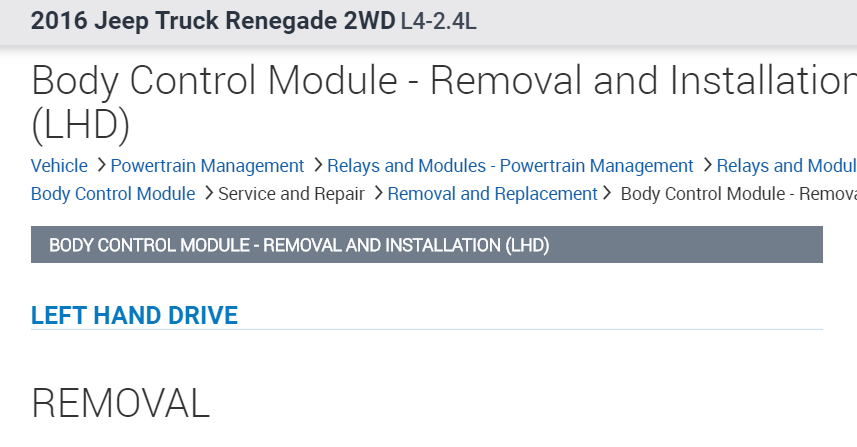

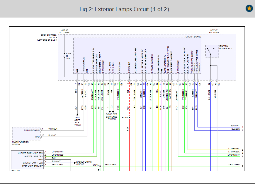

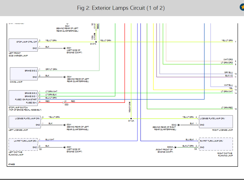

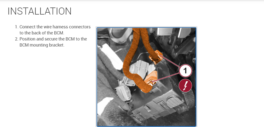

This is probably going to be a problem with your vehicle's Body Control Module (BCM). If you look at the wiring diagram of your vehicle's exterior lights that I have included for you in the diagrams down below, you can see that the license plate lamps only have two unshared wires in their circuits. The power is provided from the BCM and each side has a separate ground. The only way that this and the left tail lamp would fail at the same time would probably be the BCM. In the diagrams down below I have also included the Original Equipment Manufacturer (OEM) part number as well as the removal and installation guide for your vehicle's BCM. Please go through these guides and get back to us with what you are able to find out.
