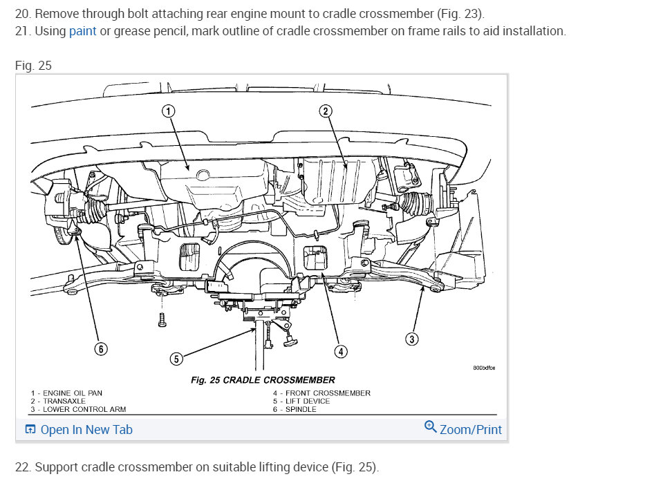

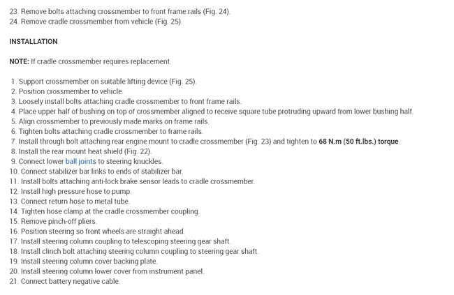

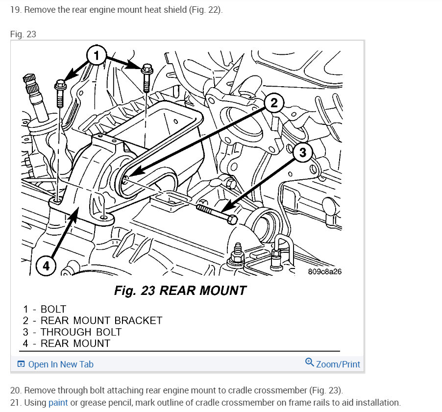

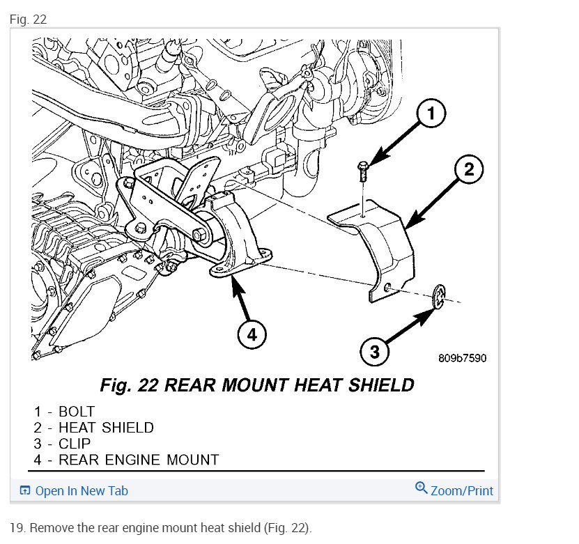

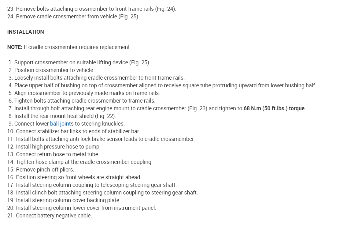

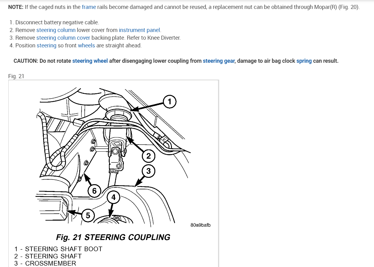

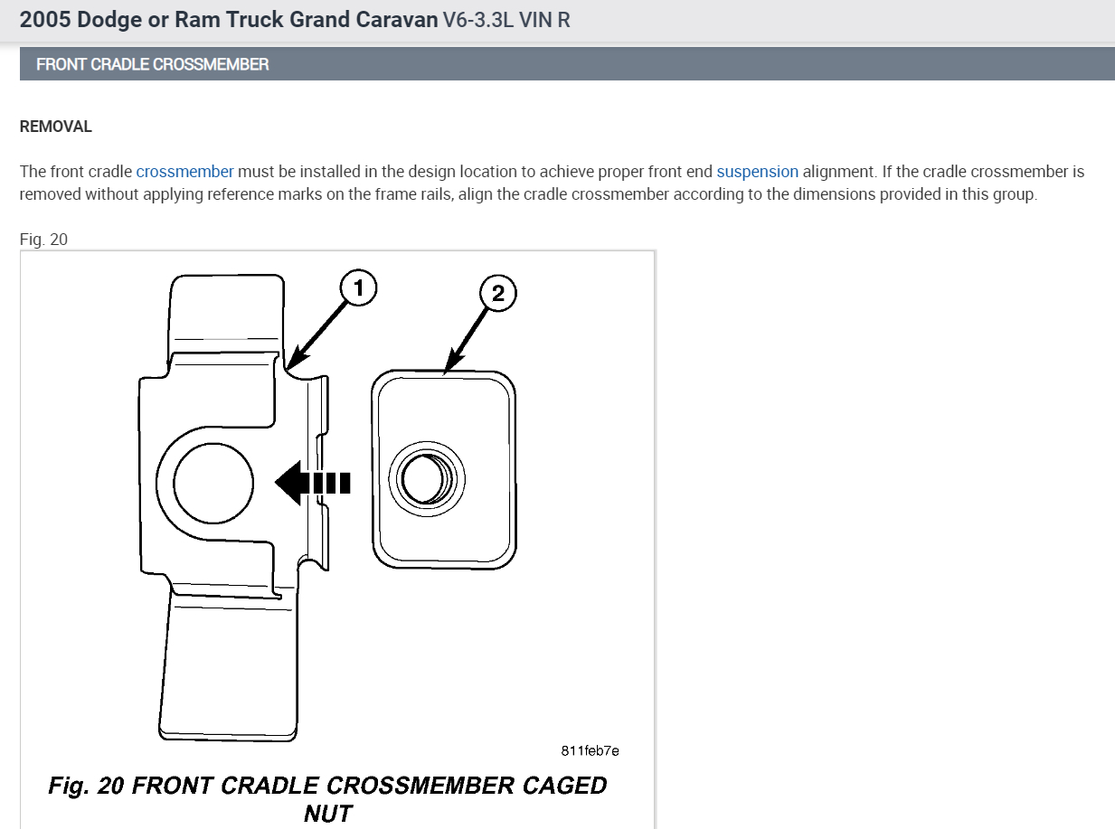

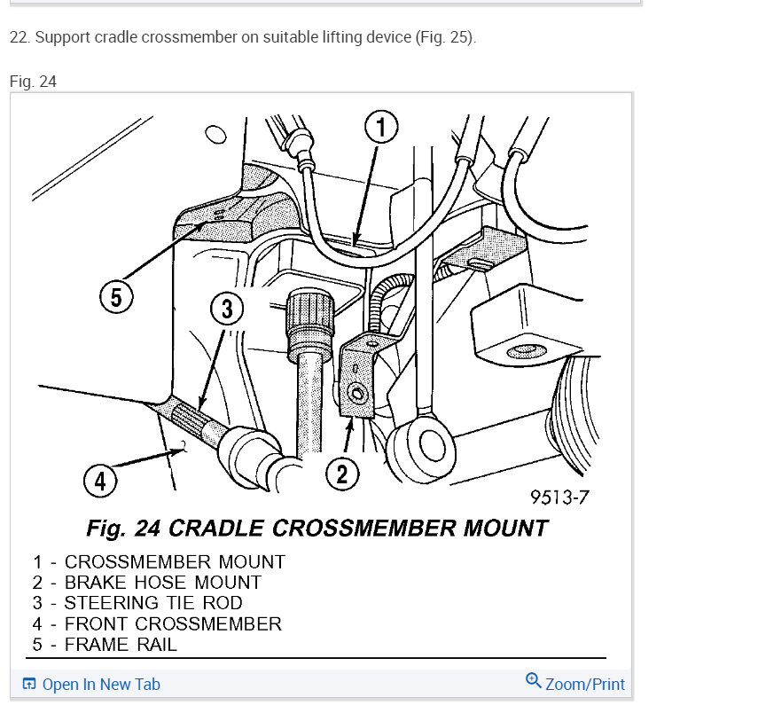

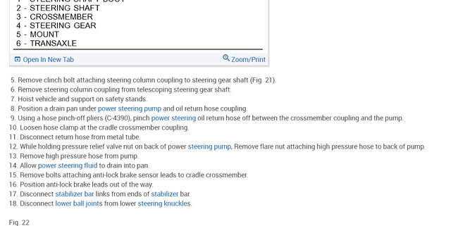

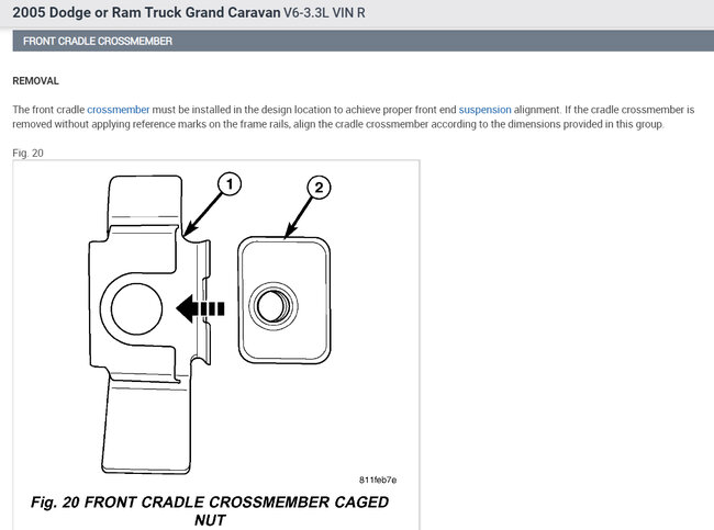

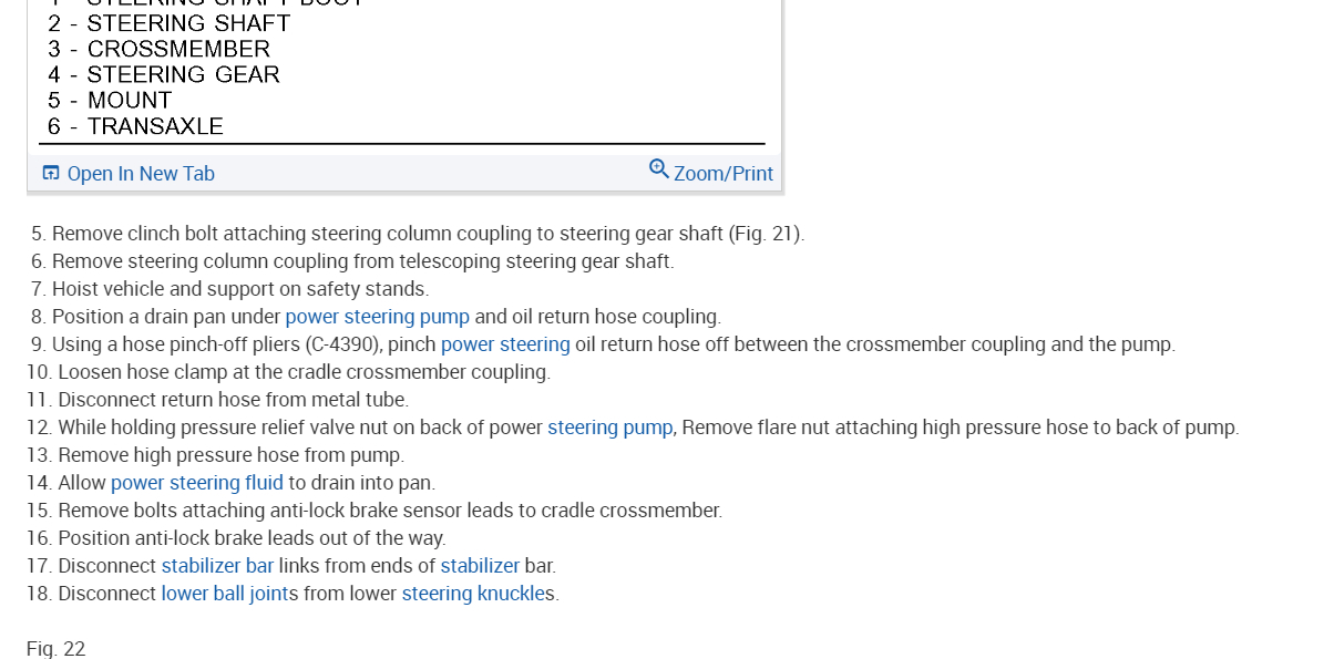

It looks like they do have a carriage nut that you can replace to fix the broken and stripped out threads. I would spray wd40 over the remaining bolts and nuts before you begin and allow it to soak in for a few hours. Here are the instructions on how to change the engine cradle out. Check out the images (below). Let us know what happens and please upload pictures or videos of the problem so we can see what's going on.

Is there any way to access that caged nut? (I understand it’s caged, lol) I mean what’s the best way? Cutting a hole? The caged but definitely broke free on the passenger rear one and the driver’s side the nut lost its thread. And thank you so much for the info so far, it definitely feels like privileged info and is harder to find than most people would think, barring access to a shop’s manuals.
