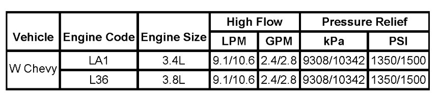

We have an 2005 Malibu that we are planning on scrapping and my 2003 Impala needs a power steering pump. Are they compatible?
Oct 20, 2019 at 12:48 PM

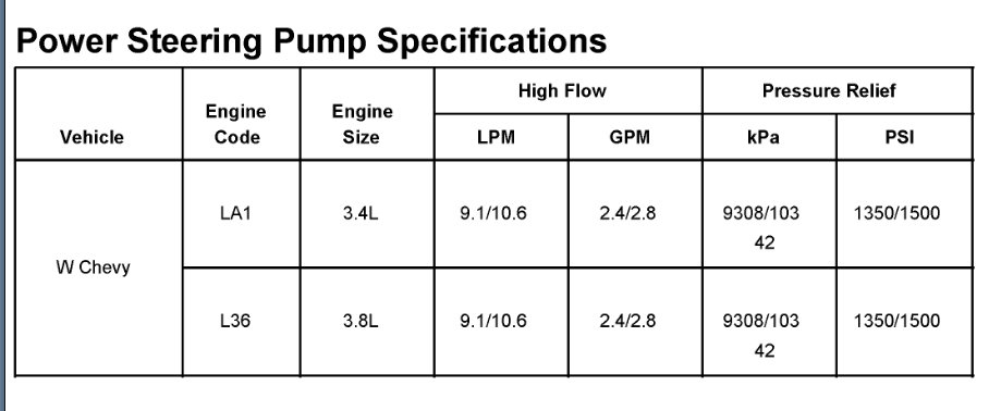

From what I can tell they are compatible. I show the part numbers are the same so unless the manuals are wrong, I think it will work. Also, attached are your pressure specs which are the same so you should be good to go.
Part numbers:
2003 26086103
2005 26086103
