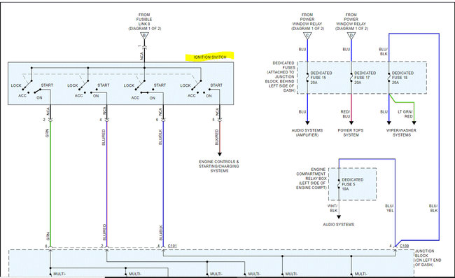

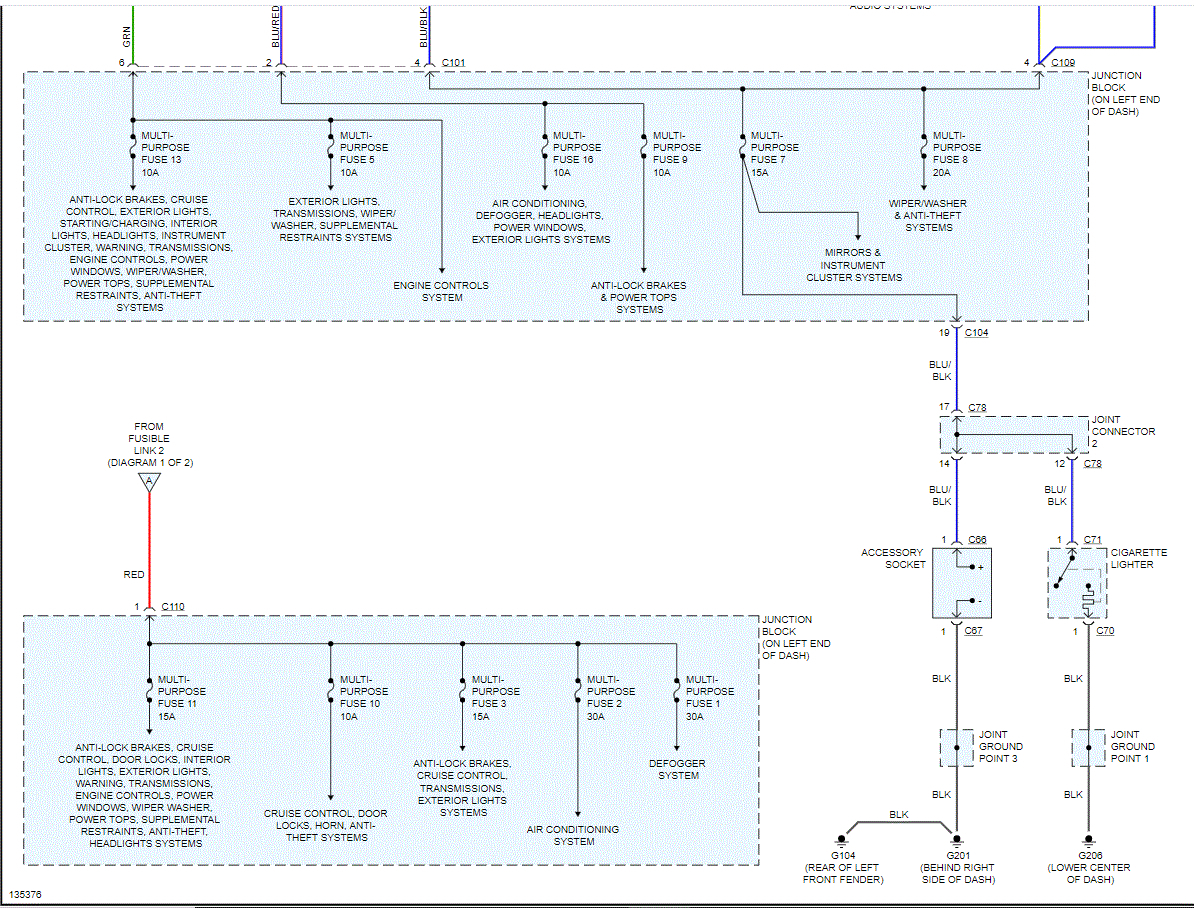

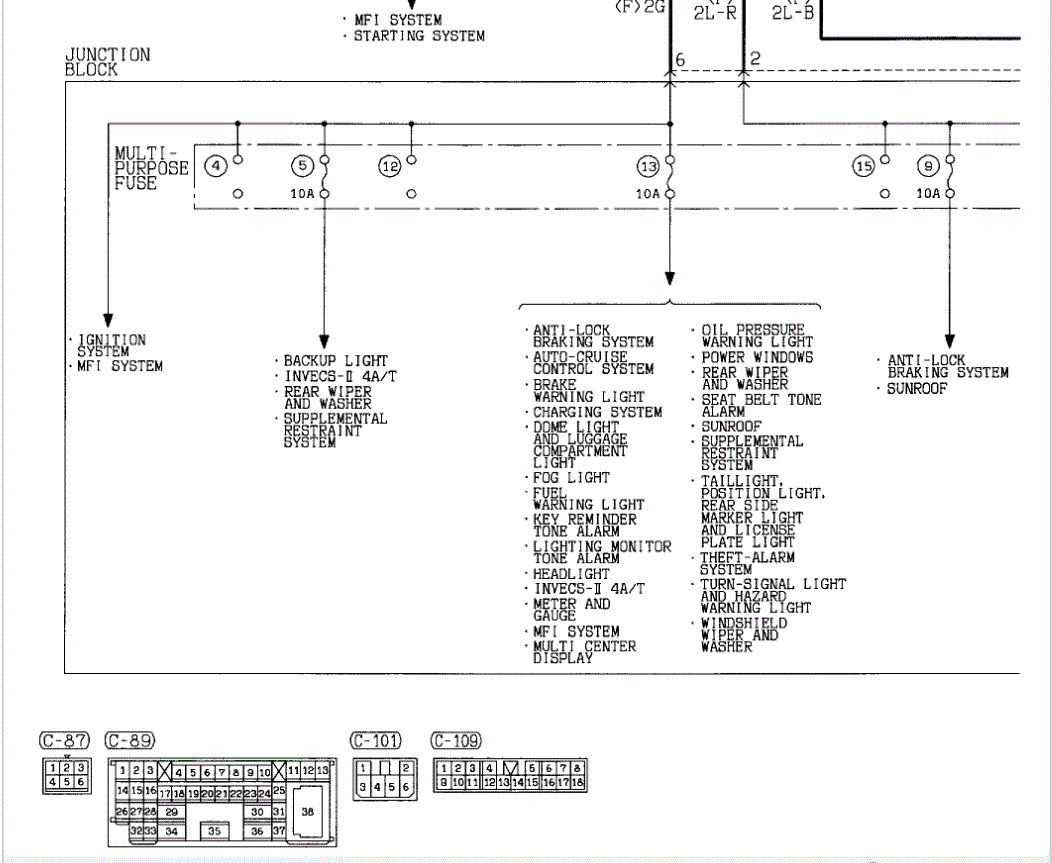

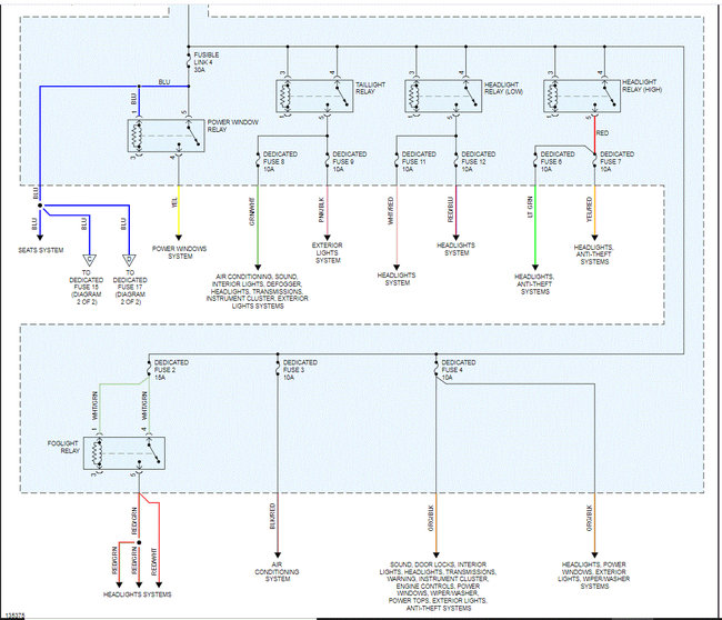

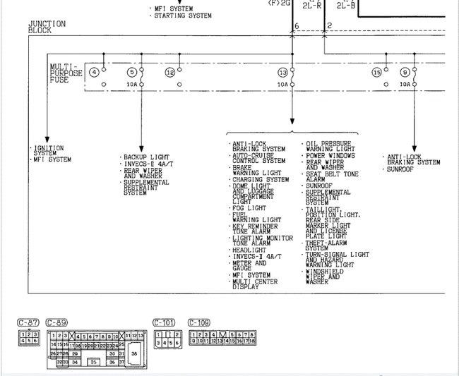

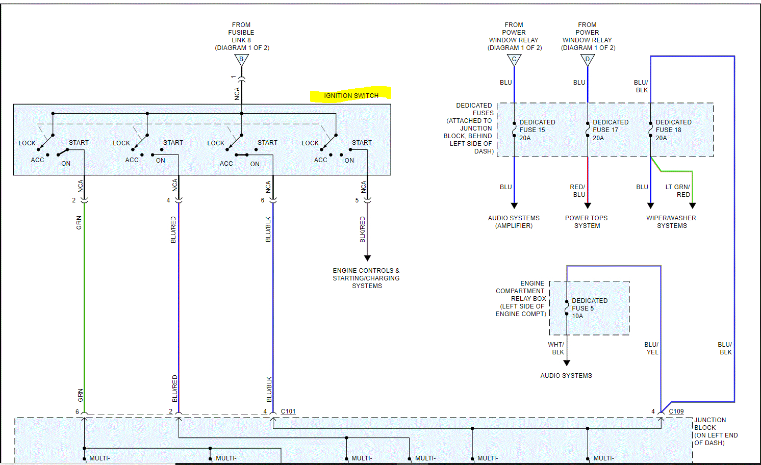

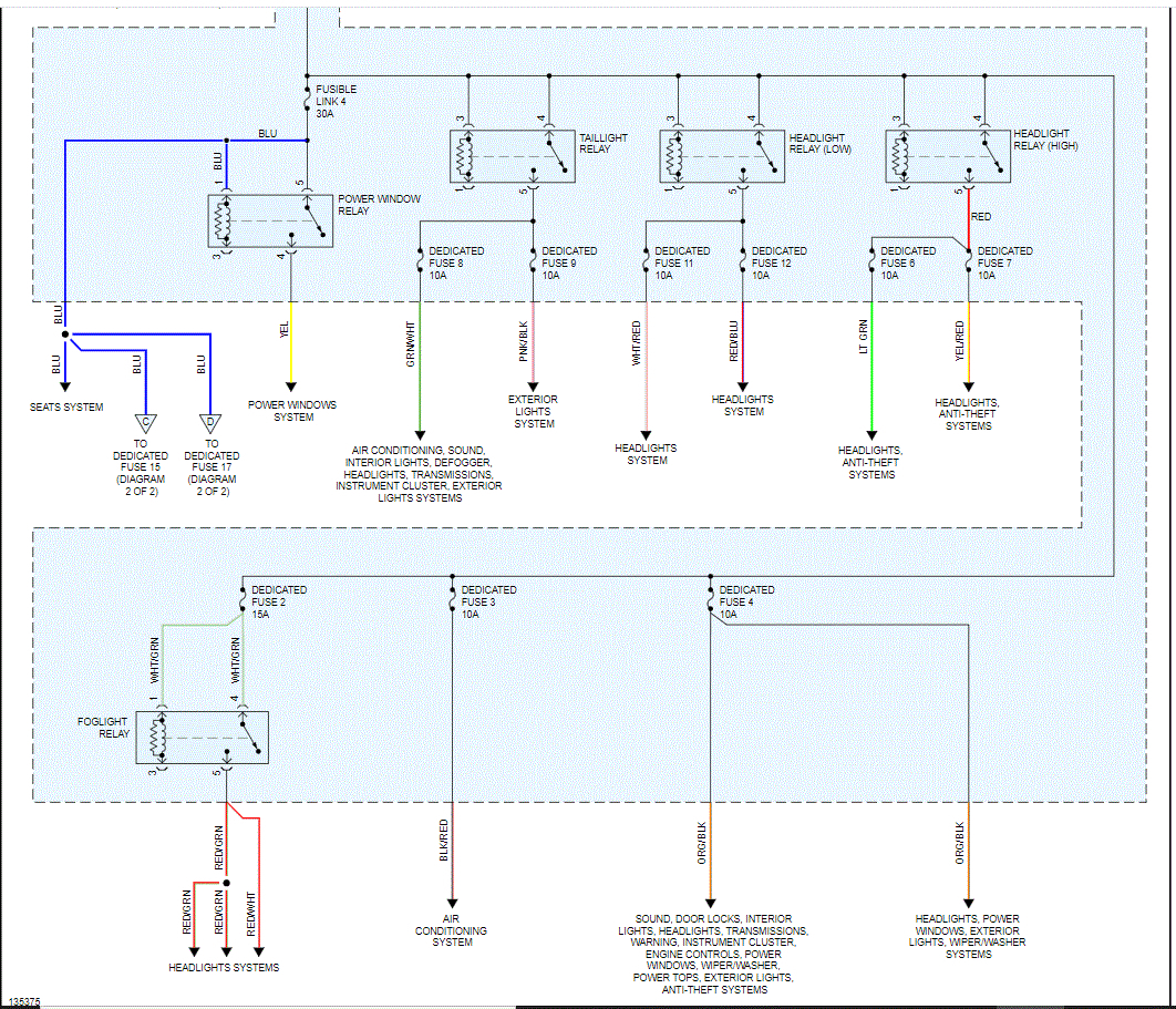

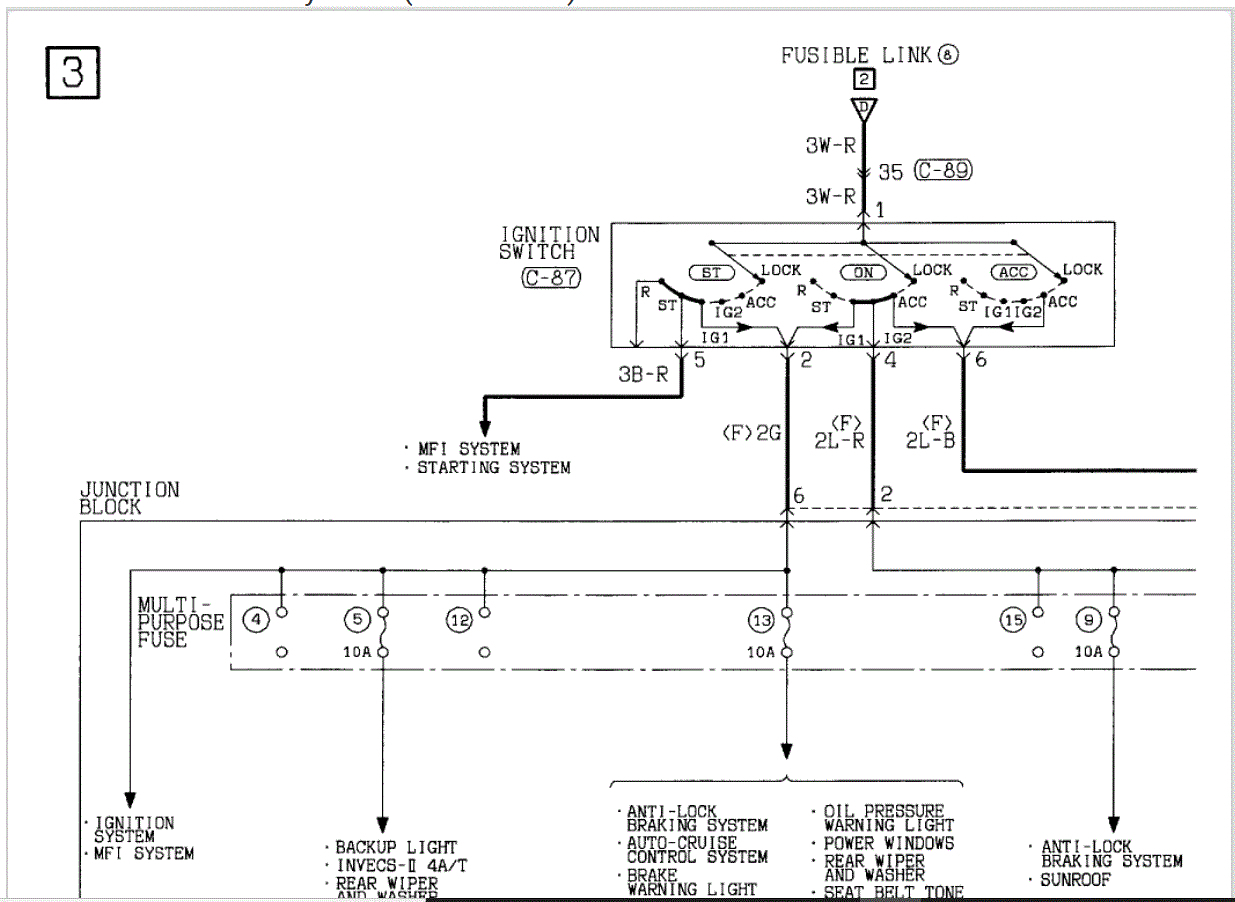

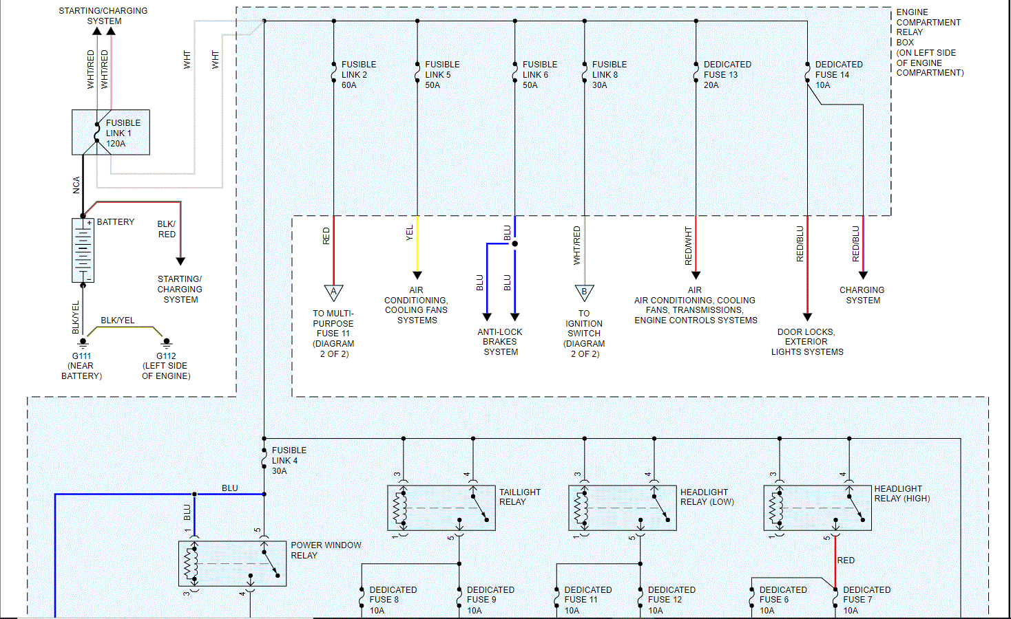

I was able to find an original OEM schematic of the switch. The colors are abbreviated.
The last 4 pics are from my manual. I had to cut the pics in half to make them readable. I did overlap them. If you look at pic 5, I highlighted the ignition switch. This may be easier to follow for you.
I hope this helps.
