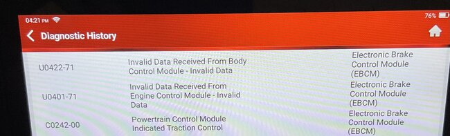

Ya, I got a few codes did it not post? I will try add the image again.

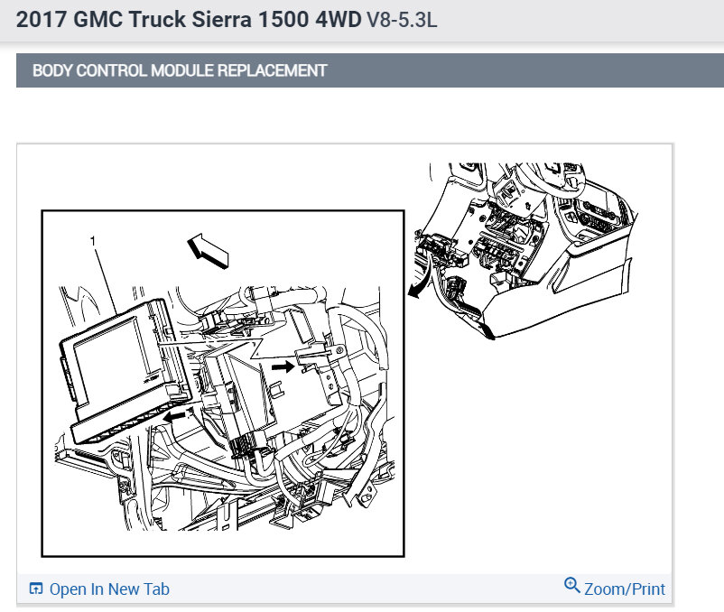

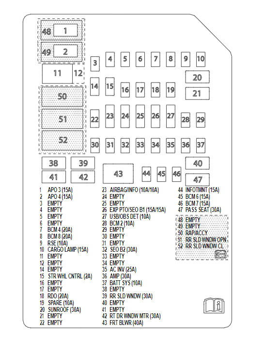

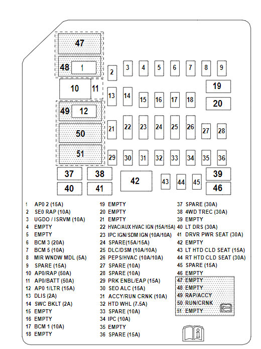

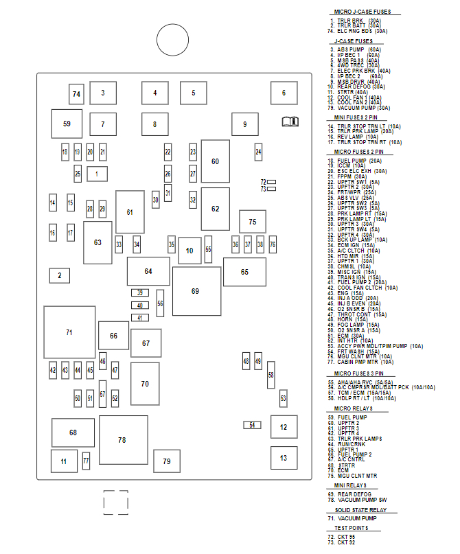

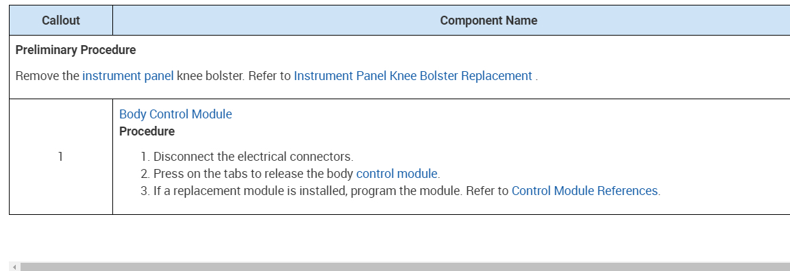

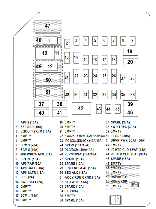

Was this truck in a flood or an accident? It looks like the BCM has gone out, but I would start by checking all fuses with the systems on. This guide can help:
The U0422 code in a 2017 GMC Sierra indicates a problem with the "Invalid Data Received from Body Control Module" or BCP (Body Control Module "B").
The U0401 code is a generic diagnostic trouble code (DTC) that indicates a communication problem between the Engine Control Module (ECM) and the Transmission Control Module (TCM)
Here are the fuse locations so you check run the test and I have included how to change the BCM out as well, you can get a preprogrammed unit by searching Google or Ebay. Check out the images (below). Please let us know how it goes.

Also, is there a reason that all those codes are coming from the EBCM?
Aug 15, 2023 at 3:22 PM
Okay, it looks like the EBCM has gone out, please follow the steps above to fix the problem. Please let us know how it goes.
