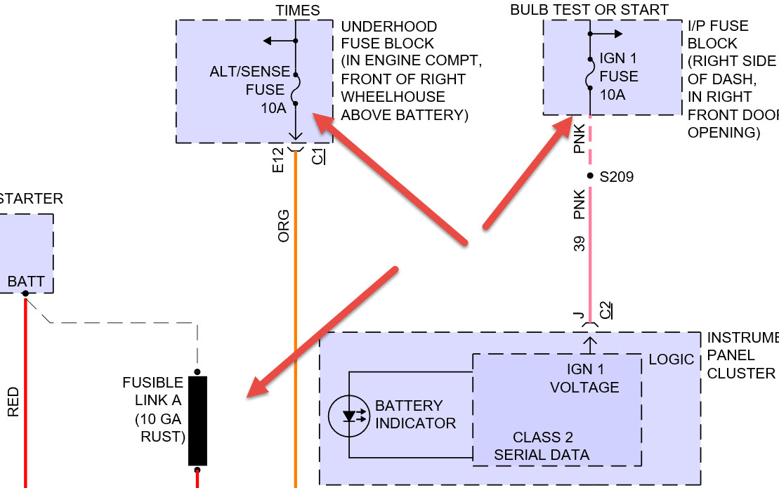

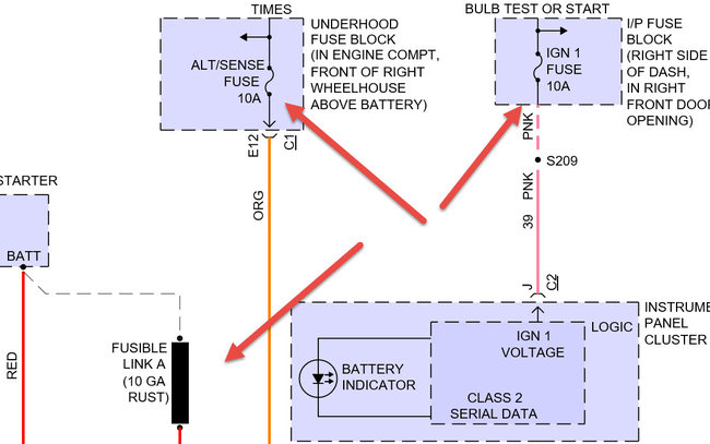

if the BCM was not programmed to your car that may be the problem dealers have to do this. check battery for condition including load test most places do for free. check fuses for corrosion if it has it clean off fuse and use dielectric grease on contacts and check fusible link for a partial break. dielectric grease can be at auto parts on counter for around $2.00.
