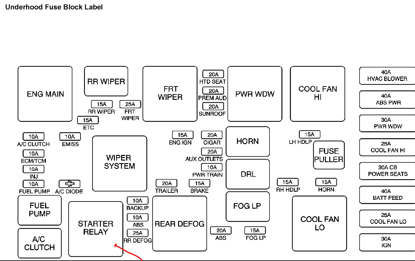

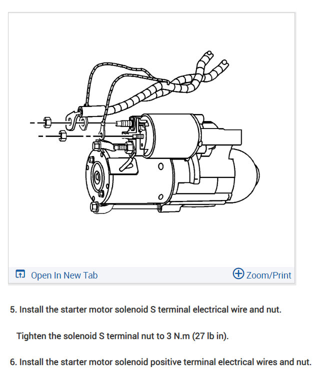

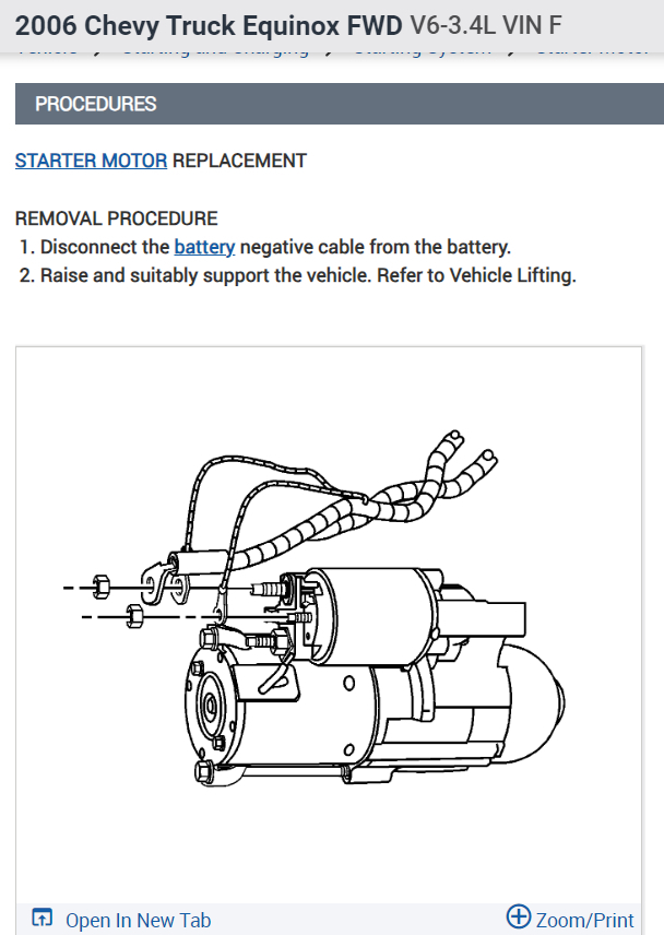

This sounds like the starter control relay or starter motor is bad. Let's begin with the starter relay because it is the easiest and cheapest. Here is the location of the relay and I have included a guide that can help us as well:
https://www.2carpros.com/articles/starter-not-working-repair

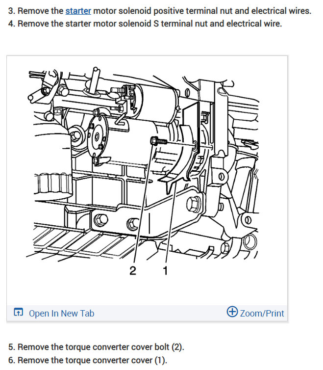

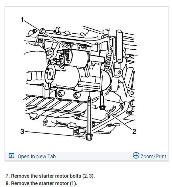

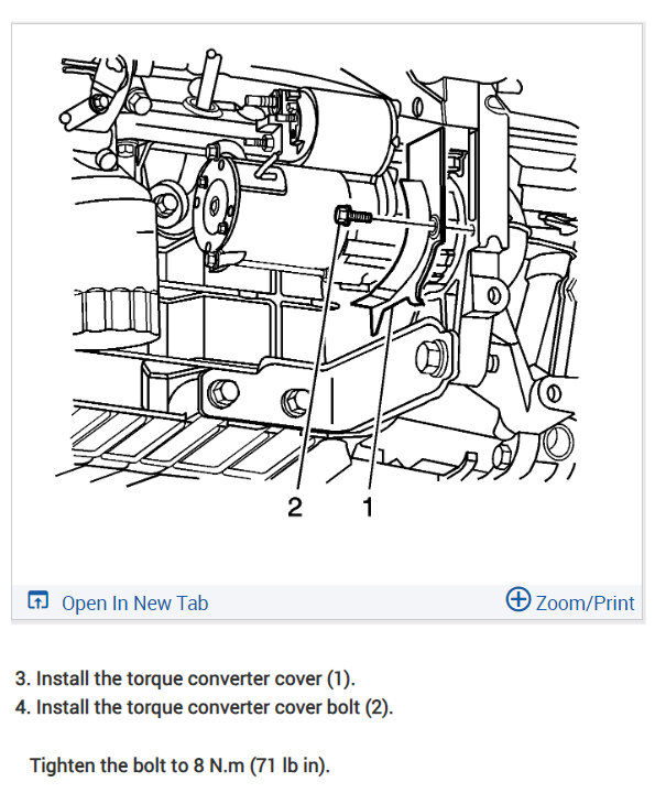

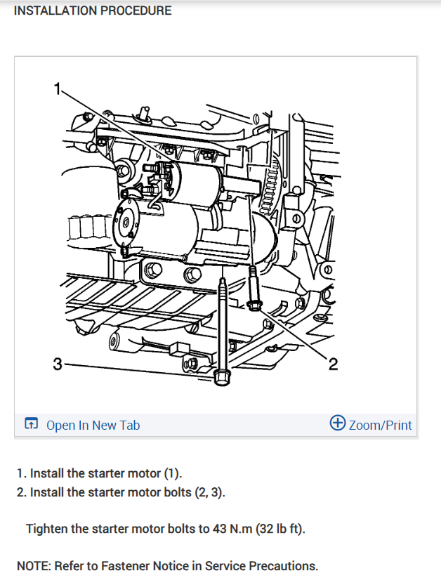

I would swap out the relay to see if the problem changes if not here is a generic guide on how to change the starter motor out with instructions below for your car:
Check out the images (below). Please upload pictures or videos of the problem so we can see what's going on.
