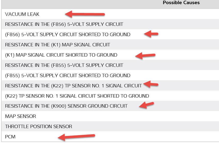

see picture for causes, but check for a vacuum leak. see if the gasket around MAP sensor is good and use choke spray to see if you can find a vacuum leak. then have a mechanic check for the rest like grounds/shorts or a bad PCM.

we do not show a schematic of lines. just look around on engine then check for air leaks like grommets on valve covers, spray along intake and around throttle body. it cold be one of the other things I have arrows pointed to as well though.
