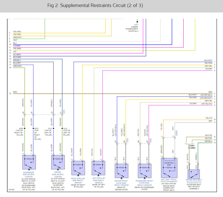

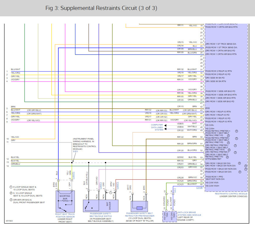

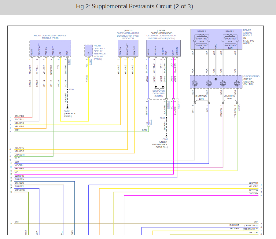

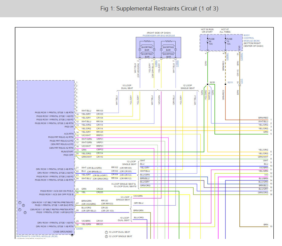

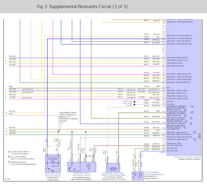

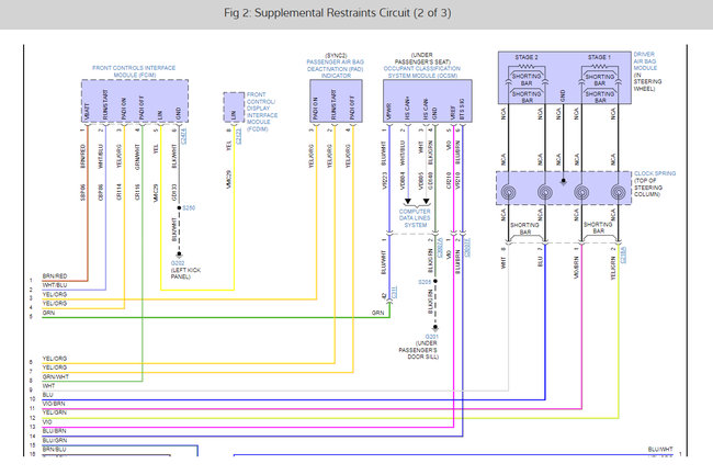

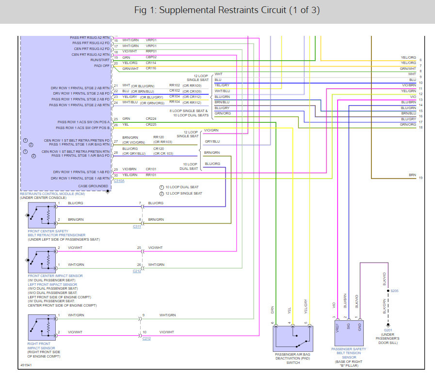

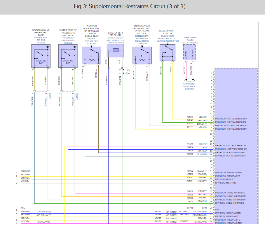

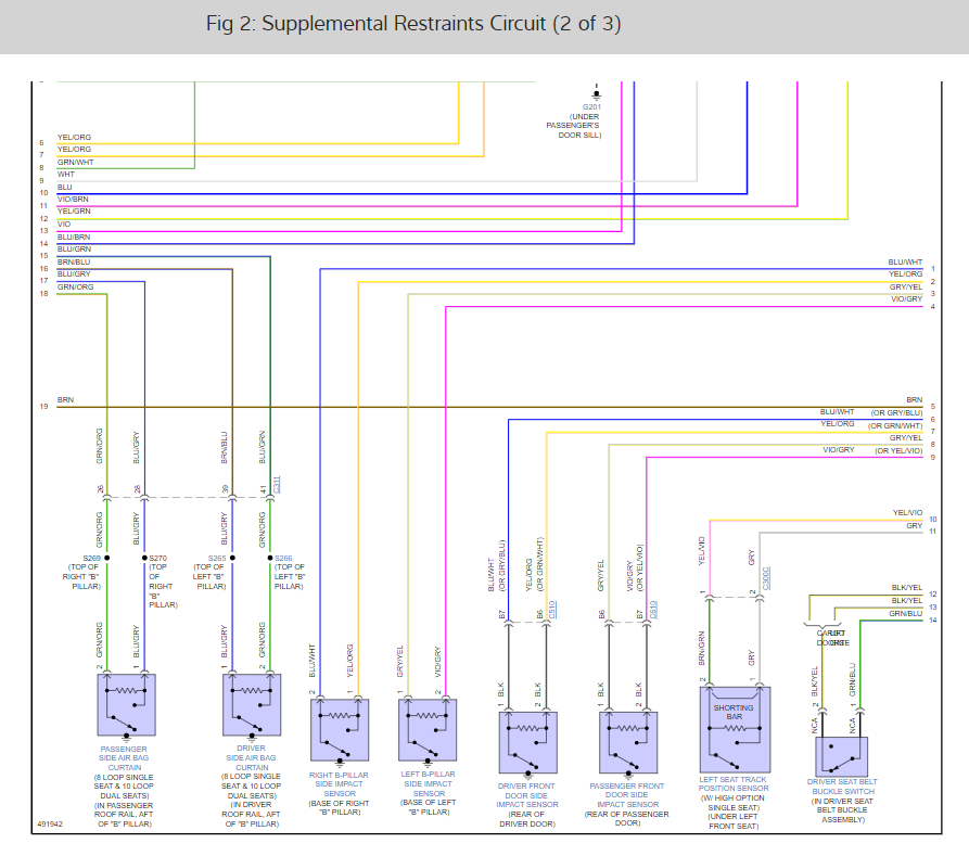

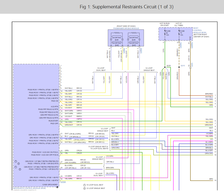

Each system is a little different, older systems let you swap parts and as long as the self-check goes okay the system would work, sometimes the sensor modules just go out for whatever reason. Here are the rest of the wiring diagrams so you can get a complete picture of how it works. Recheck the fuses and grounds and if okay replace the passenger seat module. it doesn't say which is which in my information. Check out the diagrams (below). Please let us know what you find. We are interested to see what it is.

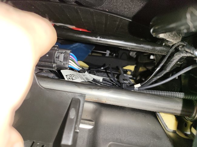

I got this pic but it's of the harness because the wires to the sensor pad are covered by hard plastic. I posted to three other transit forums in hopes someone else had this issue and came up with a fix or bypass but no luck so far. I cannot afford the $989.00 the dealership wants just for the seat cushion. With install and programming, it'll probably be around $1,400.00! The new cushion only has a 1-year warranty so if it fails again, I have to repeat the process again. I need my SRS system to be operable.
Jul 19, 2022 at 8:42 AM
Yep, it is a safety issue for sure. That does look like the module/sensor that needs to be replaced, have you tried ebay? Some people on this forum have had great luck with it.
