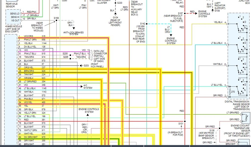

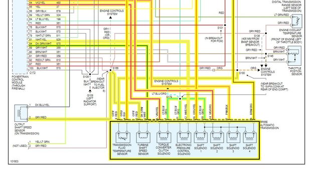

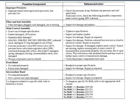

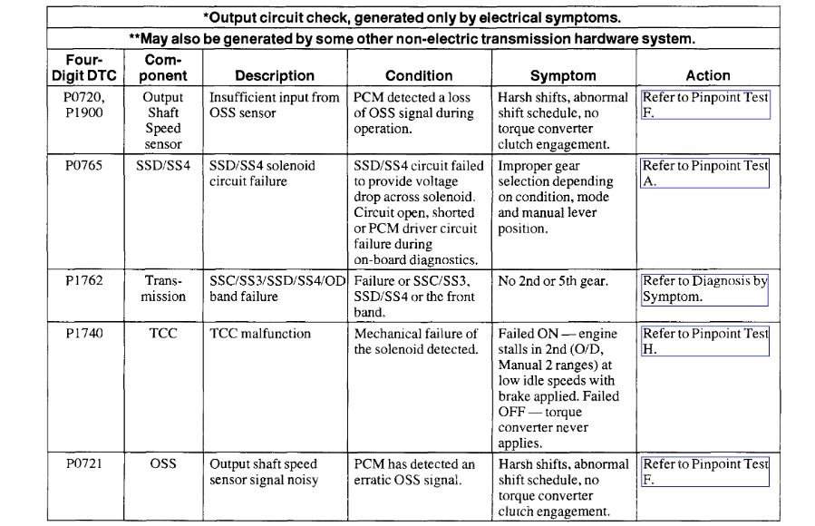

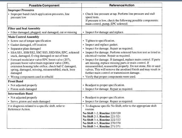

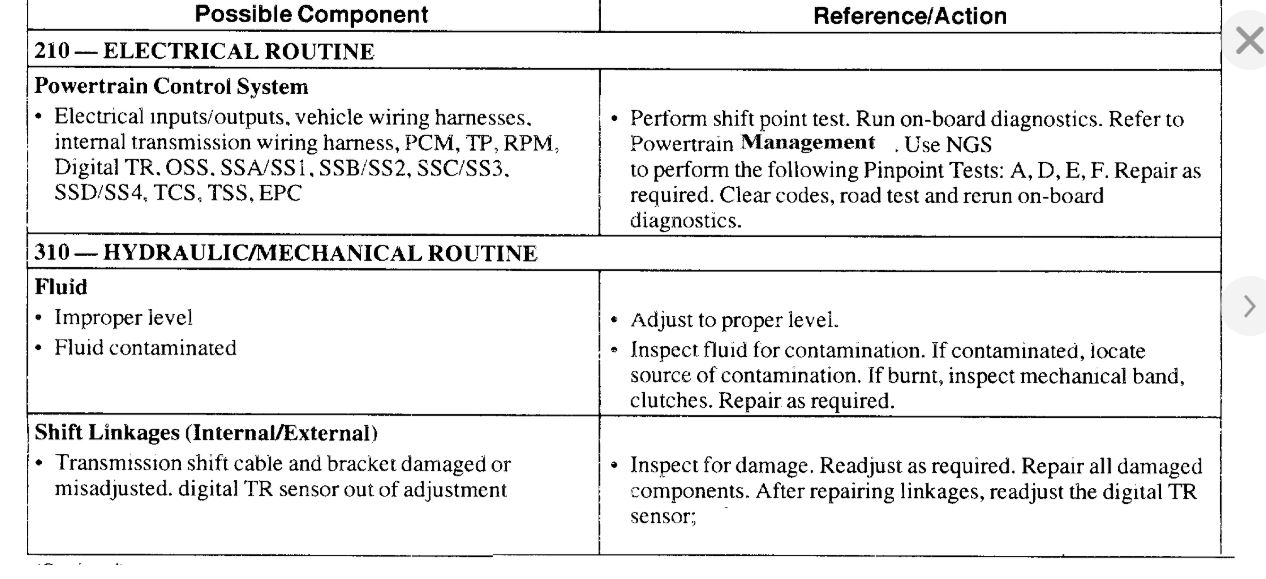

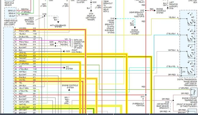

Good afternoon,
This could be either mechanical or electrical. The fact that the codes go inactive tells me it may be a bad connection at the harness going into the transmission. check that connector for oil in the connector. If there is, the internal harness is no good.
https://www.2carpros.com/articles/automatic-transmission-problems
I would also drop the pan and change the fluid and filter. While you are there, check all the connectors on the solenoids.
Do not dismiss the transmission needs replacing. That may be a real possibility.
