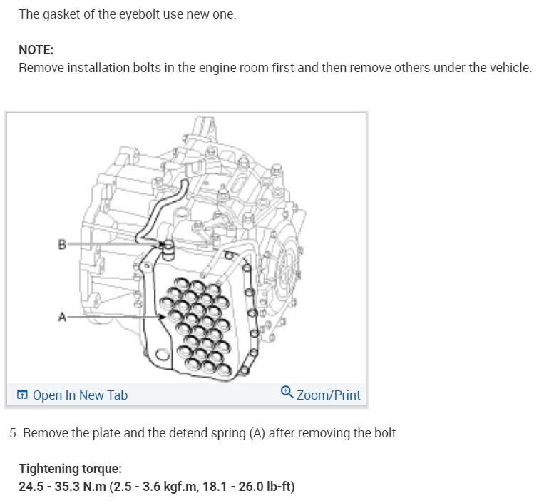

It sounds like you could have a turbine shaft sensor that is going out, lets run the codes to see if anything comes up.

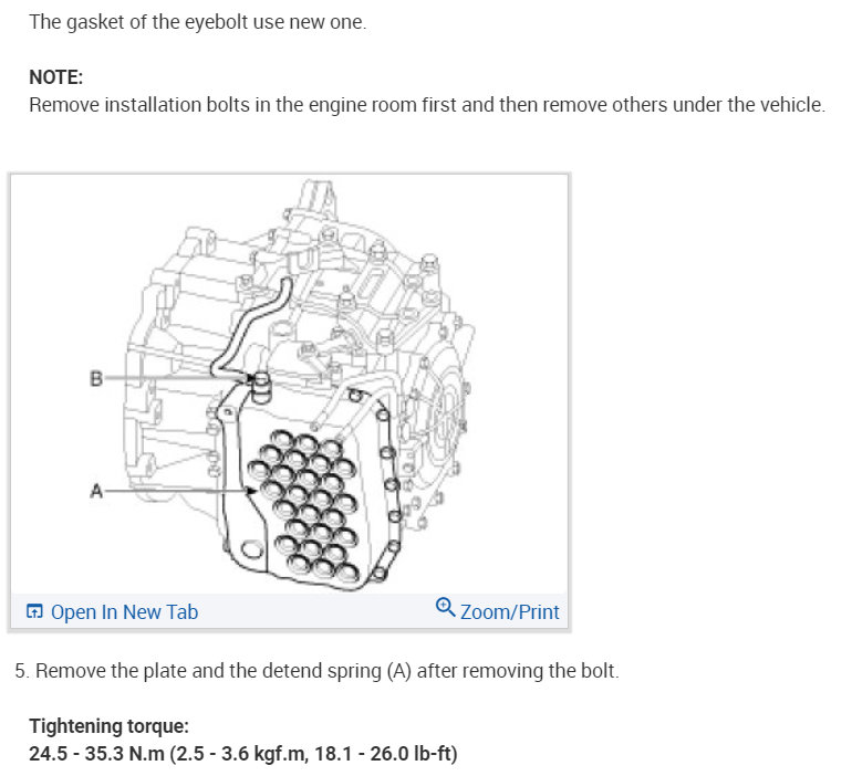

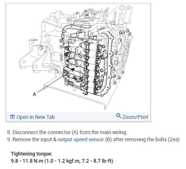

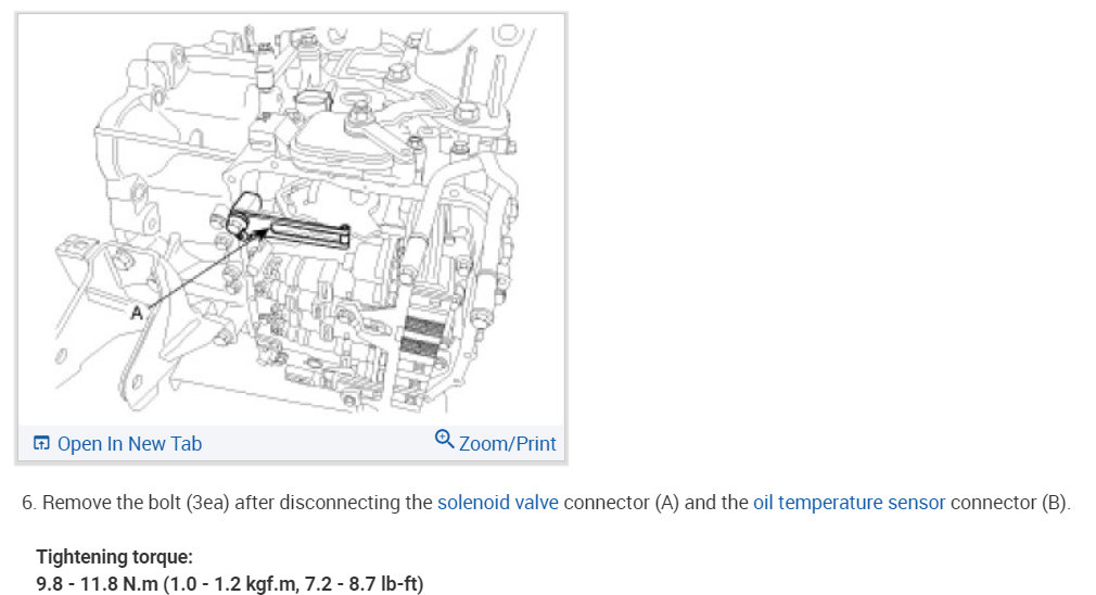

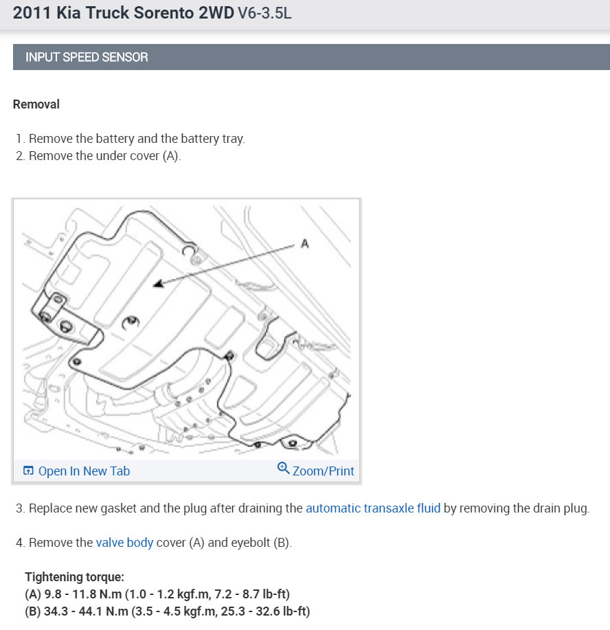

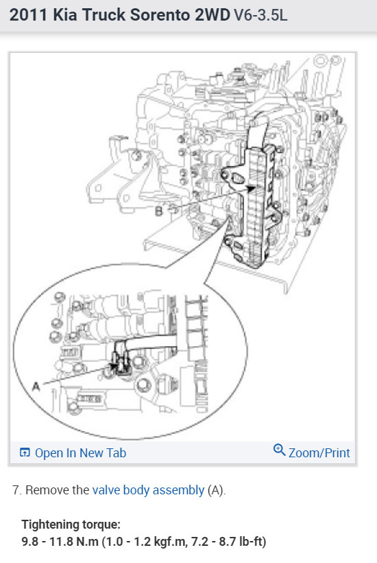

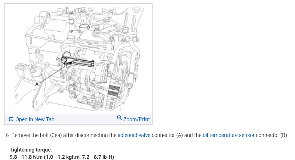

Here is the sensor location so you can check the electrical connector and replace the sensor if the codes comes up for it. Check out the diagrams (below). Please let us know what happens.
