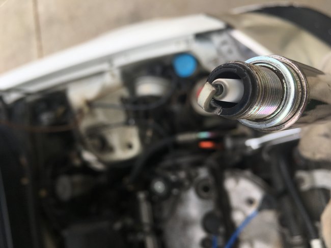

Spark plugs are the NGK ZFR5F-11. I just drove it around and got a cylinder 1 misfire code. I pulled the #1 plug out and took and picture. What do you think?
Apr 15, 2019 at 10:29 AM
Looks lean. What do the others look like? if they are darker I would check for vacuum leaks and if none are found replace the injector. Here are two guide to help:
