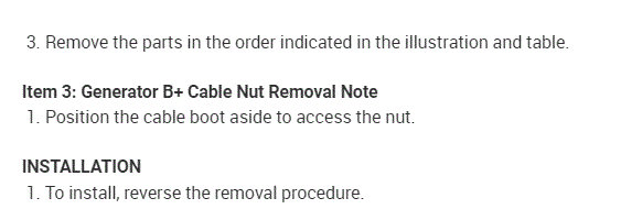

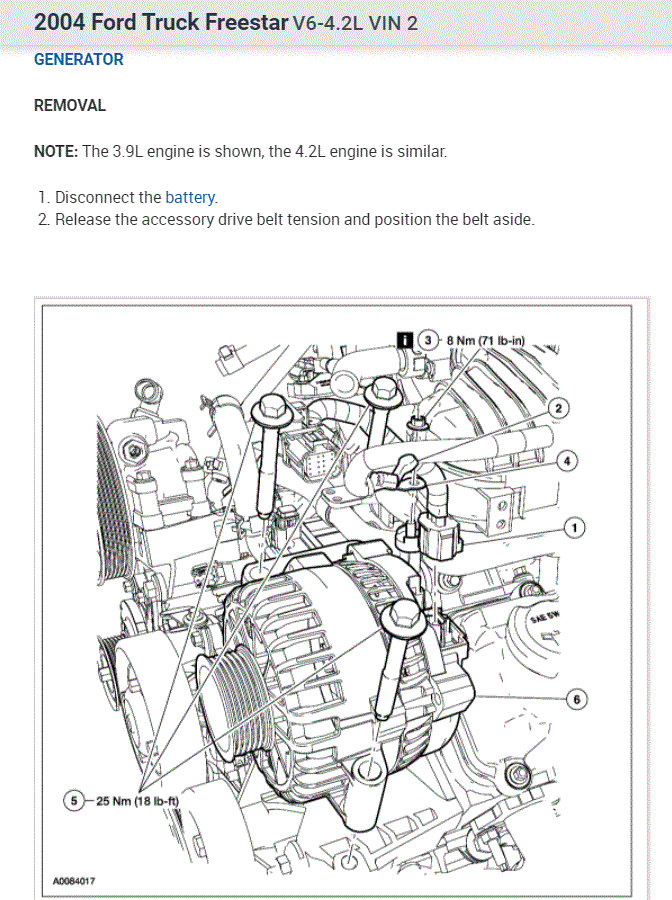

Overcharging can be damaging to the vehicle. On this vehicle, the voltage regulator is integral in the alternator. The alternator you got should be replaced.
If it is only two months old, it should still be under warranty.
Here is a link that explains how in general to replace one:
https://www.2carpros.com/articles/how-to-replace-an-alternator
The two pics below are specific to your vehicle.
Let me know if this takes care of the problem. Note: Your battery may have been damaged and should be checked by the store providing the alternator.
See pics below.
