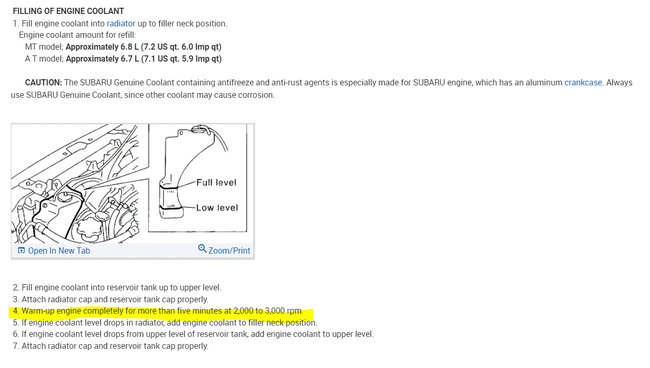

It sounds like you still have air in the system. Take a look at pic 1 below. Try the procedure indicated.
If that doesn't help, then I need you to check something. Allow the engine to cool and remove the radiator cap. Start the engine. Does the coolant shoot from the radiator? If not, leave the rad cap off and watch to see if it starts circulating when the engine warms up and if there are air bubbles in the coolant itself.
