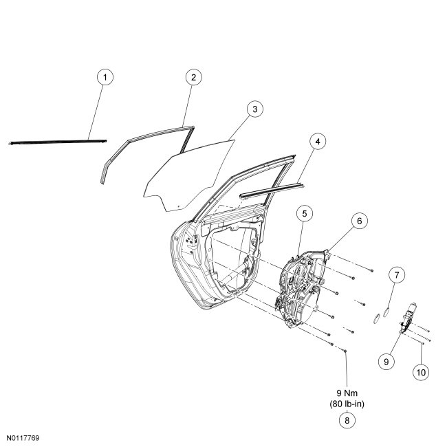

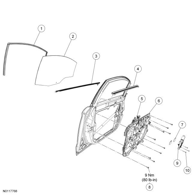

Hi and thanks for using 2CarPros.com. Since the noise seems to be coming from behind the door panel, chances are something has come loose in the door. What I suggest is to remove the panel and check for loose parts such as linkage, bolts, guides, regulator. I have attached an exploded view of both the front and rear doors. Picture 1 is the front.
