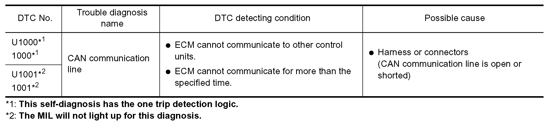

The codes I am currently getting are:
U1000 Can Comm Circuit
U1001 Can Comm Circuit
P0420 TW Catalyst Sys-1
P0430 TW catalyst Sys-B2

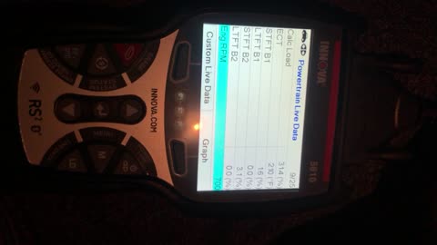

I have a scanner that can show live data of sensors if this is helpful.
