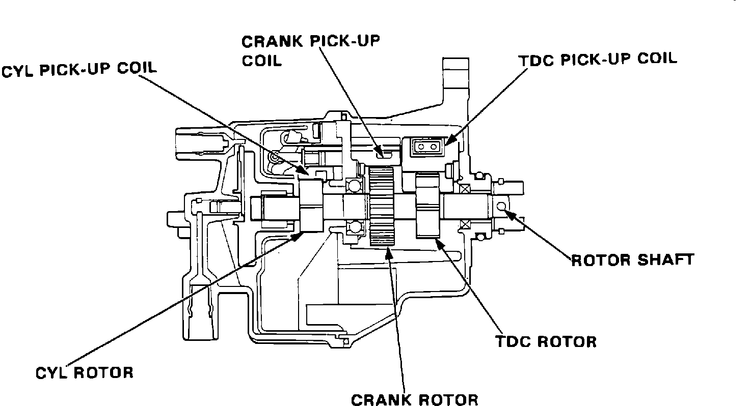

The crankshaft position sensor is located in the distributor and there is no additional sensor. The CKP sensor determines timing for Fuel Injection and ignition of each cylinder and also detects Engine speed. The TDC sensor determines Ignition Timing at start-up (cranking) and when crank angle is abnormal. The CYP Sensor detects the position of number one cylinder for sequential fuel injection to each cylinder. With that in mind, my first suspect would be a poor connection a bad connection, a weak crank pick up coil, or even dirt.
I attached a picture of the components in the distributor. Let me know if this helps. If you are looking for specific wiring diagrams, let me know. However, there isn't a schematic for a traditional crankshaft position sensor.
