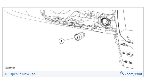

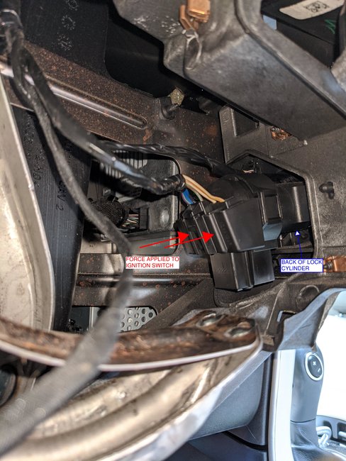

I have the vehicle listed above (SEL model) that seems to have issues starting when it is hot outside. I had the battery replaced less than a month ago thinking that was the issue. When that didn't work, I replaced the ignition switch, and the car started a few times but also didn't start a few times as well. Everything else turns on, but the engine doesn't turn over at all. It appeared to start very consistently when I reached my hand behind the panels and kept a consistent pressure on the ignition switch, keeping it pressed into the lock cylinder. When it is cooler outside, like this morning, the car starts up just fine. Thanks!
