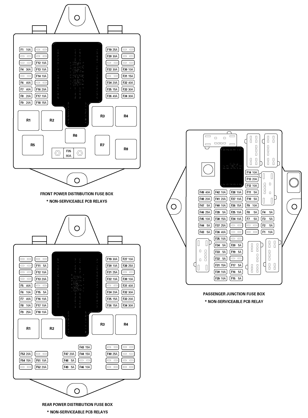

Have you tried a different pump relay? Your initial post doesn't mention it but an intermittent relay could cause the pump to run then not run on initial start.
Should be R6 in the front relay box.
