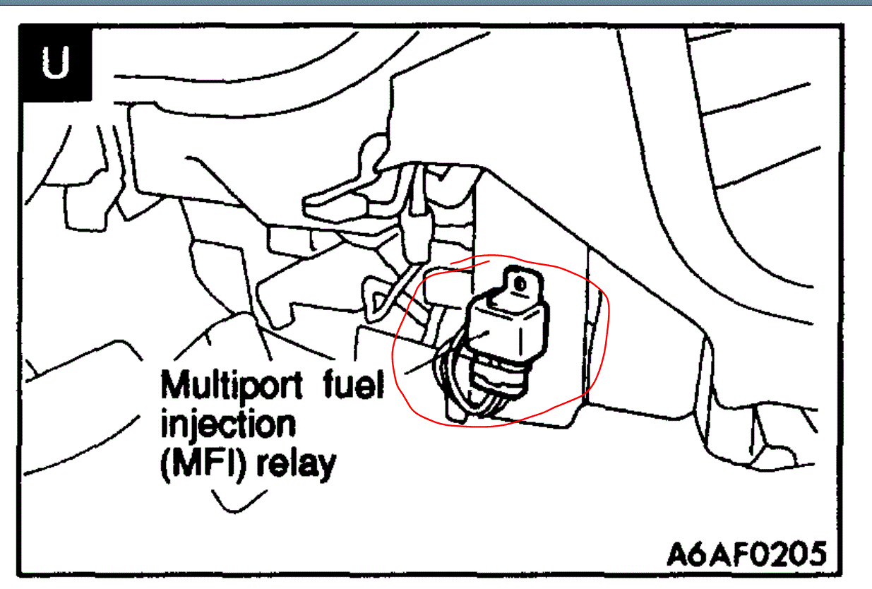

Have you checked the MFI relay? See pic below. The MFI relay is located under the console side panel to the left of the radio.
Oct 10, 2020 at 7:59 PM
