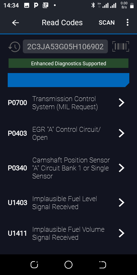

I was called to another garage to fix the car listed above 300c. The problems they noticed with the car was Hard or no start, no throttle response, battery and ESP light remaining on, most times immediate stalling after starting however, if it doesn't stall there's a rough idle throughout idling as a result an old PCM was replaced with a new one however problem still persisted.

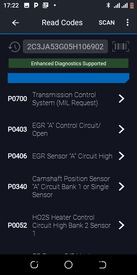

  I did all system scan and saw a P0340, P2167, P2166, P2115, P2116, p0603 and more module codes like C2202, U0168, U1414, B1A25, etc.

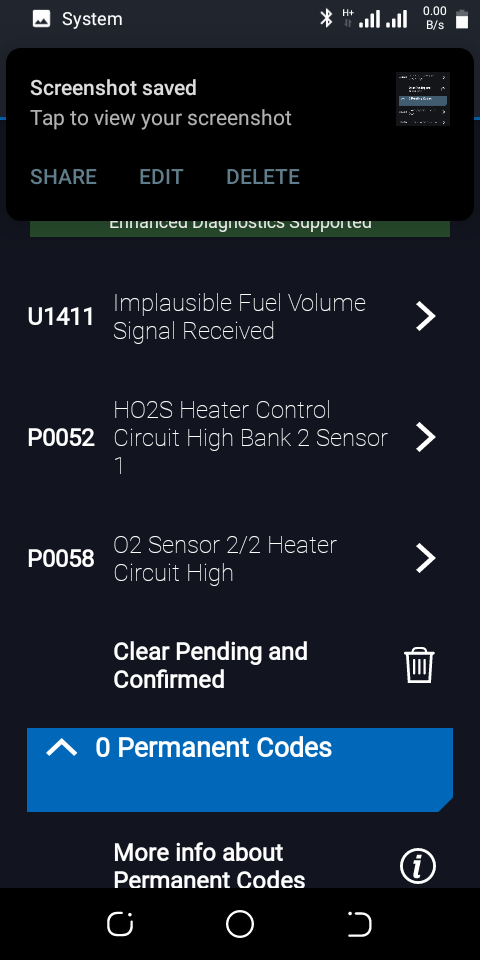

Only DTC scan I got p0403, p0403, p0340, p0052, p0058
Please, how can I fix these problems?

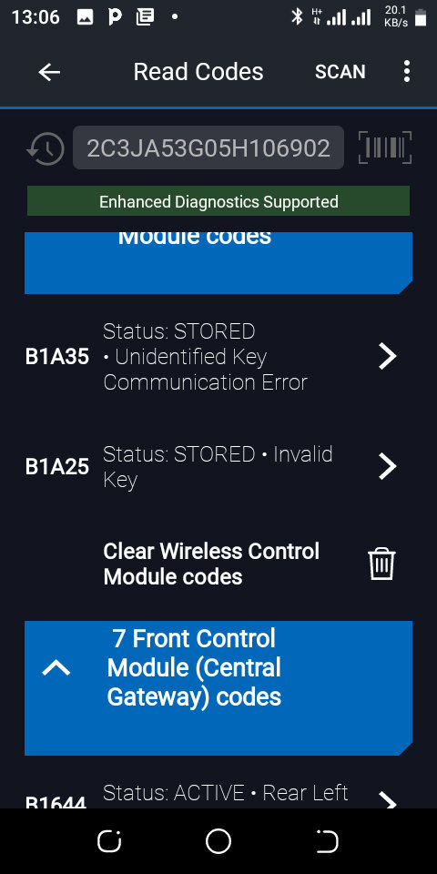

The B1A25 Invalid Key would prevent starting as well. I would put the old PCM back in it to begin with, at least that way the old PCM has all the correct data for the security system and key.

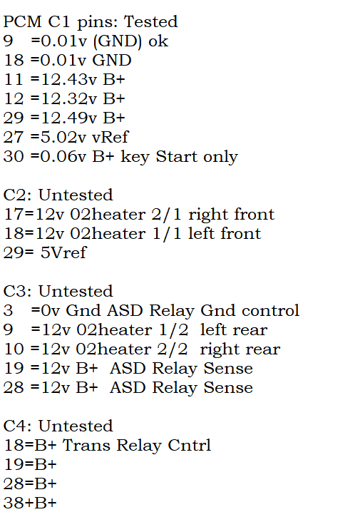

Start with seeing if there is a 5v reference at any 3-wire sensor, just to make sure its a full 5volts, Id check a few sensors, the MAP, CAM pos, Crank Pos, APP (accel pedal pos), some of the sensors setting codes use the same 5volt Ref.
And the check the Keep Alive Memory at the PCM, Ill post a diagram for it, but it comes from Fuse 23 15Amp in the engine compartment fuse block.

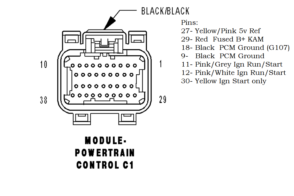

Below is the PCM connector C1 with the Keep Alive Memory feed, a few Ignition switch feeds and some PCM Grounds.

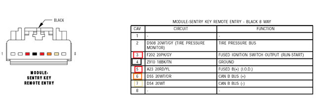

The Sentry Key entry module communicates on the CAN B bus to the Front Control Module which acts as a gateway to the CAN C bus which is what the PCM communicates on to the network. There are 2 different CAN networks so a resistance check at the DLC only checked the CAN C network not the CAN B. So, if there's a corroded series connector somewhere there might be communications problems between the Security system and PCM

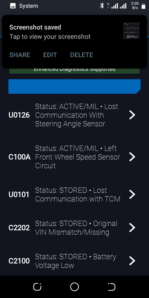

The 2nd diagram below is the code C2202 ORIGINAL VIN Mismatching/Missing.
So, the ABS module is also seeing the incorrect VIN number
U1414 IMPLAUSIBLE/MISSING ECU CONFIGURATION DATA
U0168 PCM lost comm w/ secu SKREEM
B1A25 INVALID KEY

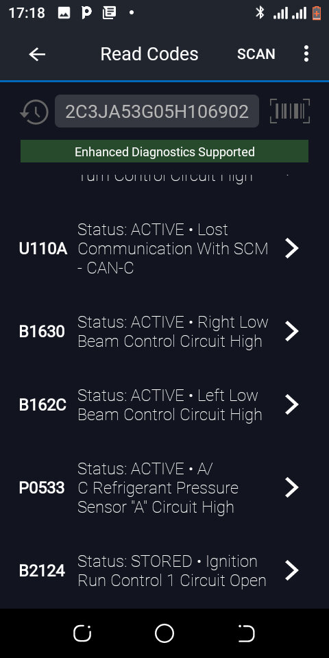

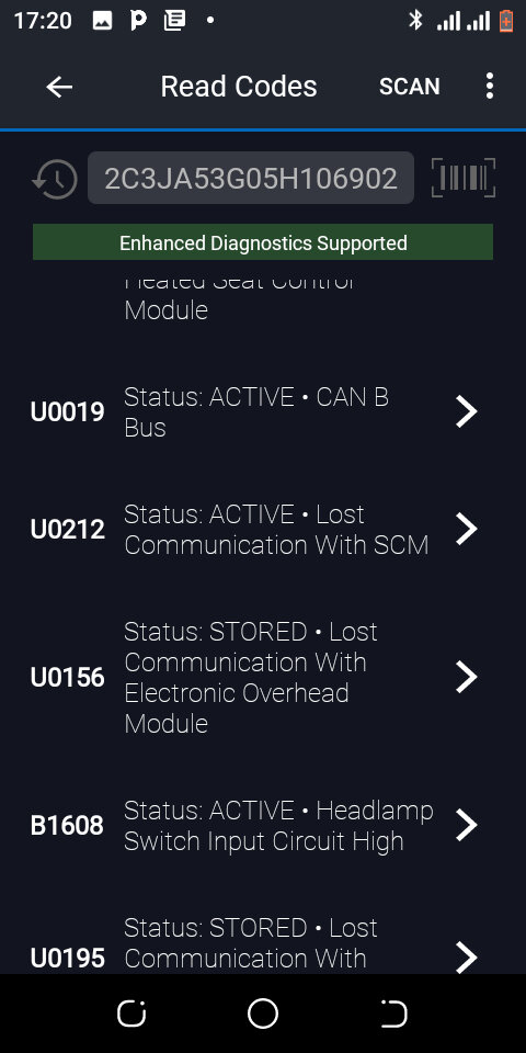

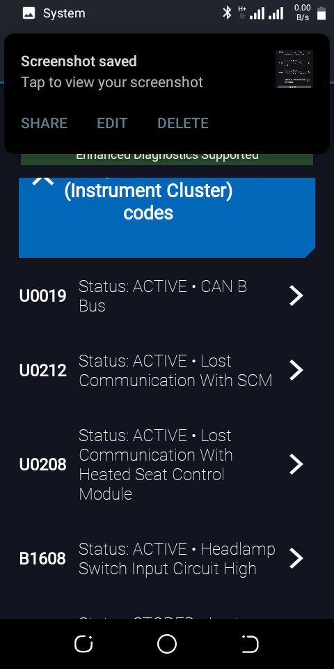

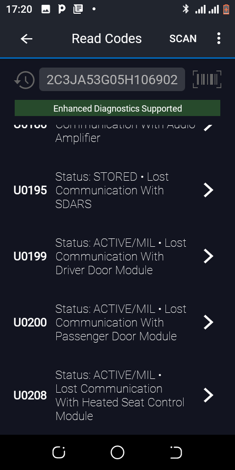

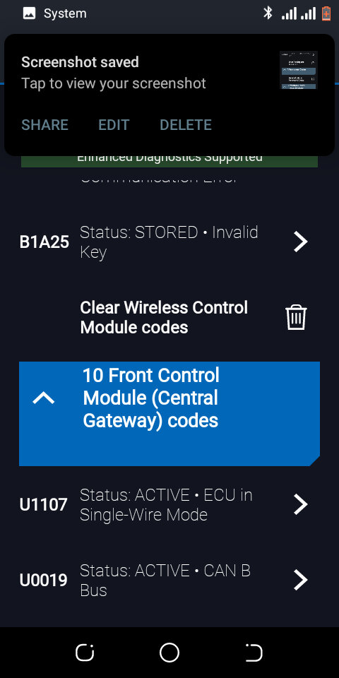

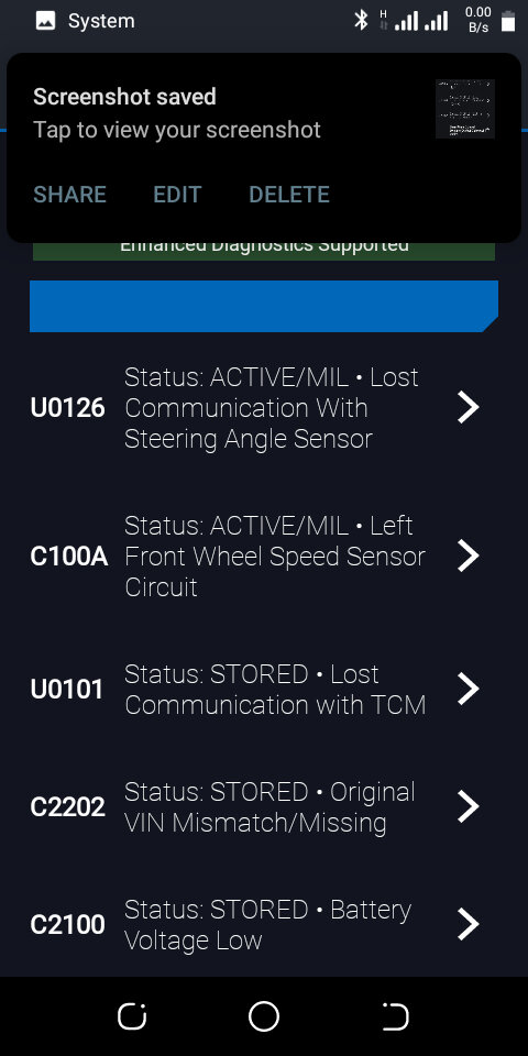

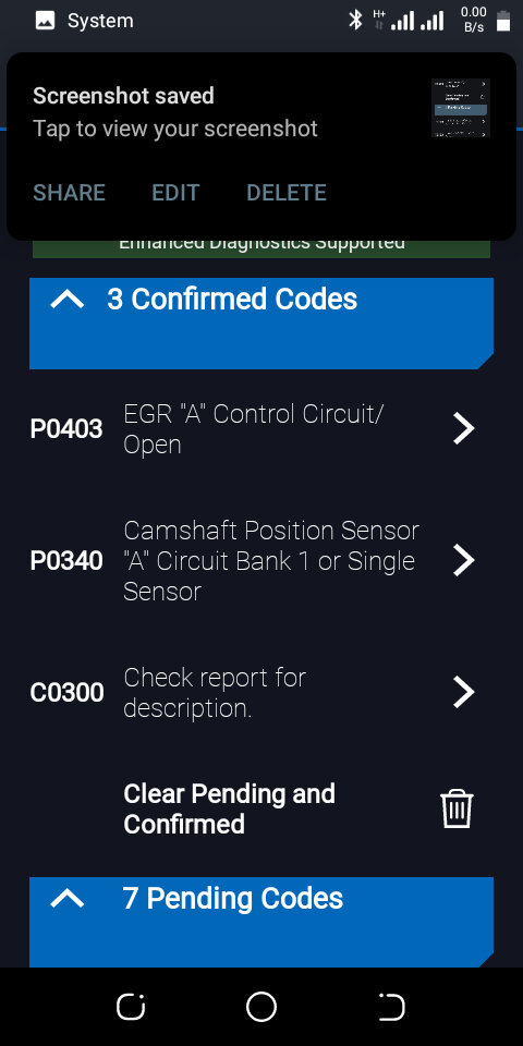

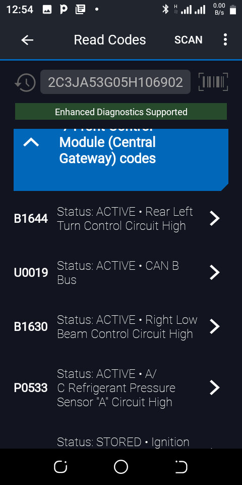

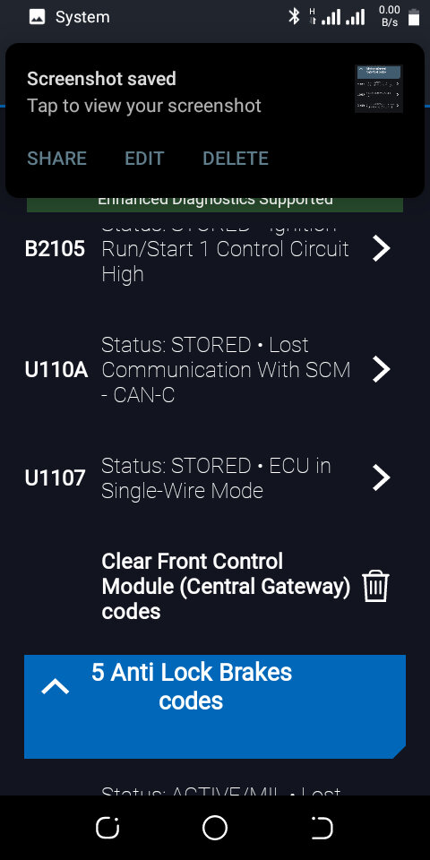

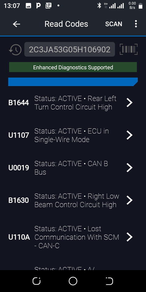

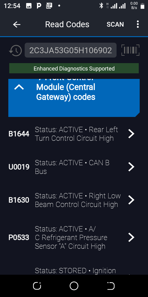

There are even more codes.
Aug 4, 2023 at 5:22 AM
DAVID DAVO ESSIEN
  • 152 POSTS

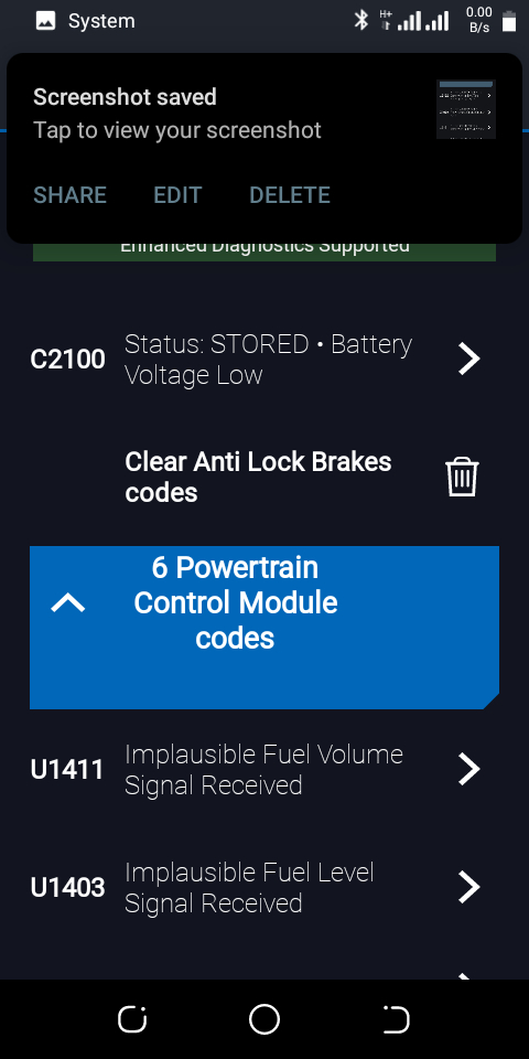

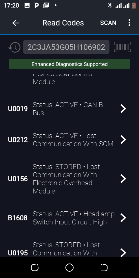

More codes still. Please, I'm sorry. It's not a 300c but it's a 300 limited instead. That's what I saw, I don't know the difference though.

They make a 300 that has a V8 Hemi in it, the "300" is just the name of the vehicle. I have a friend that has a 300 5.7Liter Hemi and it's a beast. And yes, you do have a ton of codes there. I'm going to write all these down and try to see if there is anything in common with them. This is going to be a wiring issue with a bulk connector possibly being corroded inside. But I want to have all these codes down in a folder for you. For scoping a network, I use a Pico scope, it's not a scan tool-based scope. But let me go over all these codes and see if there is a bulk connector that you can check. For now, that's what I would be doing, just start checking connectors that have bunches of wires, or module connectors that might have been exposed to water intrusion.

What does it say above Central Gateway? Which module is that?

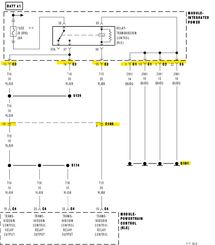

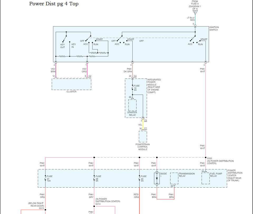

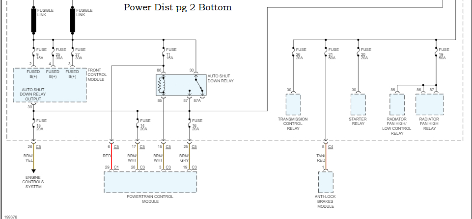

I will post the power diagrams for you, give me a minute.
Aug 4, 2023 at 10:18 AM
AL514
  • 5,465 POSTS

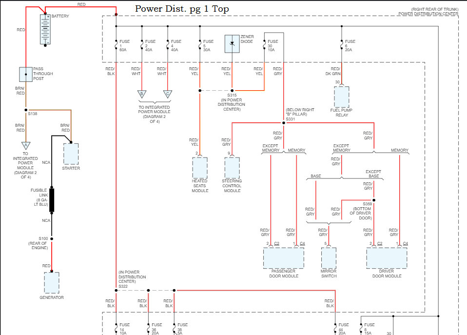

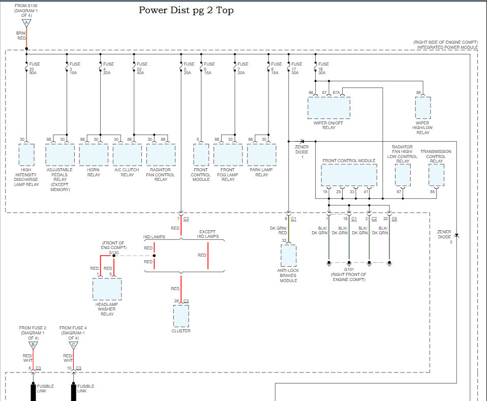

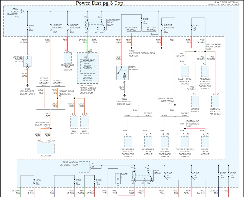

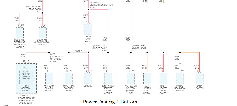

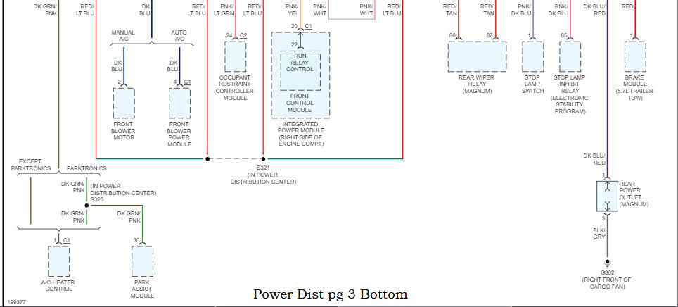

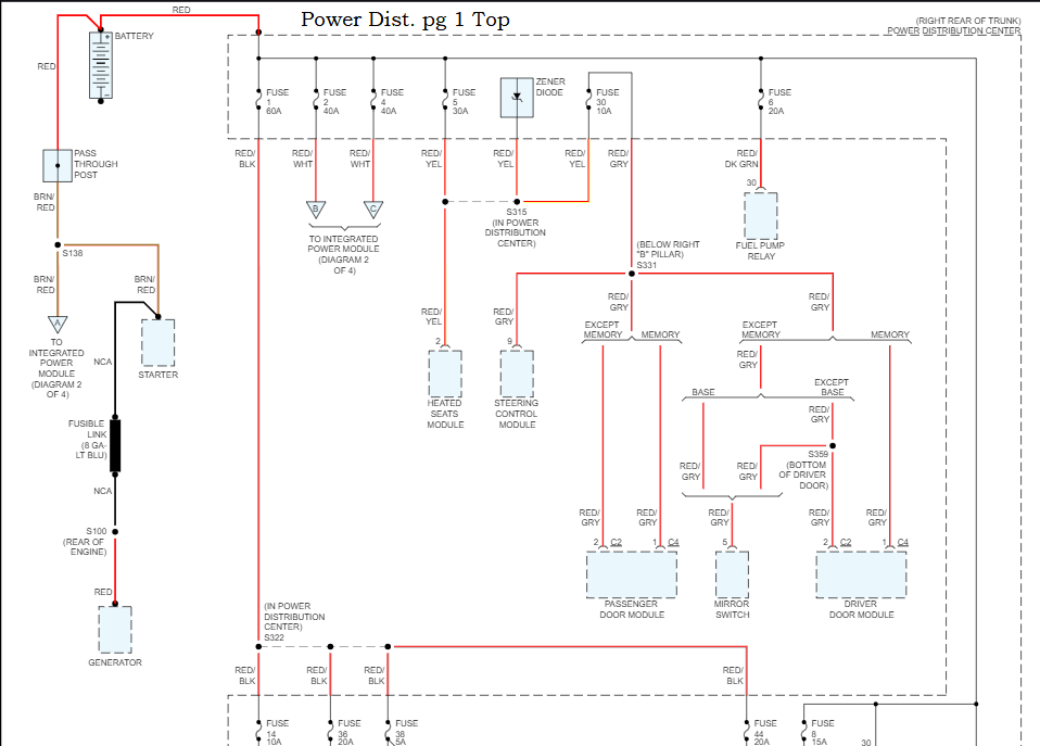

Here are all the Power Distribution diagrams, each page is labelled top and bottom, so if you print them out, you can put them together.
Do you want Ground too?
Aug 4, 2023 at 10:40 AM
DAVID DAVO ESSIEN
  • 152 POSTS
Thank you so much for the diagrams. Sorry, I didn't include this from the onset. The client told me that "when that problem first started that the security light was constantly on hence the car didn't start at all but one among the people that have been invited to fix the car told them to clean some ground which temporary made the security light to flash again and started the vehicle. However, the constant security light didn't stop. The car still has constant security light and a no start.
Most importantly please, can you also provide me with the faulty reason for this electrical video?
When testing the rear fuses with a test light connected to ground without the ignition turned to off position most fuses lit the test light. Nevertheless, fuse 31 precisely, it lit the test light though too but also actuated relay number 21. Thus, I pulled the relay out and checked the relay circuit and noticed this. What could be responsible for that; and could it be responsible for the flashing and steady security light? Please, is it normal that way or something is wrong?
Aug 4, 2023 at 5:10 PM
AL514
  • 5,465 POSTS

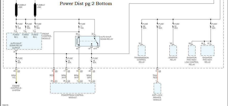

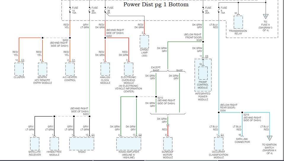

Almost all the fuses in the rear fuse panel are hot all the time, they are not coming from the ignition switch, I don't see any fuse 31 anywhere or any relays numbered 21. I'm also not sure what electrical video you're referring to.

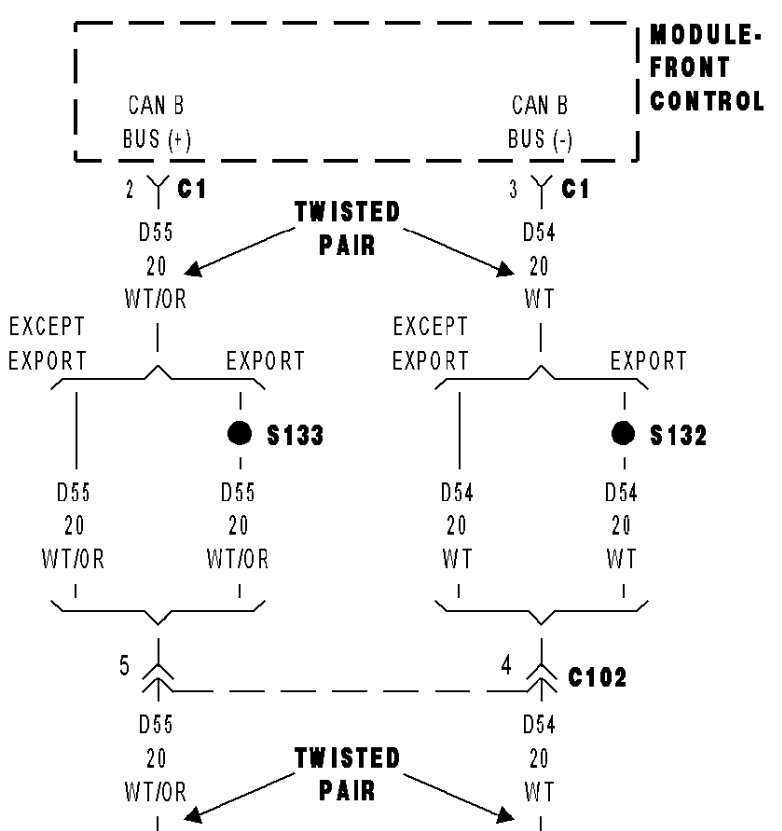

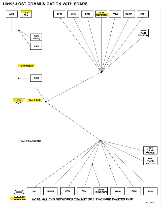

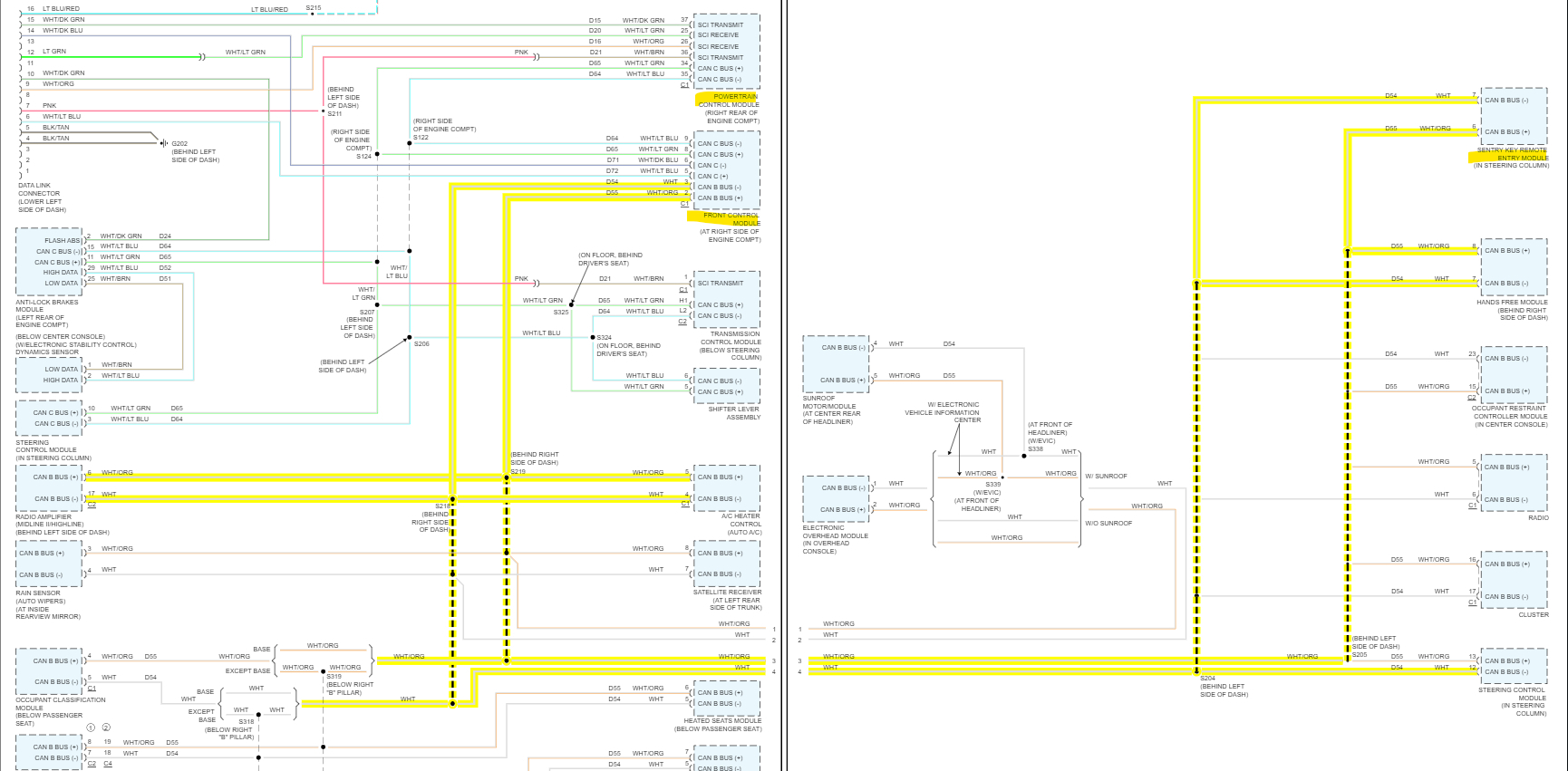

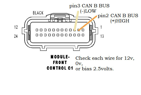

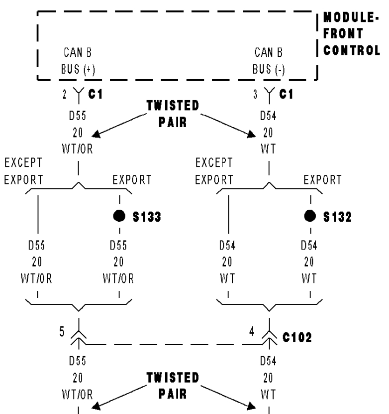

Looking over a lot of these codes, a bunch are related to the CAN B Bus network, and the Sentry Key Entry module, Instrument Cluster, Front Control module are all on that network, some of these codes have causes stated CAN B Bus shorted or open circuit. So, with the key on you should find a pair of the CAN B bus wires and see what the voltage reading is on them. CAN bus wires are always in a twisted pair. I'll find a module on that network that you can check the voltage level on each leg and see if either are shorted or if there is no signal at all.

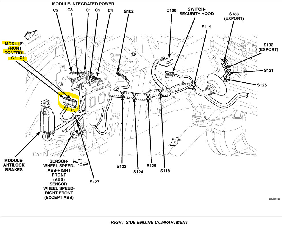

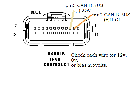

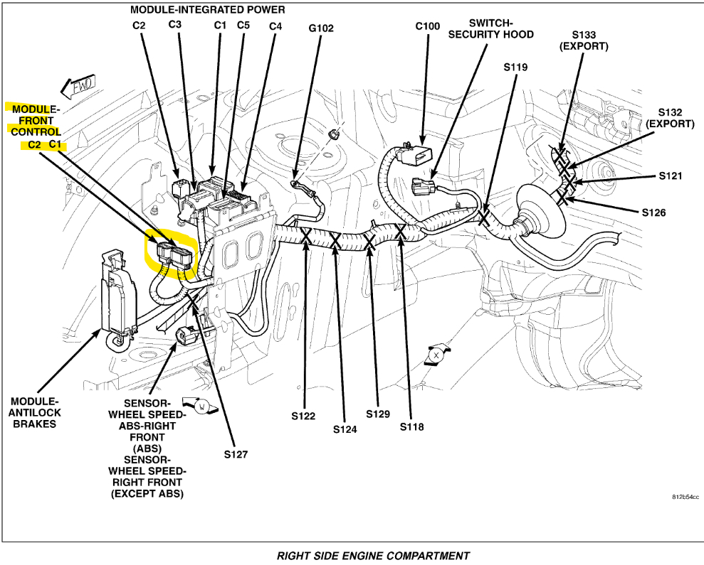

Here's the location of the Front Control Module and connector C1 pins 2 and 3 which are the CAN B Bus wires, they will be a twisted pair, check each one to ground separately and then check across both wires for a bias 2.5-volts. See what voltage is on either wire with the key on. Write it down.
Aug 4, 2023 at 5:52 PM
DAVID DAVO ESSIEN
  • 152 POSTS
Thank you so much for the wiring diagram. Please to start with, since I'm not too conversant with CAN-BUS work, to access this CAN-B network especially and other CAN-BUS. I'll need to first disassemble or loose the instrument cluster, radio, etc., right? I'll check that and get back to you. Please later you can also guide me on how to bypass the modules even though it doesn't fix the starting problem. But I'll check what you advice me to do first. Thank you for all the guide!
Aug 5, 2023 at 9:34 AM
AL514
  • 5,465 POSTS
No you don't need to disassemble anything, back probe the connector at the Front Control module in the diagrams I posted, the 2nd diagram is the engine compartment, the C1 connector is circled in yellow, you will need to back probe pins 2 and 3 so you can measure the voltage while the key is on, we need to see what the CAN B voltage level is. The Front Control Module is attached to the side of the Integrated Power module, everything is right there are the diagrams. Diagram 3 is the Front control module connector C1, pins 2 and 3 are the CAN B High and Low pins. Check each one first with your black multimeter lead on battery negative and the red lead on pin 2 first, then do the same for pin 3. Then finally check both pins with the meter leads on pins 2 and 3. We need to know if either of those pins is shorted to Ground, Power, or to each other.

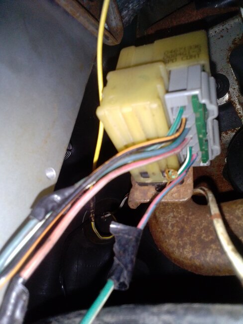

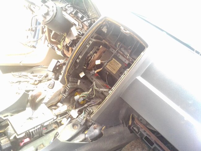

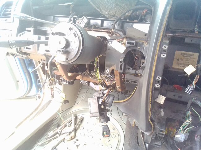

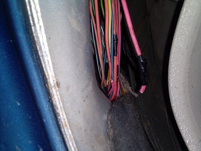

Thank you so much for the guide. Sorry, I didn't see the explanation earlier. Due to some factors - ranging from my phone. I was unable to access it as supposed. But I later fixed the phone's problem.
When I later went there, within the short period of time I pulled several things from the dashboard, radio, etc., remaining few bolts to completely pull it out. I tested the CAN at DTC with my multimeter set to continuity range I got a 061 ohms resistance.
In addition, I saw that the wires tightened to the metal body was really corroded hence I loosed and cleaned the surfaces. Some wires under instrument cluster was spliced and left to be naked that way. I fixed those ones too. Additionally, the power wire tightened to the engine compartment power distribution wire was pretty corroded and not properly tightened, I also corrected those.
Furthermore, I saw that the key transponder wasn't really tightened to the ignition assembly properly, one bolt was off causing it to wobble.

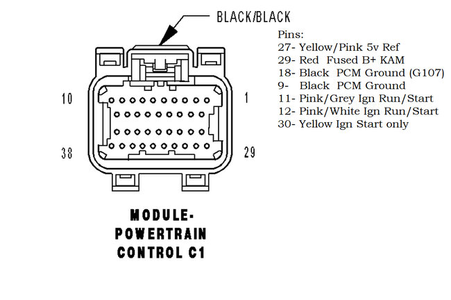

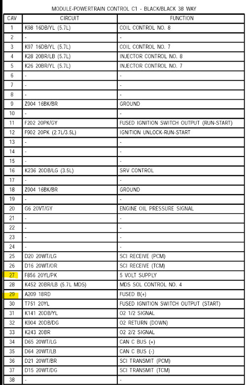

I tested the pins at the module power train control C1 black/black connector of the ECM and noticed that for pin 9 and 18 = 0.01v; pin 11, 12, and 29 =12.43, 12.32 and 12.49 volts; pin 30=0.06v ; pin 27 =5.02 volts. Those were the few things I checked.

The CAN B doesn't run to the Data Link Connector, only CAN C goes there. All those ECM pin readings are correct. But you're not checking the CAN B, you're only reading the terminating resistors of the CAN C network. Thats why I put the diagrams up for checking the pin 2 and 3 of the Front Control module, connector C1, not the ECM connector. But if you're finding a lot of corroded and loose wires in the dash then keep repairing them, Also if you have the Radio out already you can check the CAN B Bus there, that will be even easier because you have it out already, Ill post the Radio connector pinout, but you should see 2 twisted wires on the Radio connector white/ orange and white, those are the CAN B wires. Check the voltage levels there. If you're finding a lot of corroded wires, with green or white corrosion, this vehicle probably has a water intrusion issue.
Wires that are showing corrosion might need sections to be cut out and replaced. Corrosion from moisture will wick up inside in the wiring insulation, for any connectors that have corrosion you can try some terminal cleaner, Either Deoxit D5 or WD40 Terminal cleaner, auto parts stores carry it. But it has to be an electrical terminal cleaner.
It sounds like someone else has been into the area where you're finding loose connectors and bad wiring. Is this an auction car?

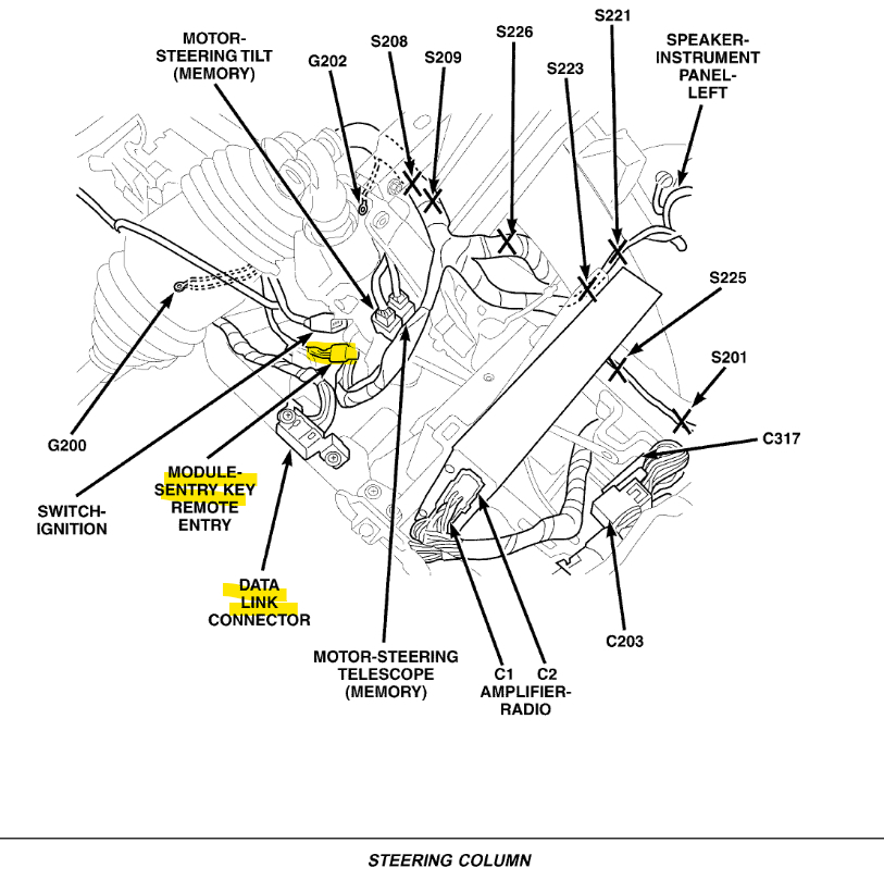

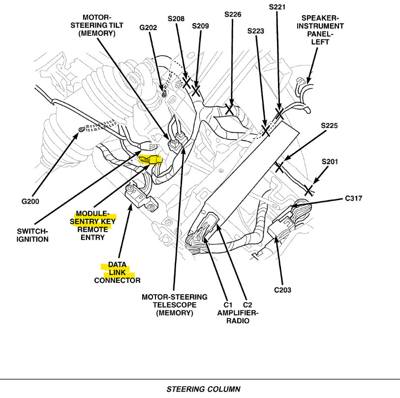

Since you're already into the dash, diagram 3 is the Steering Column and the Sentry Key module, check the connector for power and ground, then check the CAN B for a voltage signal since you have a security system issue. I'm wondering if there is a wiring issue to the Sentry, if its missing power or Ground, or CAN bus messages then the module is not receiving data or outputting data packets, it's not going to allow starting.

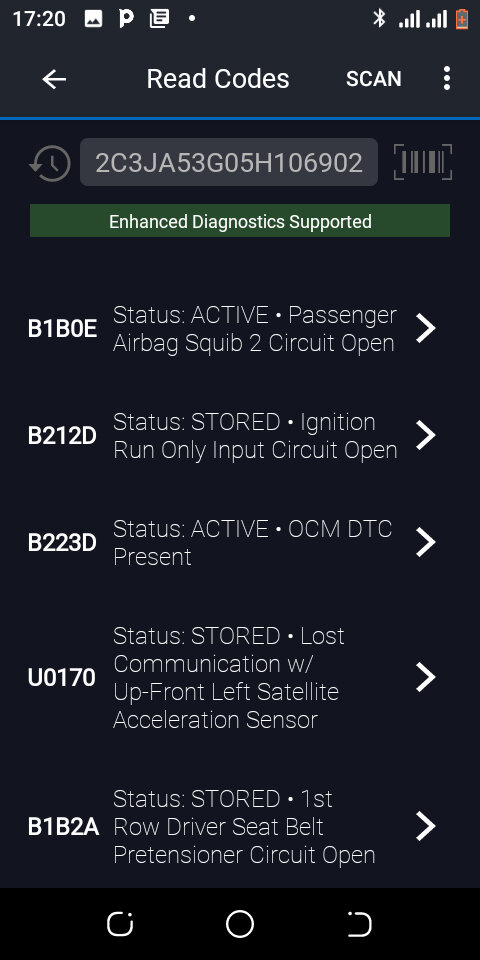

One other thing I just came across is this code B212D Ignition Run Only Input Circuit Open lead me to another code B2124 Ignition Run Control 1 Circuit Open, that code is for power to the Integrated Power Module. There is also this U0019 Status: Active CAN B Bus, so I think there are quite a few wiring problems going on here.
But clear all these codes out, and see what comes back at just key on, because some of these codes might be disabling components. U1107 ECU in Single-Wire mode.

In addition, please sir help me. I couldn't locate the Front Control Module C1 connector pin 2 and 3. Please help! Is it located on the driver's side or in the engine compartment?
Please, I'll need your assistance with how I can check for short to ground and power there using my multimeter or perhaps a test light.
Aside from here, please is there anywhere else you want me to check that CAN B network after I have tested this control module C1?
I'll also need the ground wiring. Looking forward to hearing from you.

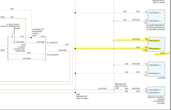

I just posted a bunch of information, refresh this page and look at my last post, you can check the CAN B at the Radio connector.

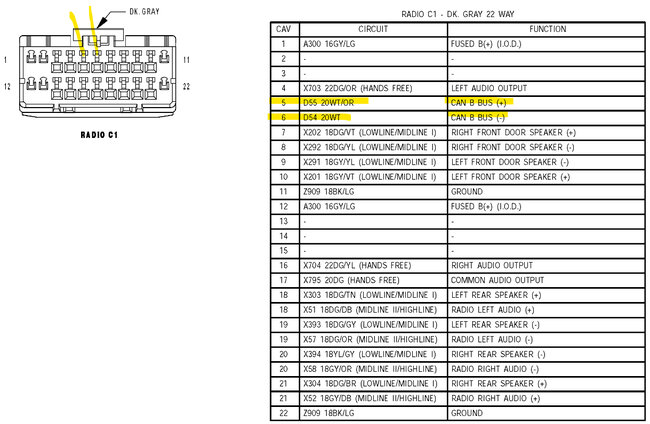

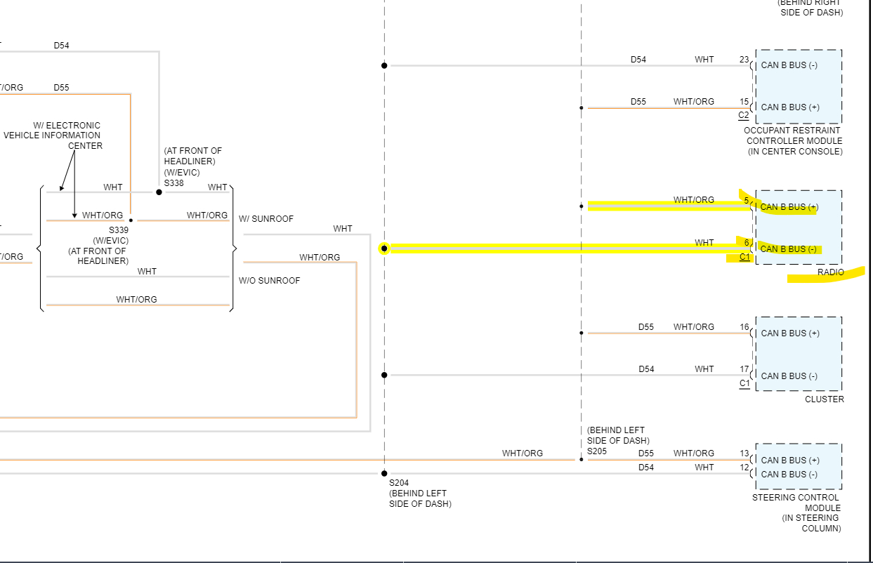

Thank you for uploading these additional diagrams. What should I be testing for at D55 and D54 in the radio? The module sentry key remote entry in the diagram where's it located in the car? What should I be testing for, please?
Aug 6, 2023 at 2:21 PM
DAVID DAVO ESSIEN
  • 152 POSTS
I saw the radio connector and will be able to locate it again. Please checking the CAN B at the radio connector does it still require locating and testing the control module C1 connector pin 2 and 3? I saw something that looked like the antilock brakes' module under the driver side steering but still couldn't locate the C1 24 pin front control module to proceed with the test. Can you also please give me a guide on how to locate this wire faster?
Aug 6, 2023 at 2:41 PM
AL514
  • 5,465 POSTS

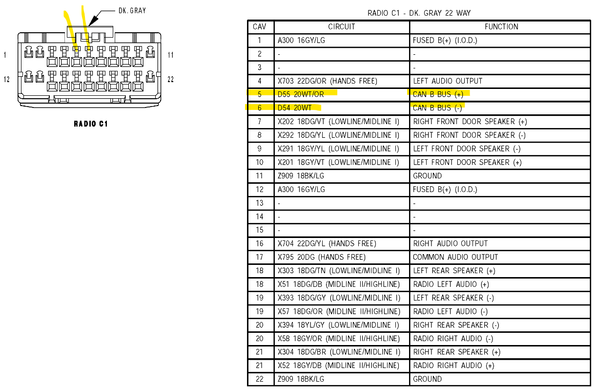

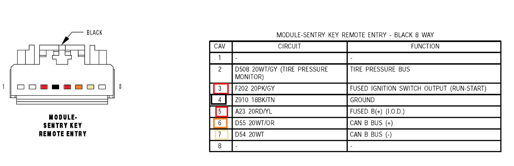

First checking the Radio, test 1-
pin 5 (D55) meter lead 1 and the other to a Ground, Key On
CAN B BUS + should be 2.5 volts to 3.0 volts So you will typically read the average of the those two voltages=2.8volts.
pin 6 (D54) CAN B BUS - should be 2.4 volts to 2.0 volts-again the average will be 2.2volts. Start with that. If you read 0 volts or 12 volts or something else odd, then we know there is an issue. But all the bad wires you're finding under the dash, it sounds like you'll be going through a lot of checks.
Then the Sentry Key Module is on the Steering Column, in the diagram see where the Data Link Connector is, the module looks to be located just behind that. Look for the connector according to the wire colors, it's a 6-wire connector, I've marked the powers and ground as well as the 2 CAN B wires, again look for the 2 twisted wires, the canbus wires are always a twisted pair.

We just first need to know if the CAN B circuits are active or not, some of the codes you are getting now are different than before, so if this vehicle is from another shop, they set those codes trying to figure out what is wrong here. This P0888 code is a TCM Relay code for less than 3 volts going to the PCM.

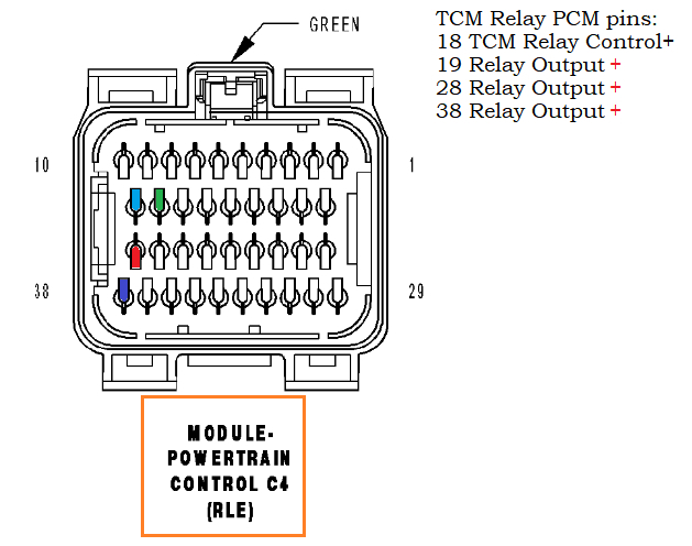

The TCM and PCM are one unit here. PCM C4 pins 18,19, 28,38 all should have power key on.

Alright, let's get back to this tomorrow, I'm not sure if you still have the old PCM, but these old codes you originally posted look like they tried messing with a new PCM and it didn't work. Here's some testing you can do tomorrow if you want, it's just checking powers to the PCM connectors C2-C4.
I forgot to add C4 pins 12,13,14 are all Grounds.

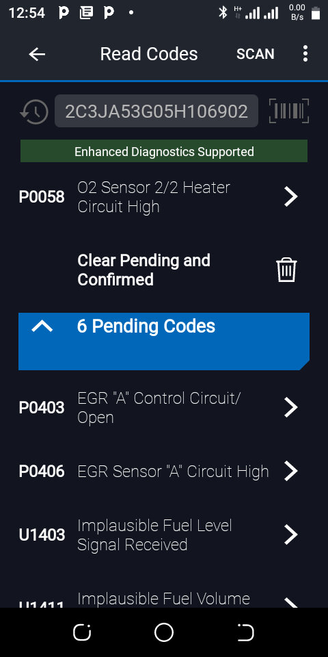

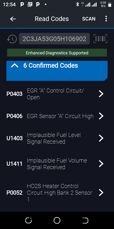

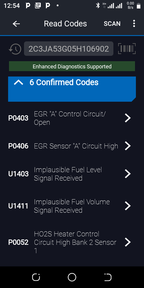

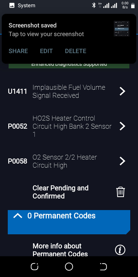

These codes were what I first got for all system scan: https://drive.google.com/file/d/1mB7PIC2YigX7XbMbI2_vaP4C96Tr3JIE/view?usp=drivesdk
Common dash lights I got: https://drive.google.com/file/d/1m5EJkLTfH5E9kO6KtW5gL6PiJStvKnxF/view?usp=drivesdk.
After starting and clearing codes I got these codes
https://drive.google.com/file/d/1m9GBiwJjENyXw3EfPMocPf5vOGghQdkK/view?usp=drivesdk
After repeated clearing of codes I got these codes:https://drive.google.com/file/d/1m9ngWC3EoUbjyAvWUkL0DzRi5BVlXkWu/view?usp=drivesdk
P0406, U1403 and U1411 for confirmed and pending codes on only scanning.

When checking the 22 pins radio connector, with my multimeter black lead connected to ground then the other red lead connected to pin 1 when ignition was switched to On position, I got 12.45v . When the red lead was moved from pin 1 to pin 5, I got a 0.00v. Next, to pin 6 I got 0.92v . Finally on pin 12, I got 12.45v.
Additionally, moving my multimeter range to continuity setting, with the black lead connected to ground and the red lead to pin 5,11, and 22, there was a continuity. When the black lead of the multimeter was still connected to battery negative and the red lead to pin 5, I think they should be no continuity from the wiring diagram you sent.
On the other hand, when the multimeter black lead was moved from Battery negative to positive, and the red lead to pin 1,6,12 they were a continuity. When the black lead of the multimeter was still connected to battery positive and the red lead to pin 6, I think they should be no continuity from the wiring diagram you sent. If I'm wrong please correct me.
Furthermore, with ignition On, multimeter black lead connected to CAN B- and the red lead connected to CAN B+, I got 0.29v. Next, multimeter black lead connected to pin 1 and red lead connected to pin 5, I got 12.35v. While the black lead still connected to pin 1 and the red lead connected to pin 6, I got 12.02v.

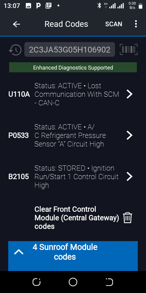

I have just seen the FCM front control module, you once sent that I said I can't locate it.
https://drive.google.com/file/d/1nZQtpE8DuGGQoeA4Lc9Iob-BBbRfzs0H/view?usp=drivesdk
That's the link above for the codes I got. Please should I proceed with the replacement of the TIPM? Should I tell the client to replace TIPM, that is, the FCM and IPM to fix the whole issues with the car permanently?
