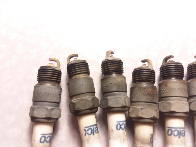

I still have the old plugs, I will take a picture of them and get a opinion on them. Thanks so far for the help.

So found my old plugs, checked coolant level in radiator and well it is way low. So I guess you are right I m burning coolant, cannot believe my brain did not come to that conclusion.

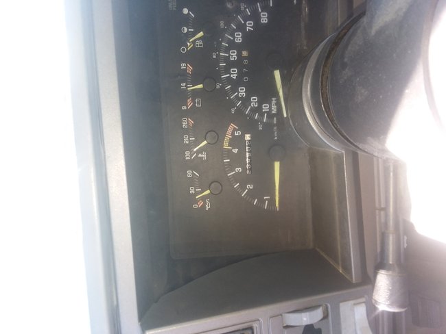

It does not over heat anymore after I did the water pump, I added a picture of oil pressure and temperature after a thirty minutes highway drive then at idle for some reference I suppose.
Aug 28, 2018 at 6:52 PM
Results are correct.
If it was an intake, you would have coolant in the oil but not burning it at all.
Aug 29, 2018 at 1:34 AM
