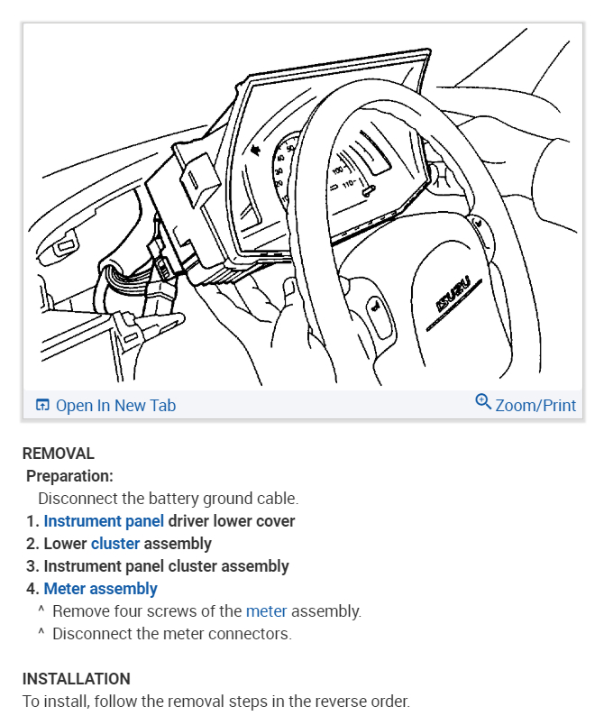

I have seen the instrument cluster short out causing these issues. I would find a used one and install it. Plus check the battery ground to the engine block and frame must be clean and tight. I have seen bad batteries cause this as well.
