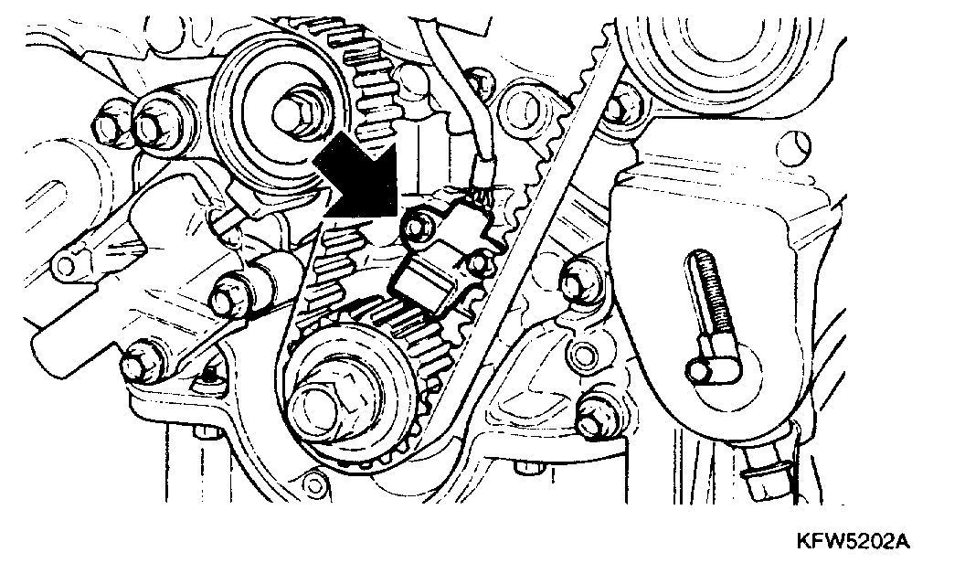

Vehicle Powertrain Management Sensors and Switches - Powertrain Management Sensors and Switches - Computers and Control Systems Crankshaft Position Sensor Testing and Inspection Component Tests and General Diagnostics
pic 1

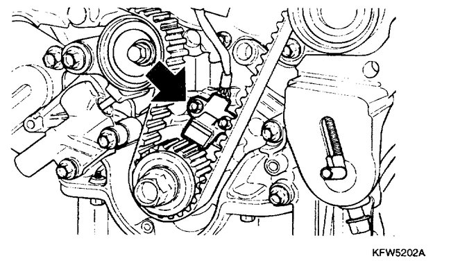

CRANKSHAFT POSITION SENSOR
The crankshaft position sensor is a Hall-effect sensor that senses the crank angle (piston position) of each cylinder and converts it into a pulse signal. Based on the input signal, the PCM computes the engine speed and controls the fuel injection timing and ignition timing.

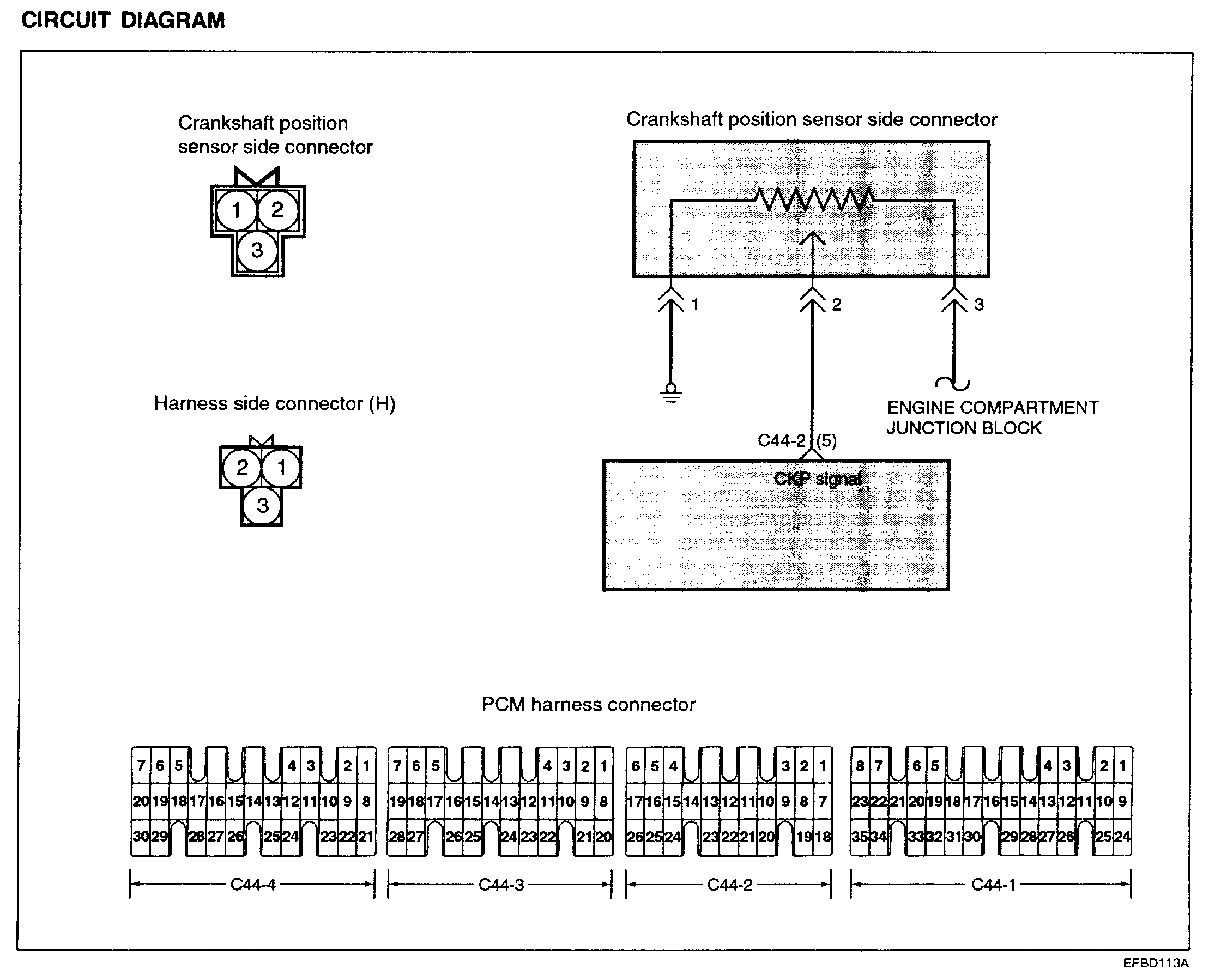

Circuit Diagram

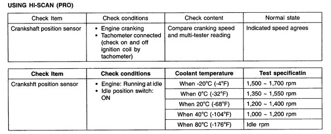

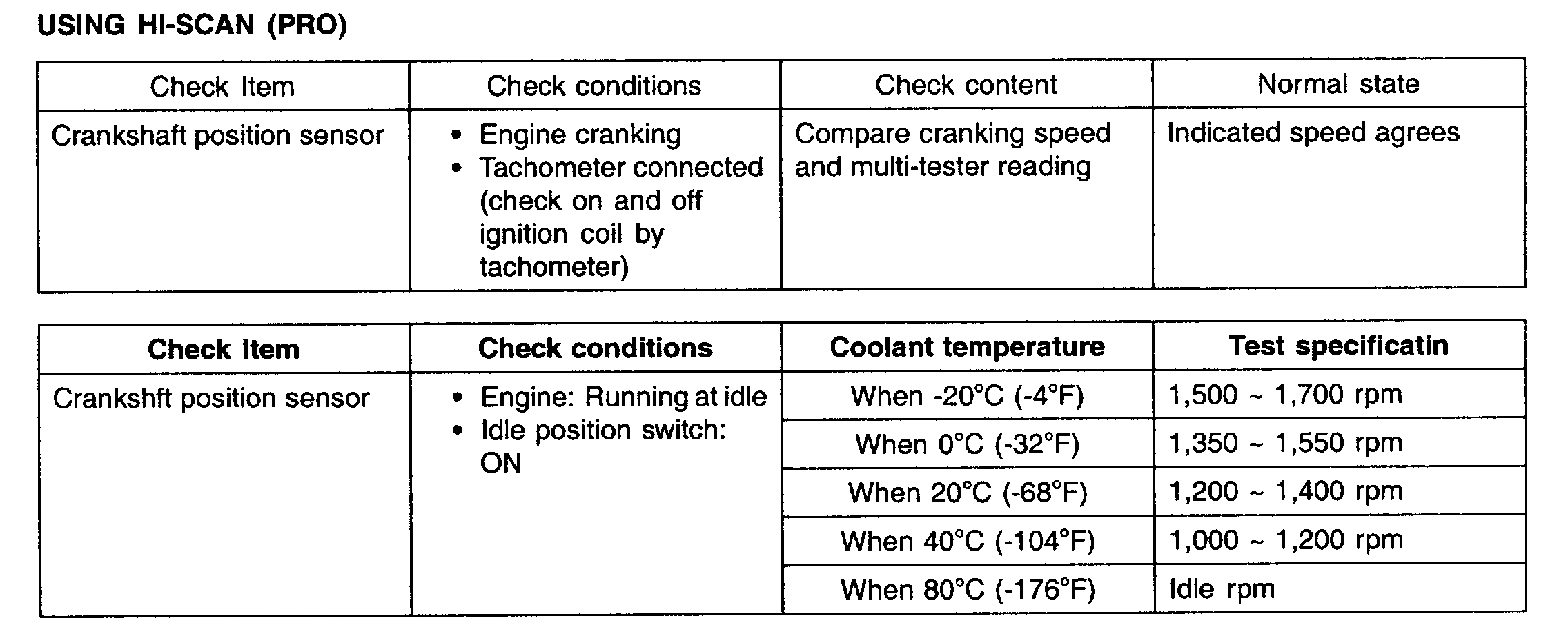

Using Hi-Scan

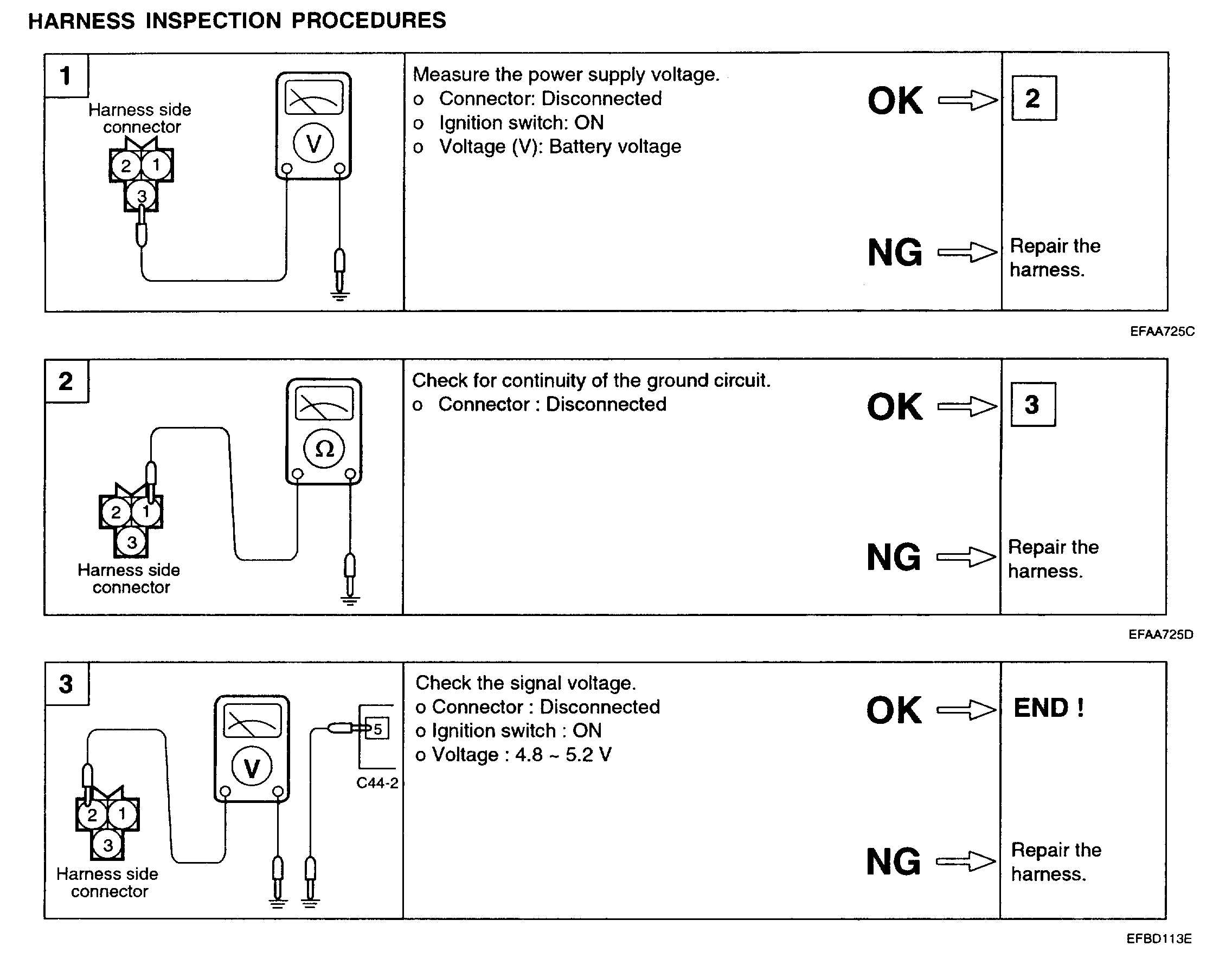

Harness Inspection Procedures
