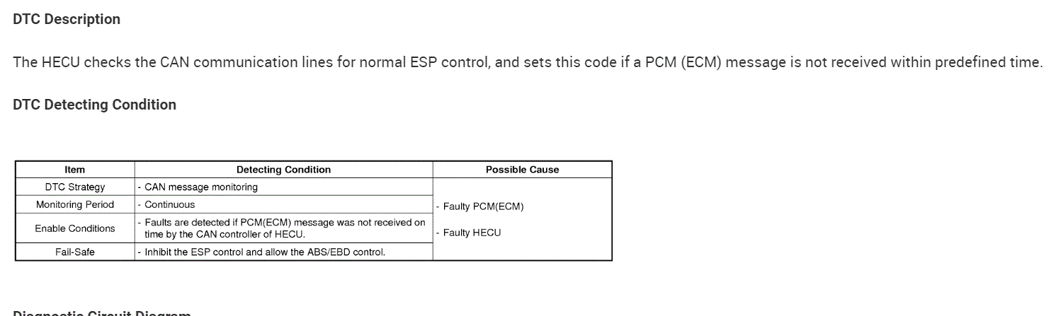

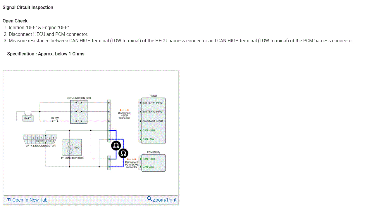

Codes c1643 dtc -comm time out yaw rate and g sensor.
C1611 dtc-lost communication with ECM

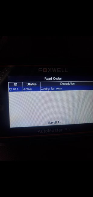

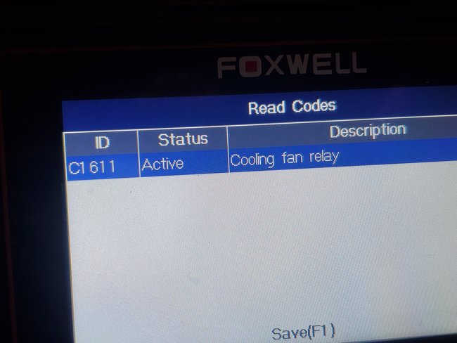

Driving 3 miles was waiting at stop light to change , proceed from stop light, car jerks check engine came on a quick second then disappeared but traction light stayed on . Goes into limp mode, rpm gauge not drops to 0 and remains there the whole ride home. Rough idle for the first few mins when at stop lights. Car then begins to drive normal come to a stop light , proceed from stop light car goes back into limp mode for about 4 blocks then goes back to normal. Get home turn car off. Restart car is normal drive for about 30 mins no lights. Codes below appeared
B1493 ocs communication error, c1611 active cooling fan relay

. After keeping car for two days . Dealer said they only spent a half hour with it and was no help and basically related the same info that you can pull up on google when researching the c1611 code about poetically being three problems and said its either the abs system module, which is obsolete now, the computer ecm which he cant get or problem in wiring harness. Basically no help at all asked dealer if i got a reman ecm or abs can they reprogram/relearn . He said they cant/ don’t recommend because it has a vin already burned in it and the car wont run right. But gave me options to buy a new hyundai

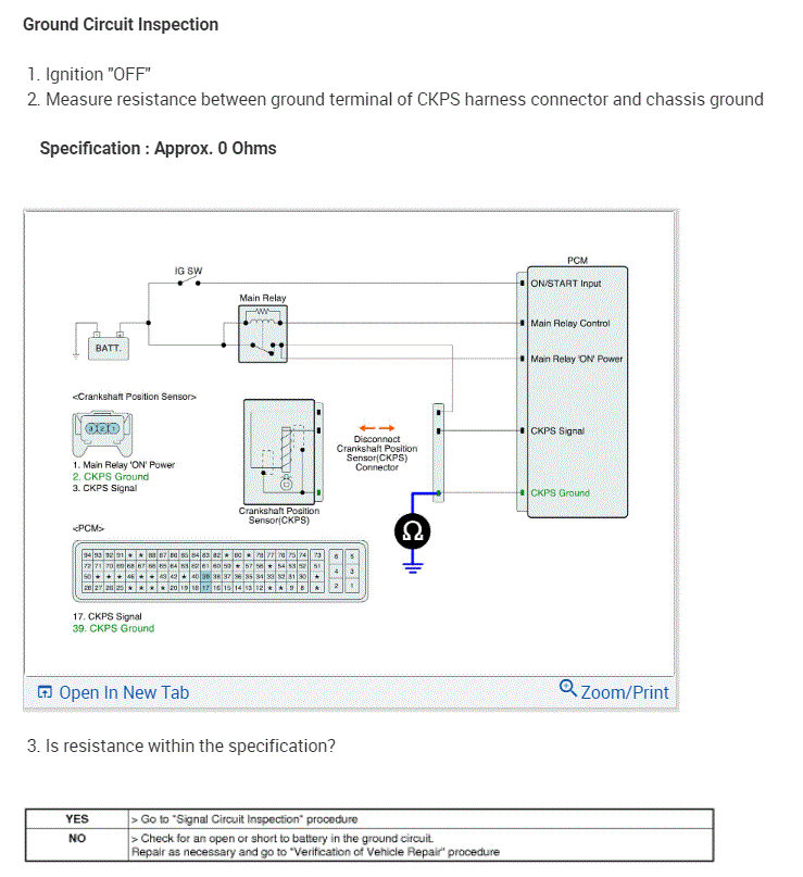

I did change the crankshaft position sensor and the driver rear wheel speed sensor after code c1260,c1207,c1611 back in August 2020.
