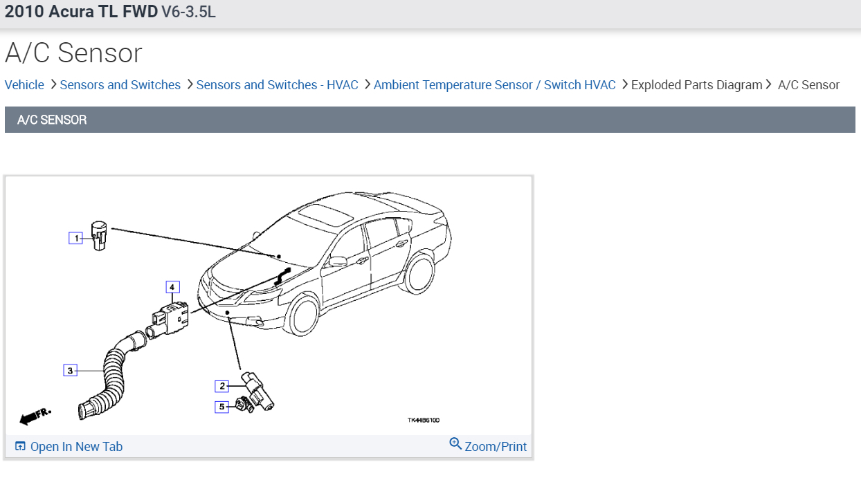

It sounds like the compressor is going out and losing the high side pressure. Tto tell for sure we would need to connect a set of gauges to check the pressures or feel the large refrigerant tube exiting the firewall to see if it is cold. If it is cold I would replace the ambient temperature sensor.
