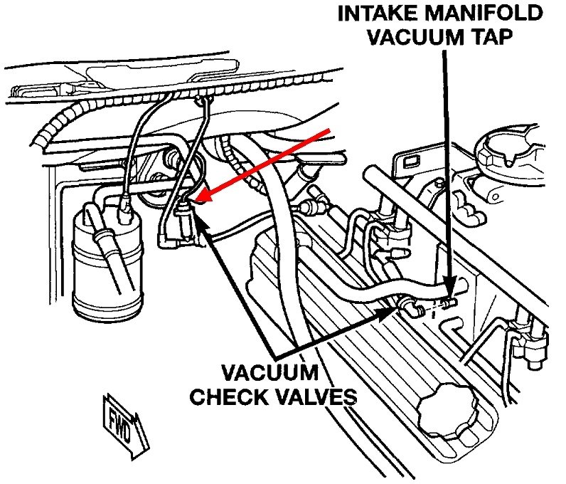

My red arrow in this drawing is pointing to the check valve in the vacuum hose that runs into the passenger compartment and runs the heater controls. It's on the firewall under the wipers. That valve is about the size of a stack of three nickels. The dealer's parts department has a replacement check valve that is roughly the diameter of a 50 cent piece, and about an inch and a half long. This one includes a small vacuum storage canister. It can be used to solve this problem on other brands of vehicles.
All you have to do is describe the symptoms to the people in the parts department, like you did here, and they'll know just which part you need. I don't remember if there's an arrow on it to tell you which way to attach the two hoses. If the heater controls don't work at all with the new valve, just switch it around, then reattach the hoses. There's a good chance you can find this valve in a salvage yard too.
