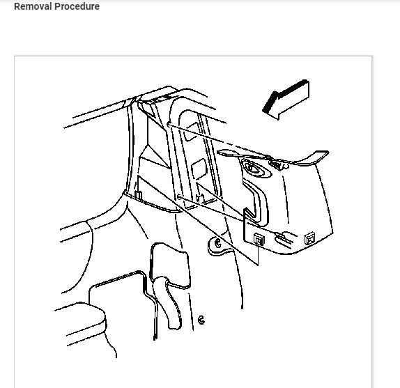

rear panel behind sliding door removal.
Nov 19, 2022 at 7:16 AM

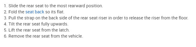

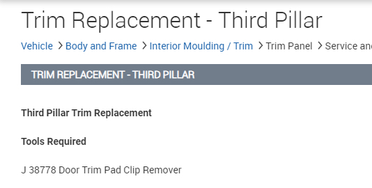

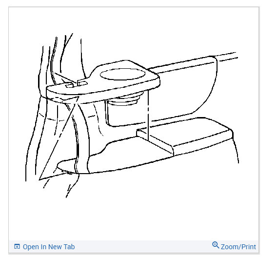

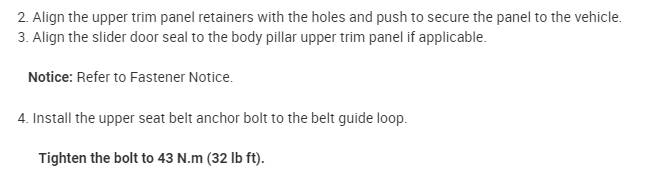

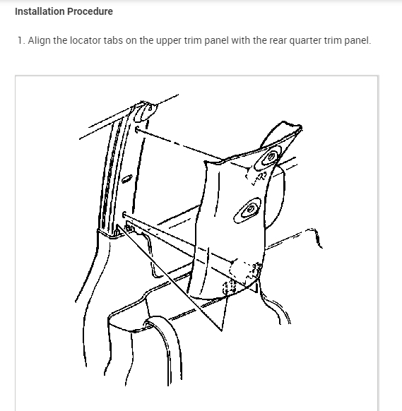

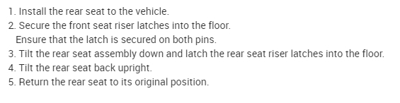

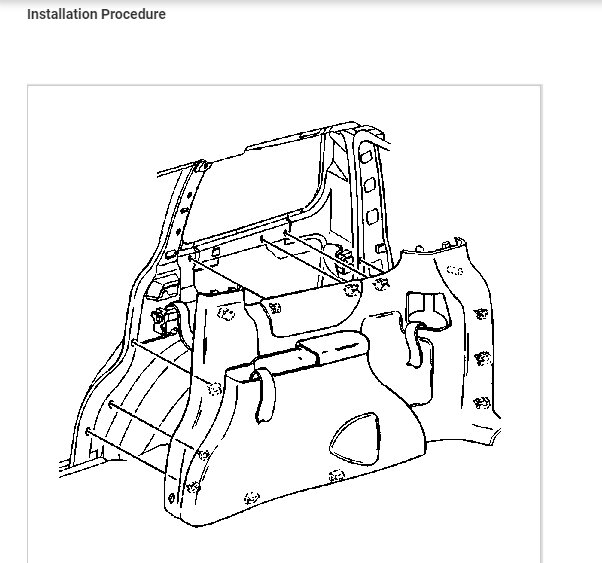

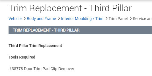

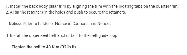

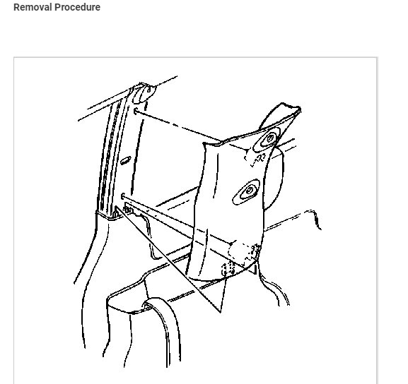

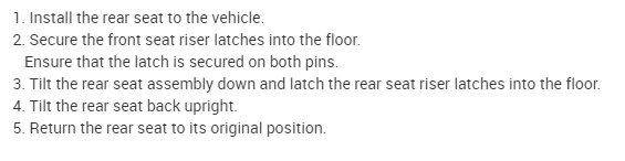

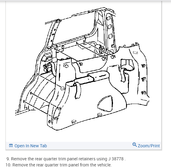

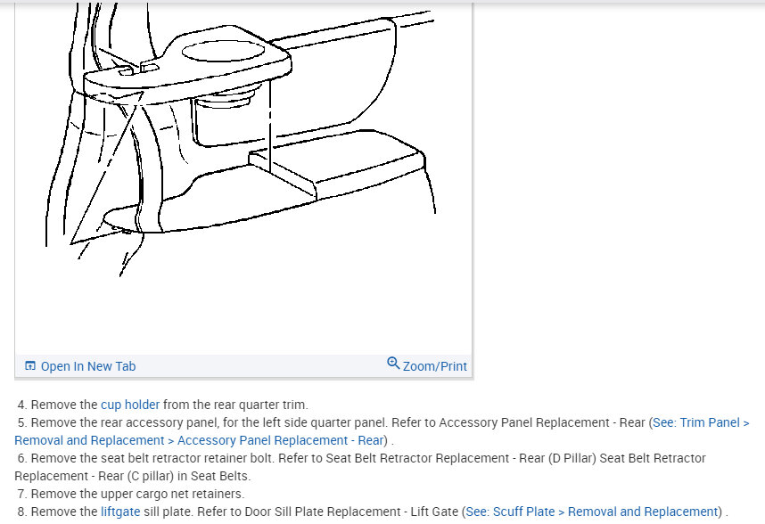

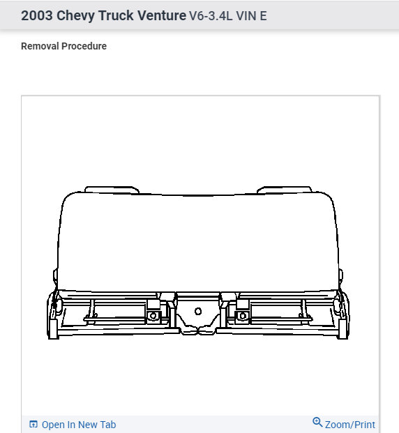

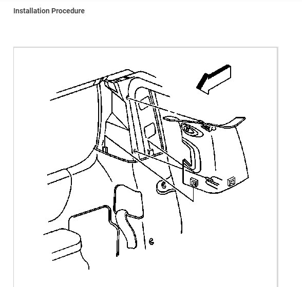

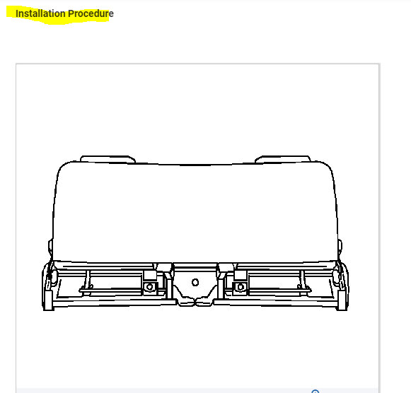

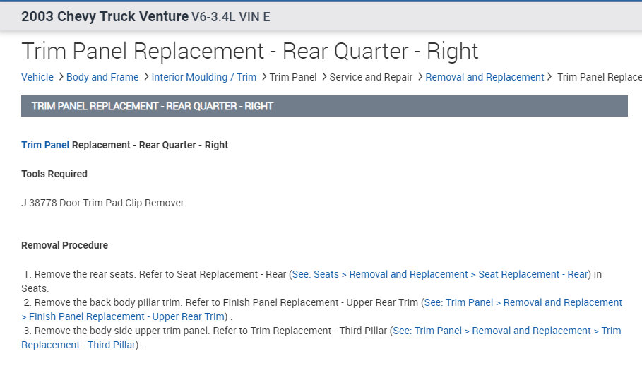

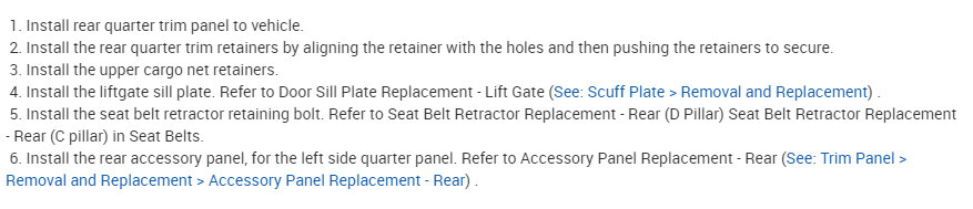

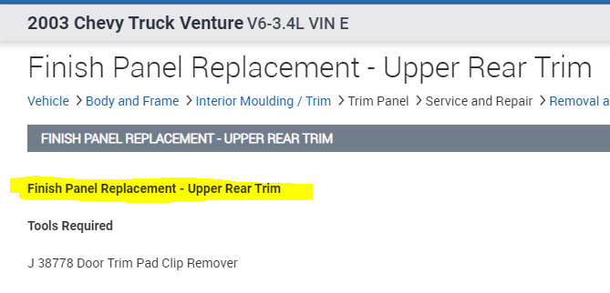

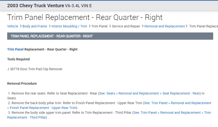

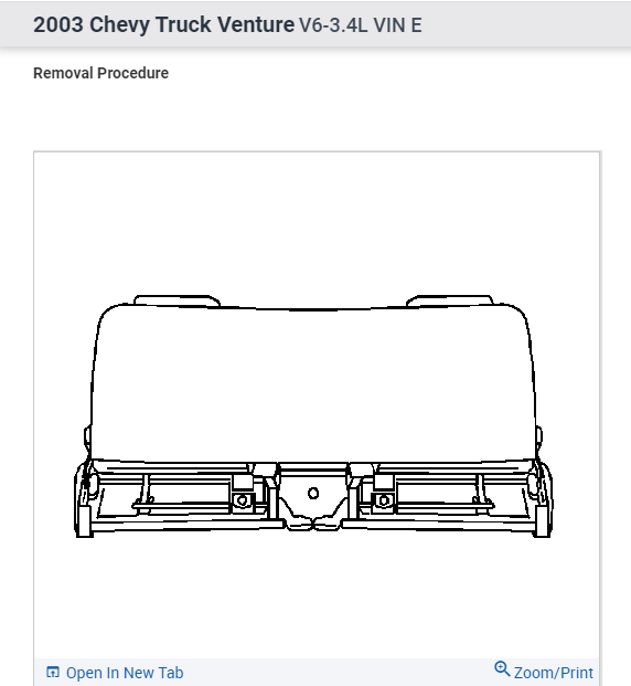

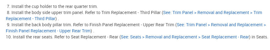

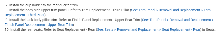

Before you remove the trim panel, the seat, upper trim panel, and the rear body pillar trim needs to be removed first.
If you look below, I attached the directions for all of the items I mentioned. Will place them in the order of removal.
See pics below.
