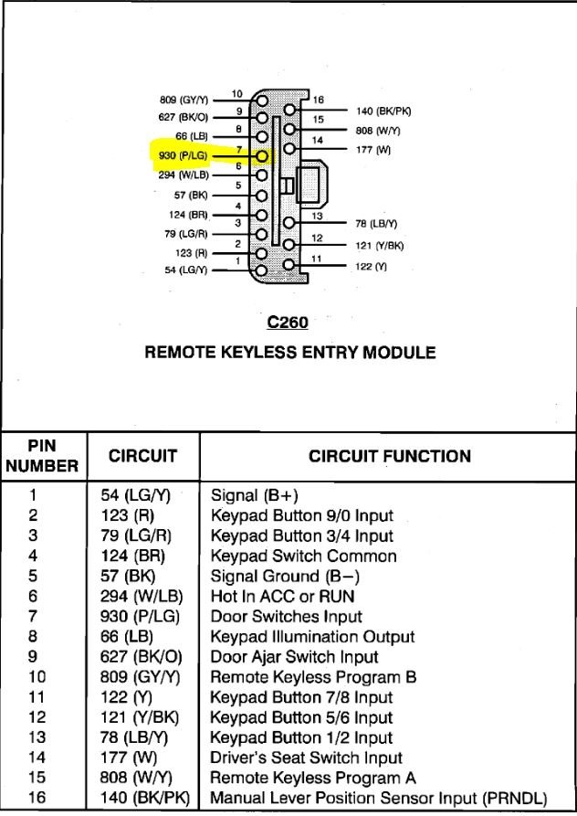

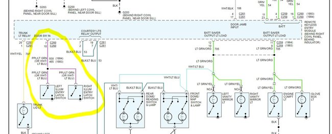

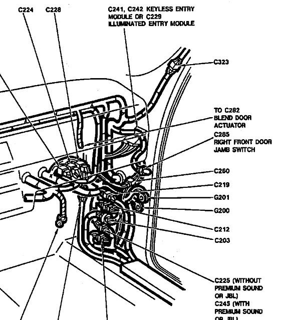

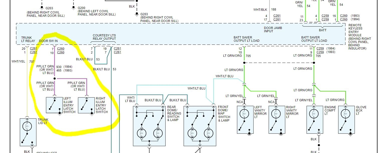

The description sounds like you have a bad illuminated entry switch in one of the door locks or the wire which comes from the switch is grounded or the transistor that uses that signal to activate the lights inside the remote entry module has failed. This is the system that is supposed to illuminate the interior when you unlock the door. It is also why the locks do not work as it thinks the door is opening all the time. These are different than the door jamb switches that turn on the lights and the door ajar warning. To test and find the problem you will want to start at the module itself. That way you can determine if it's one of the switches or the module. The module is hidden up behind the dash on the passenger side. On it there will be three connectors. The one you are looking for has a Purple with light green stripe on pin 7. That is the input from the switch. There are two ways to test this issue. The better one would be to remove that connector, then de-pin that wire from the connector. Plug it back in and see if the problem is gone. If it is then the issue is in the wiring or one of the switches, if you still have it then it's the module.
The other way would be to cut the wire, if it shuts off the lights then you found it, if not you would repair the wire and replace the module.
