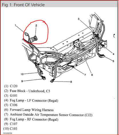

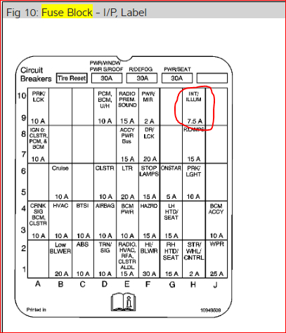

Where is the fuse at for the interior lights?
Oct 12, 2018 at 7:23 PM
DANNY L
  • 5,648 POSTS
Hello, I am Danny.
It is in the under hood I/P fuse box. I have attached two pictures of its location and a tutorial as well. Hope this helps and feel free to ask any other questions if needed.Thanks for using 2CarPros.
