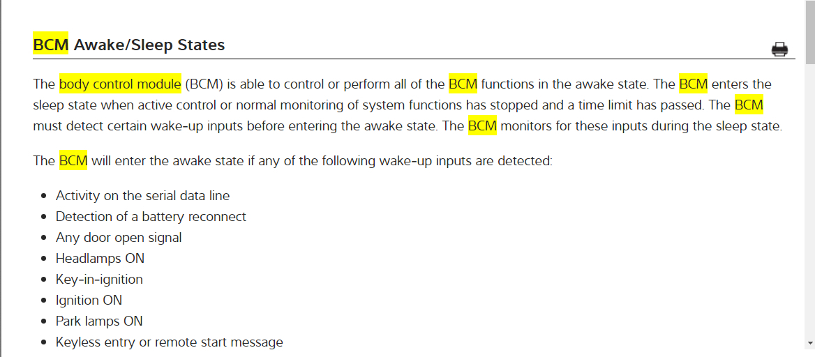

Touching the button to open drivers side window. Car will turn off and have a ticking noise coming from the door and dash. The ticking stop in about 5 minutes car will start again but interior lights stay on and radio will not turn off when door opens.
