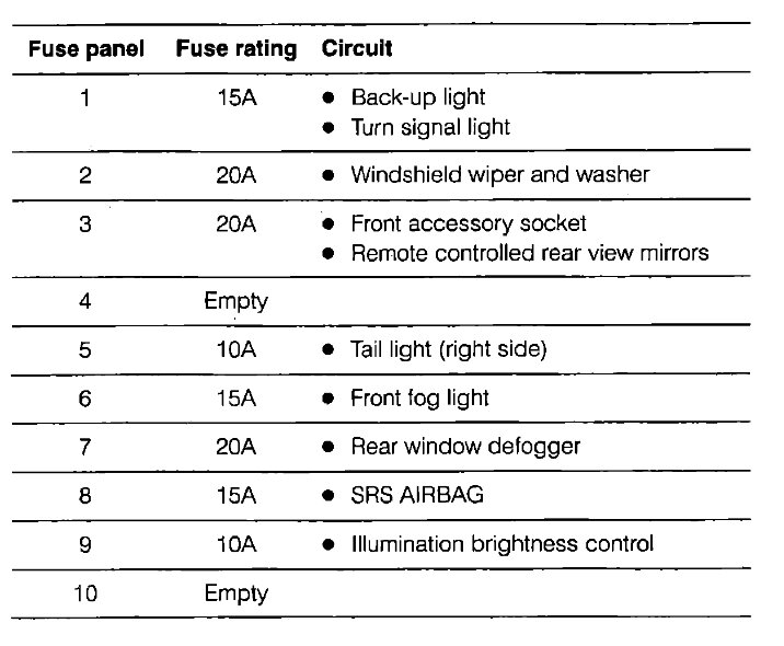

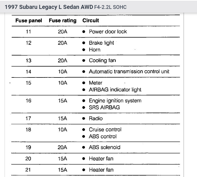

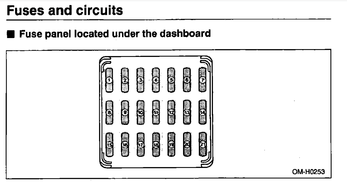

If you look below, pic 1 identifies the box and fuse orientation and identification numbers. Pics 2 and 3 are the fuse number, rating, and circuits protected.

Thank you so much. I could only find the diagram for 1998 or newer and we're not technically having any particular issues just don't have a cover on ours, so we couldn't tell which fuse went to what.
