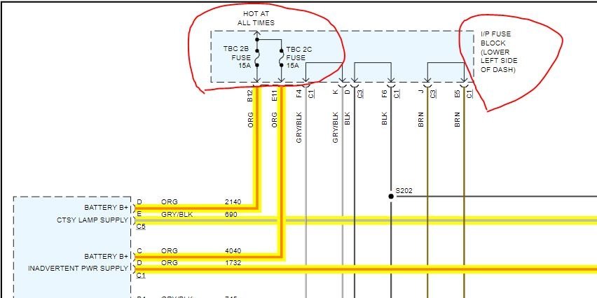

There are two different power supplies. One for the doors and headlamp switch, and one for the courtesy/map lights.
I have attached a picture indicating both fuses. They are located in the lower left fuse box in the vehicle. Check these fuses and let me know what you find. Here are a few links related to checking fuses, replacing them, and how to use basic testing equipment:
https://www.2carpros.com/articles/how-a-car-fuse-works
If you have questions, let me know. I'll watch for your reply.

Hey, thanks. I wasn't aware there were 2 different fuses for the lights. Weird they would make 2 separate circuits to 1 light fixture for 2 different things instead of just 1 for the 1...lol.
I did find out that TBC 2A was the cargo light. TBC 2B is the dome lights on the door open switch. TBC 2C was the manual push on buttons on them. These were located on the inside panel near the center bottom area, or lower front since it's at an angle. It was 15A and it was blown. Probably was blown when a light bulb melted...it looks like 1 might have in the rear dome light before I got the truck used.
Changed that and they work fine.
