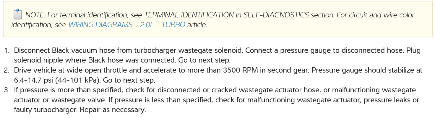

I wanted to know what size can fit the car listed above it is the GST model intercooler and if anyone knows the stock PSI on waste-gate pressure? Thanks.
Jul 20, 2017 at 8:44 AM
HMAC300
  • 48,601 POSTS

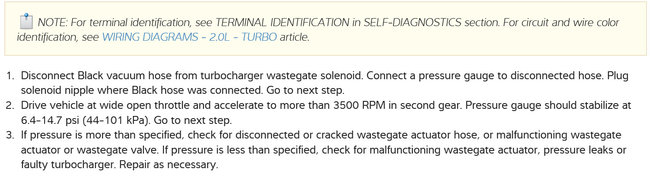

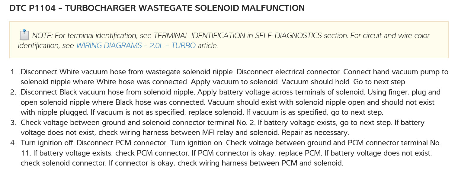

turbo pressure should be 6.4-14.7 psi for stock specs. if there is a wast-gate problem it normally sets a code for the intercooler check with people that manufacture them they will probably know due to size of turbo unless you are enlarging that as well. Pictures show tests for waste-gate and solenoid.
