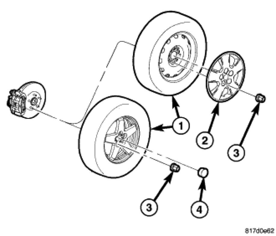

pic 1
2. Remove the wheel mounting nuts (3), then the tire and wheel assembly (1).

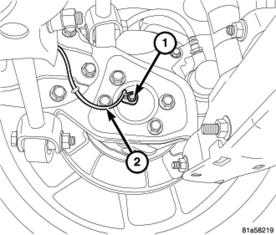

pic 2
3. While a helper applies the brakes to keep the hub from rotating, remove the hub nut (1) from the axle half shaft (2).

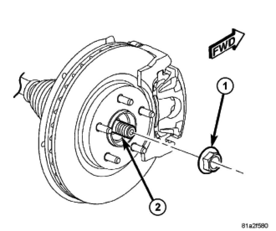

pic 3
5. Remove the four bolts (2) fastening the hub and bearing to the knuckle (3).
6. Slide the hub and bearing (1) off the half shaft and out of the knuckle.

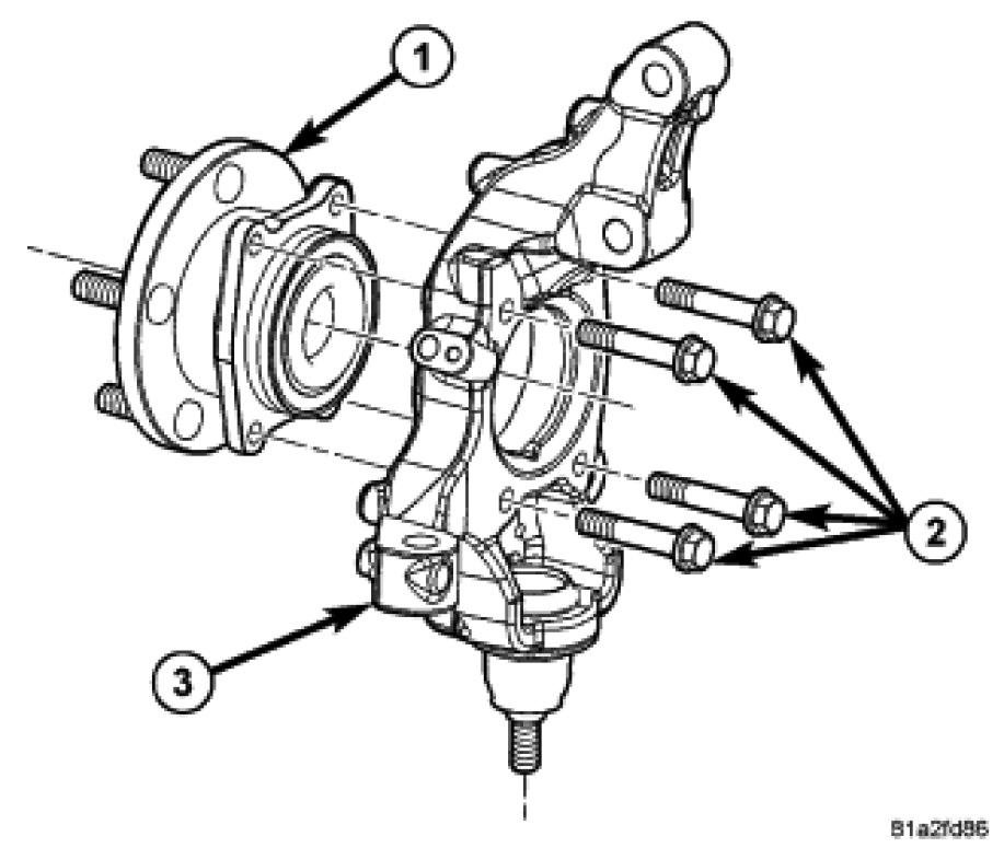

pic 4
1. Install the hub and bearing (1) by sliding it over the half shaft and into the knuckle.
2. Install the four bolts (2) fastening the hub and bearing (1) to the knuckle (3). Tighten the four bolts to 82 Nm (60 ft. lbs.).

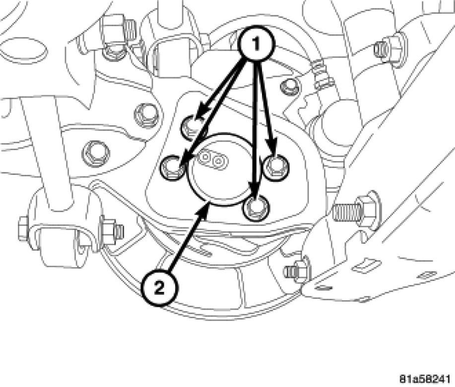

pic 5
4. Clean all foreign matter from the threads of the half shaft outer C/V joint.
5. Install the hub nut (1) on the end of the half shaft (2) and lightly tighten it.
6. While a helper applies the brakes to keep the hub from rotating, tighten the hub nut (1) to 132 Nm (97 ft. lbs.).
