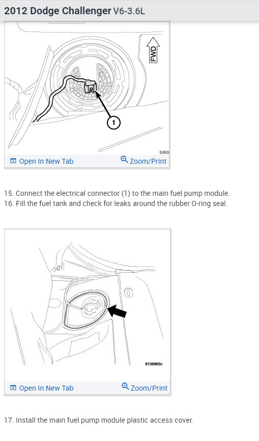

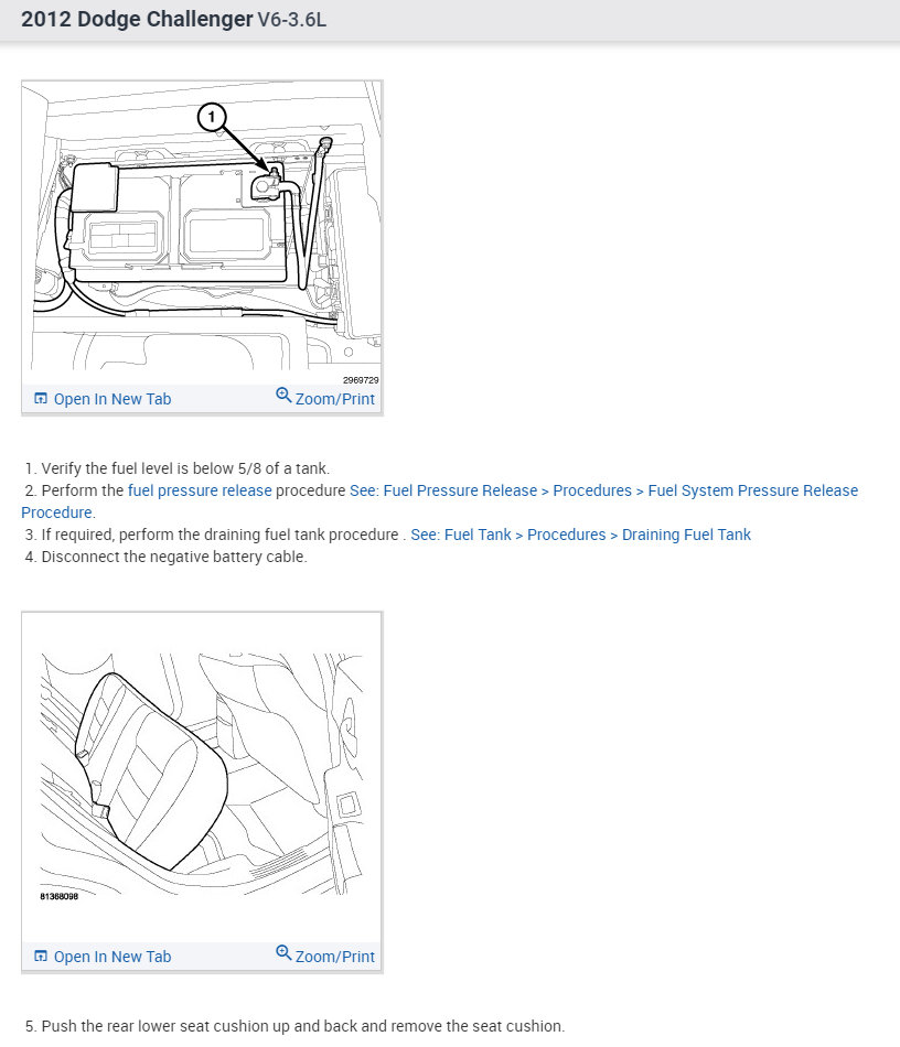

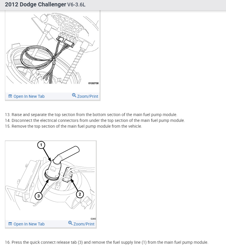

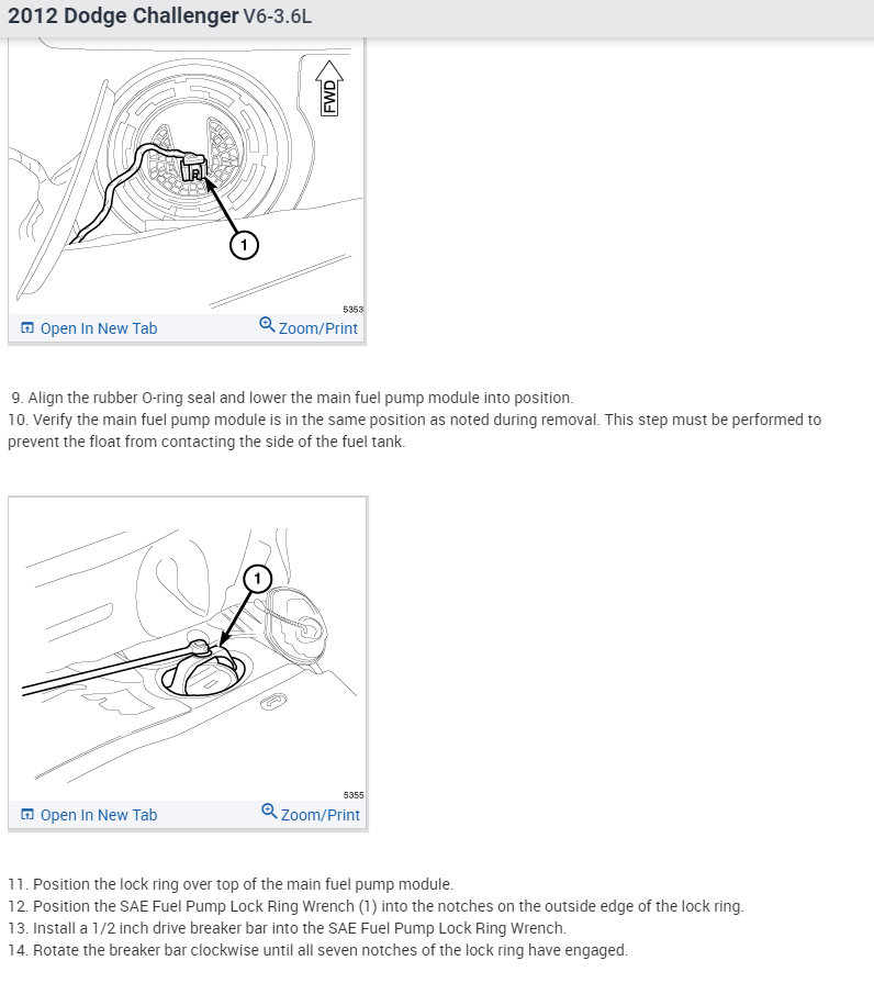

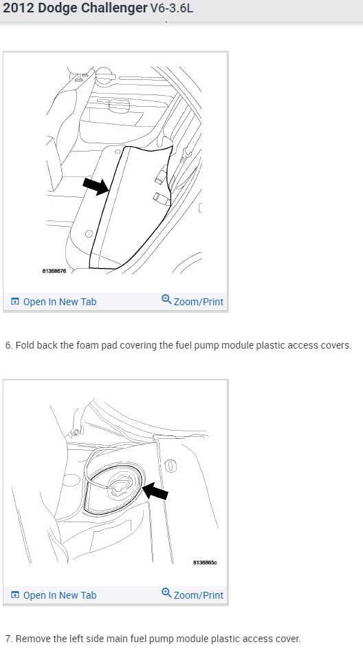

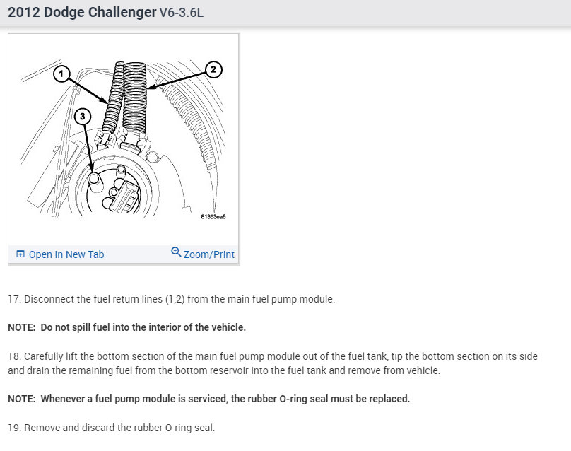

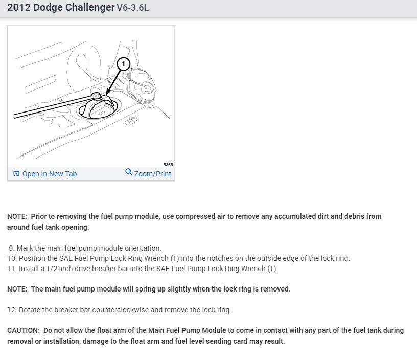

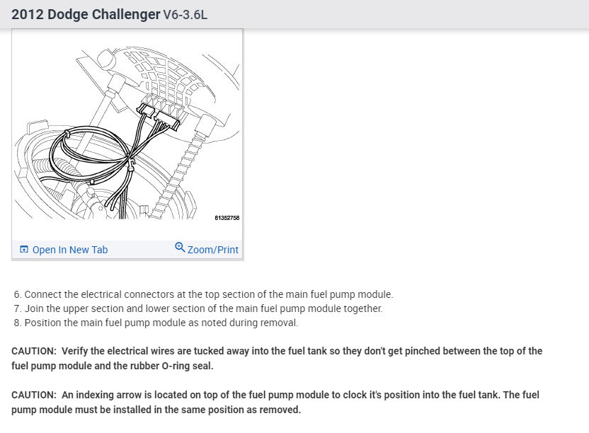

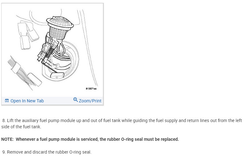

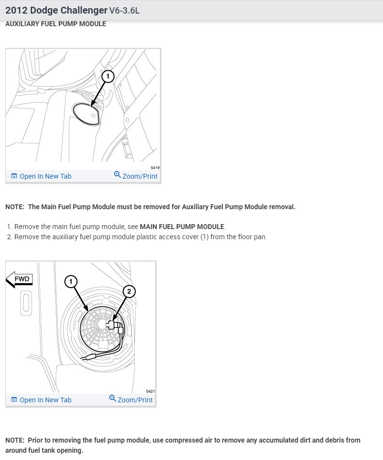

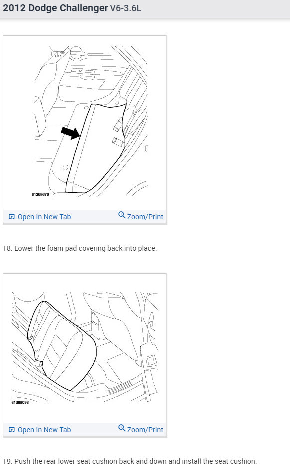

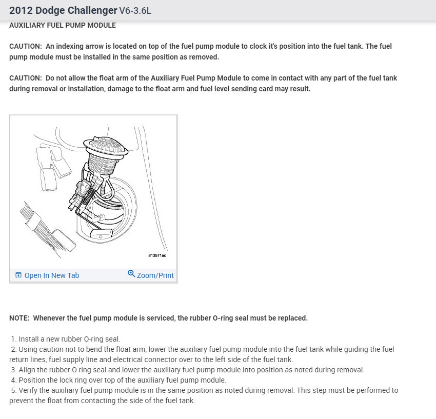

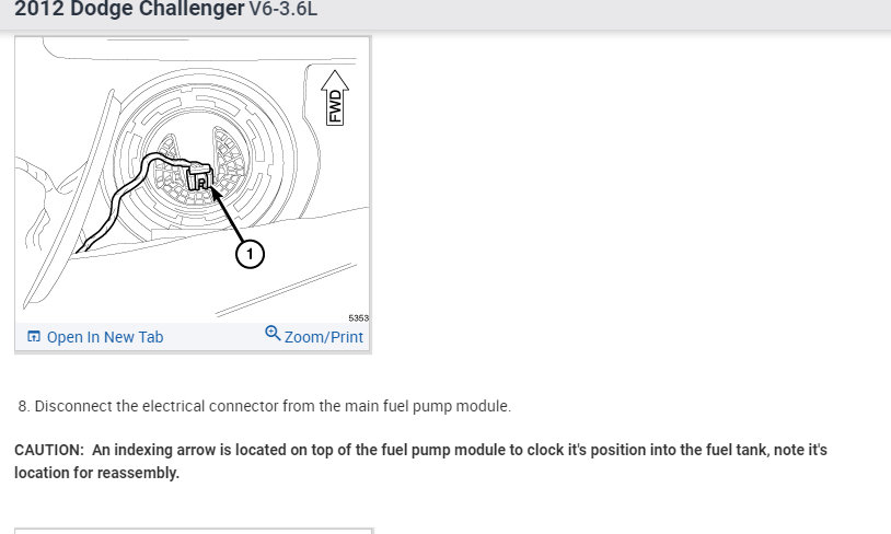

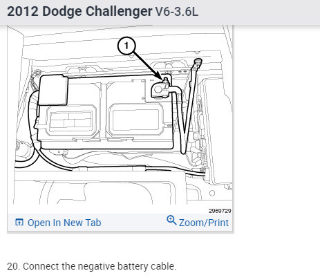

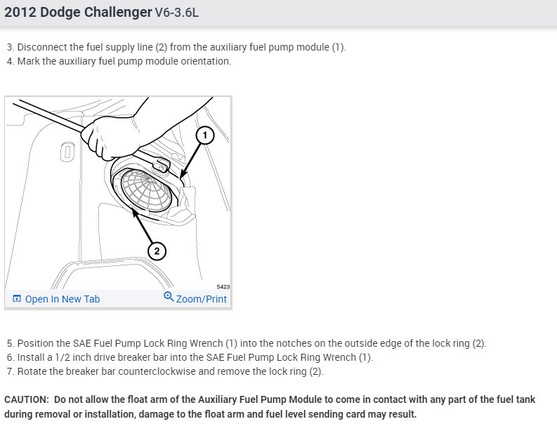

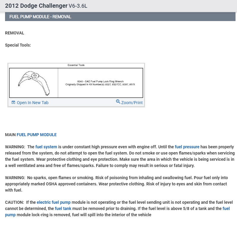

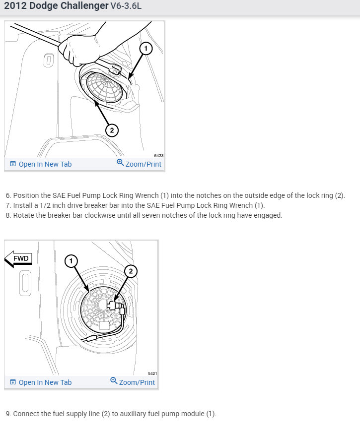

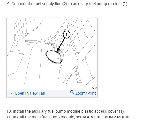

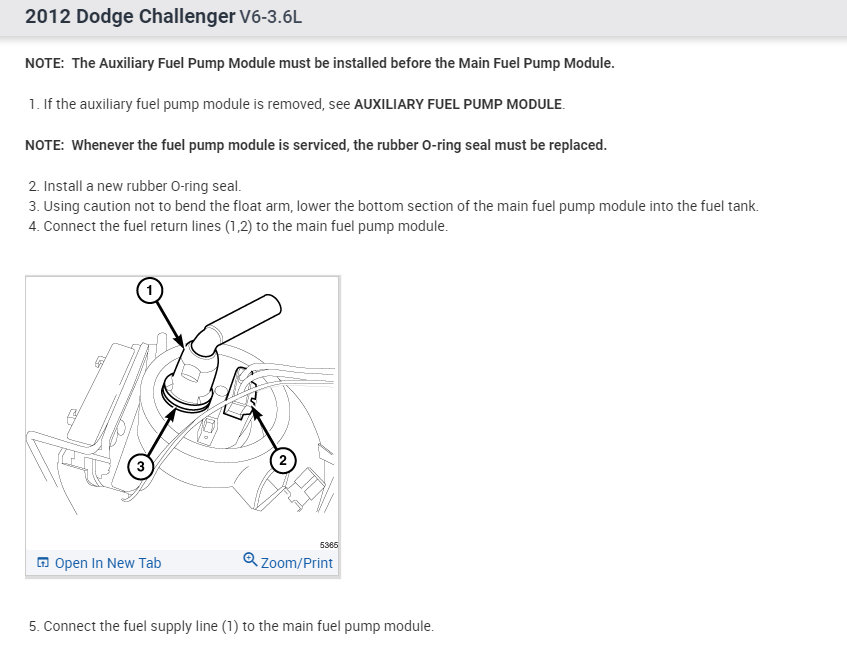

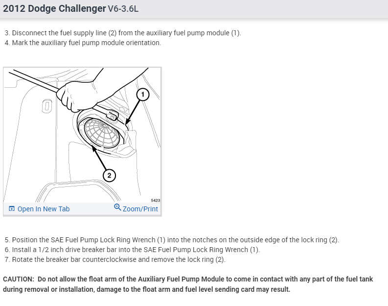

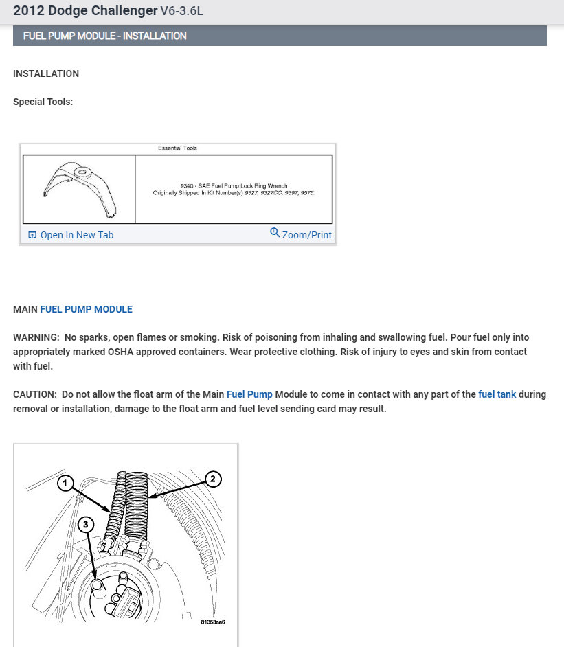

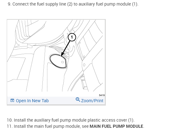

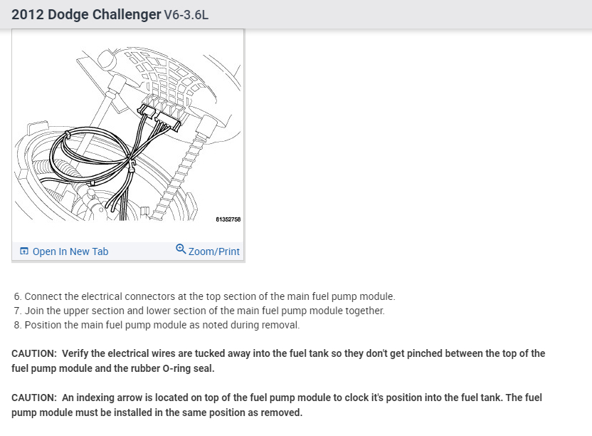

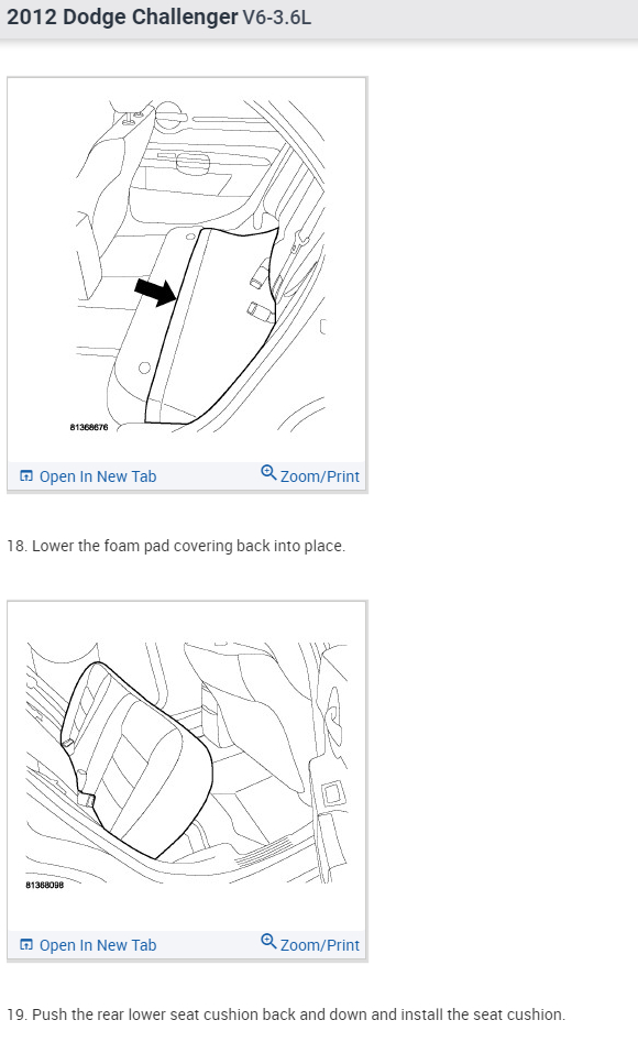

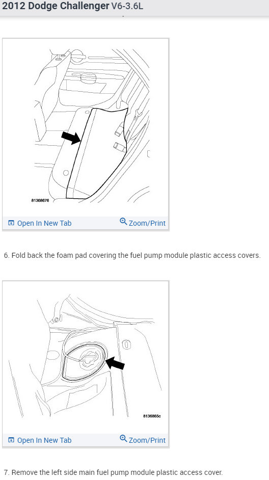

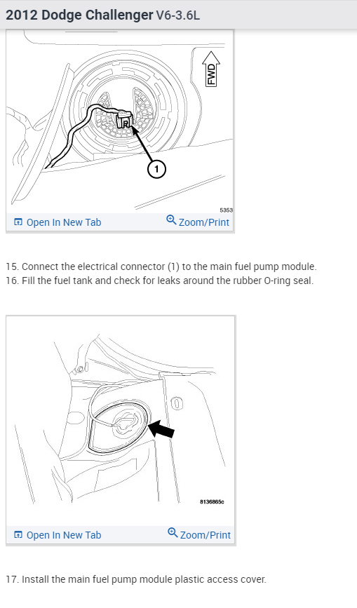

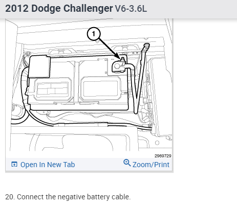

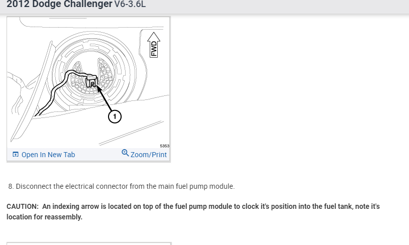

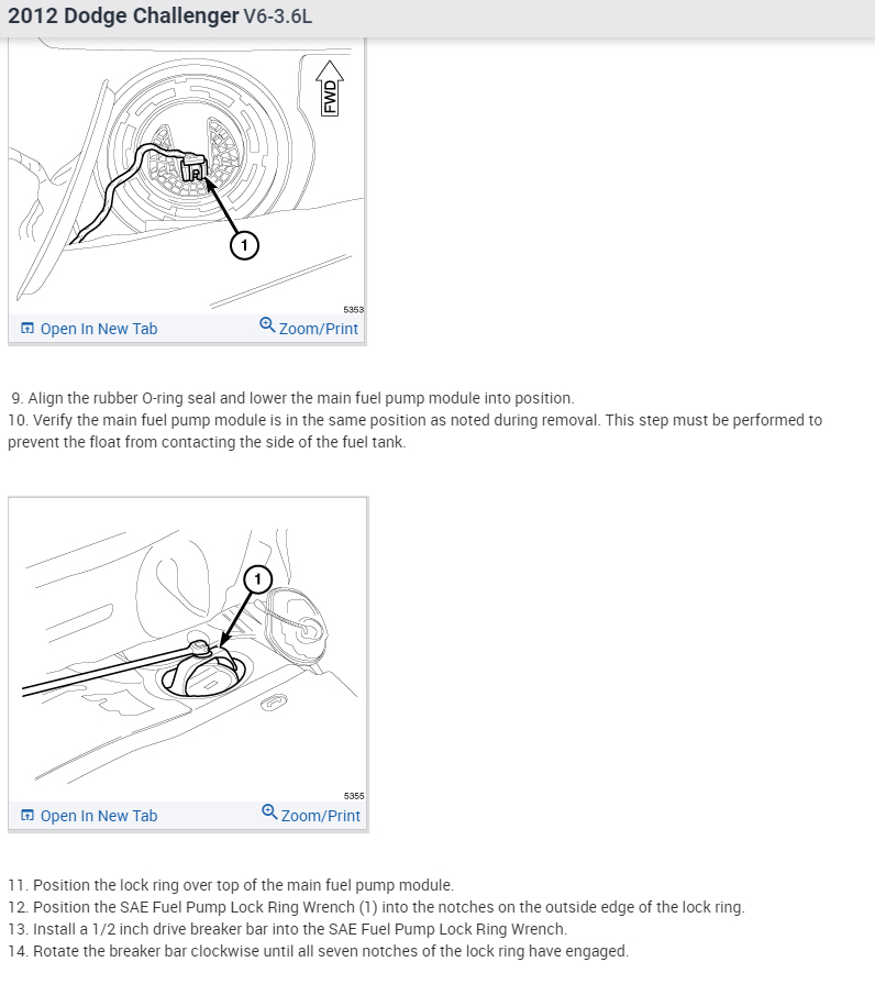

Unfortunately, those fuel pumps are not interchangeable as they have different specifications and dimensions.
I have attached the fuel pump replacement procedure below for your reference.
Let me know of any questions.
Thank you.
