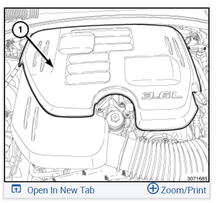

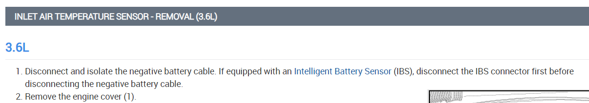

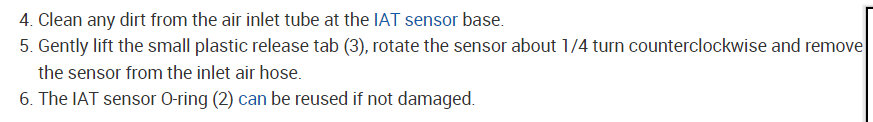

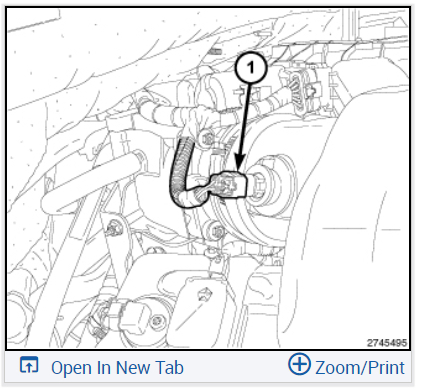

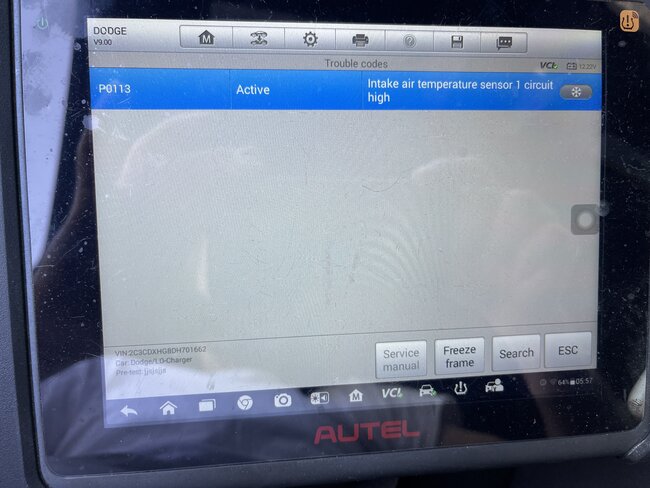

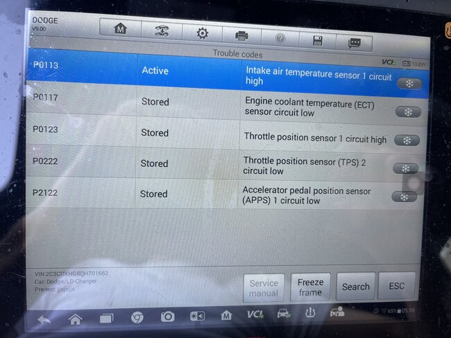

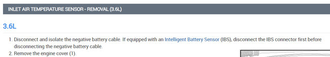

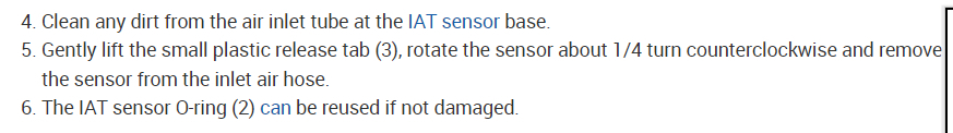

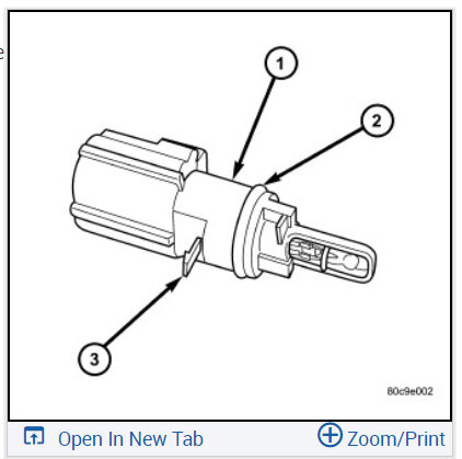

I bought it from auction, had these codes. I deleted all to see what stays and it was the p0113, even without the engine running. So, I thought it had to do with the wire, so I went and saw that it was disconnected. So, either someone disconnected it at auction, or maybe the car develops issues while driving if the sensor is connected? You ever seen drivability symptoms with the sensor being bad? for now, the code is gone after I connected it.
