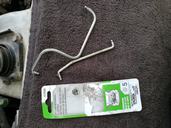

I thought these had already posted, sorry about that.

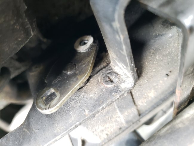

Yes, the rods were missing but I got replacements which are the ones in the picture. Now I know the rods go connected in the holes on the second photo but after that I can't where the end of both rods are supposed to be connected.

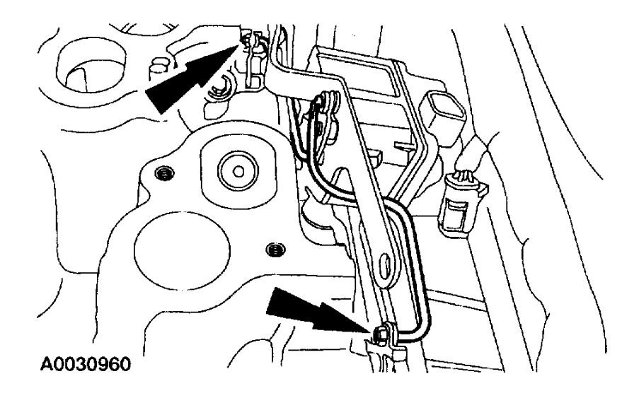

Does this picture help?
Jul 9, 2019 at 11:48 AM
CL927012
  • 5 POSTS
Yes sir. Thanks a lot for the help.
