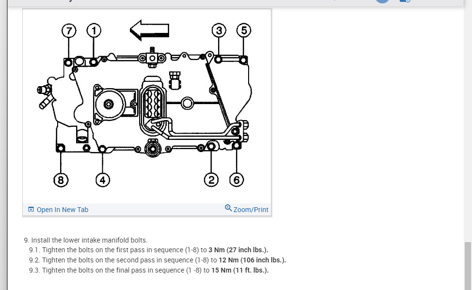

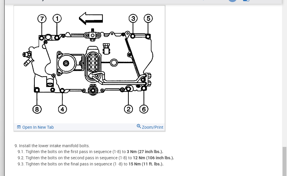

Additionally, there is a specific torque sequence and torque spec that should be followed.

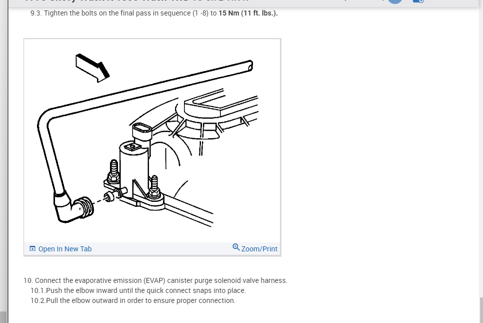

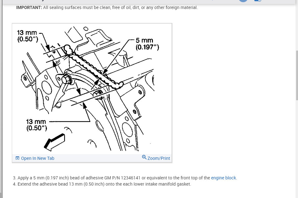

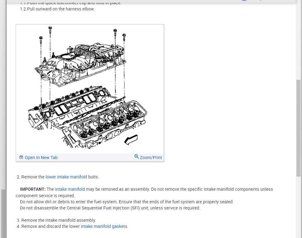

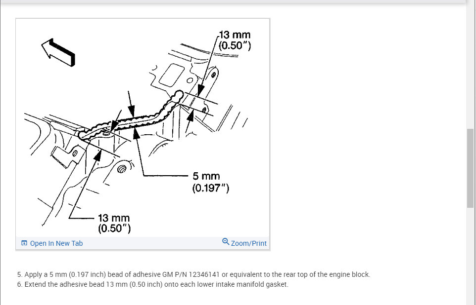

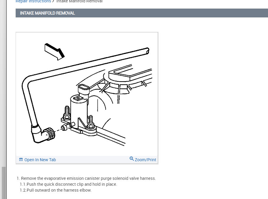

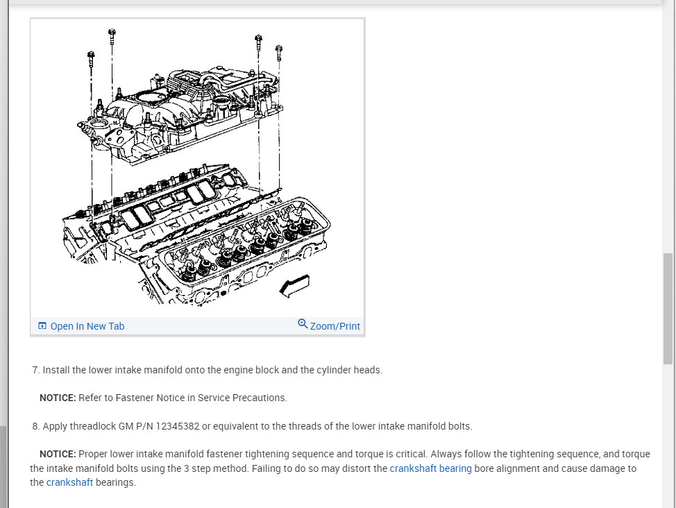

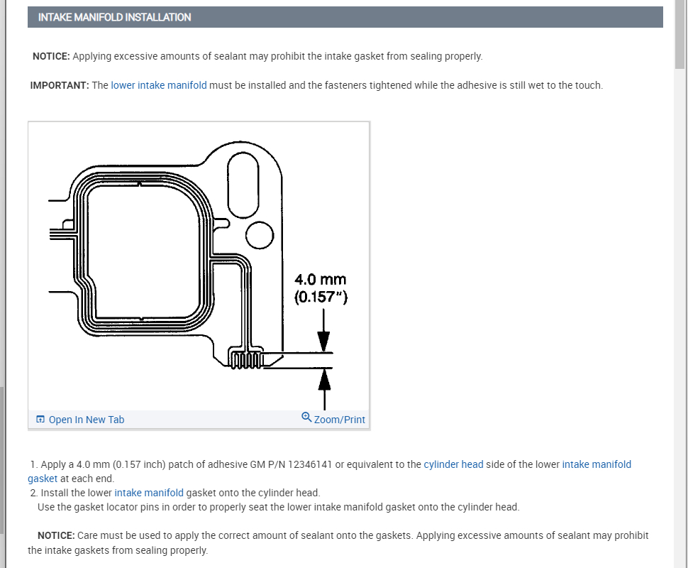

Plus, I am attaching the process below on how to replace the intake because there is a torque sequence as Joe mentioned but also some other info that you should be aware of, if you are not.
