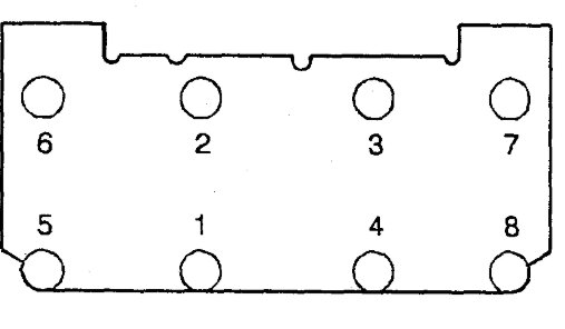

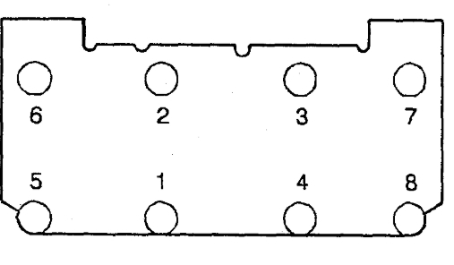

Cylinder head. These are torque to yield so you will need new head bolts FYI.
Tighten the bolts in sequence to 45 Nm (33 lb ft). Use the Torque Angle Meter in order to turn the bolts an additional 90°. Check out the images (below). Let us know if you need anything else.
