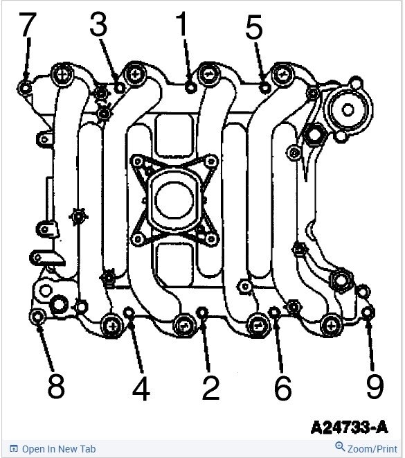

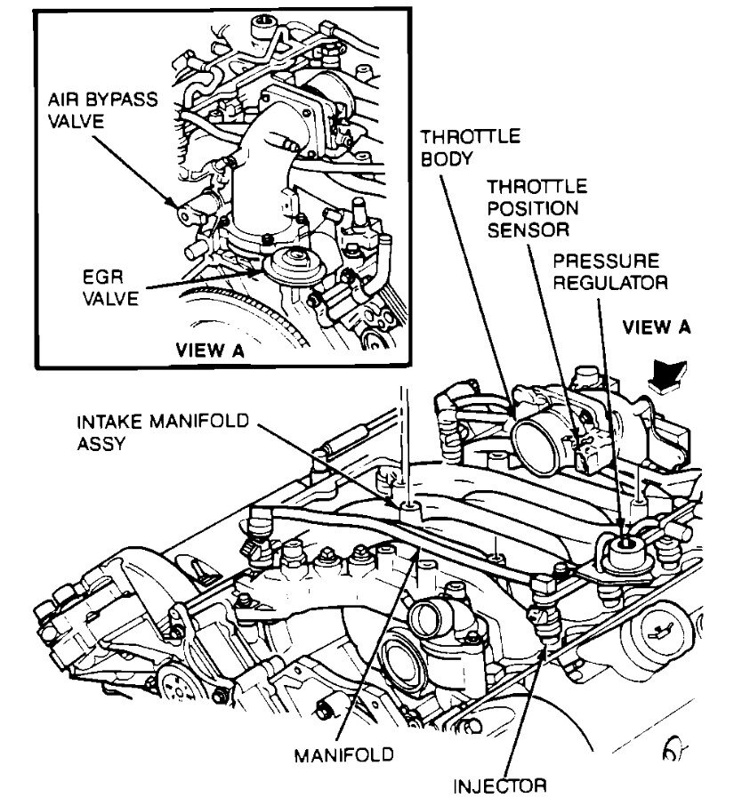

No. Ford changed the design of the manifold on the newer version of that engine. Yours has the throttle body mounted to an elbow at the rear of the intake while the newer intakes mount it on the center on top, images attached show the difference. You would be looking for a Ford F4AZ9424C intake. If you look in the Ford catalog, they show that it fits variants of the TC up to 2000, however that is misleading as in reality those are "new" vehicles, but they are built on the older designed engine and chassis. Basically, the upfitters knew that Ford was making changes, so they ordered extra cars for 1995. Then they built them as they were ordered. As such you might buy a 1999 Lincoln Town Car Limousine and discover that it is built on a 1995 chassis. Plus, you likely wouldn't like the newer manifold design, they were a downgrade that were known for cracking and leaking coolant and extended the warranty on them as well as issued letters for people to bring them in for a replacement part.
