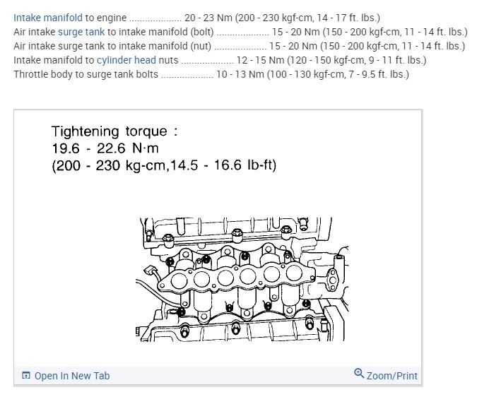

Trying to find the torch specifications to my intake manifold.

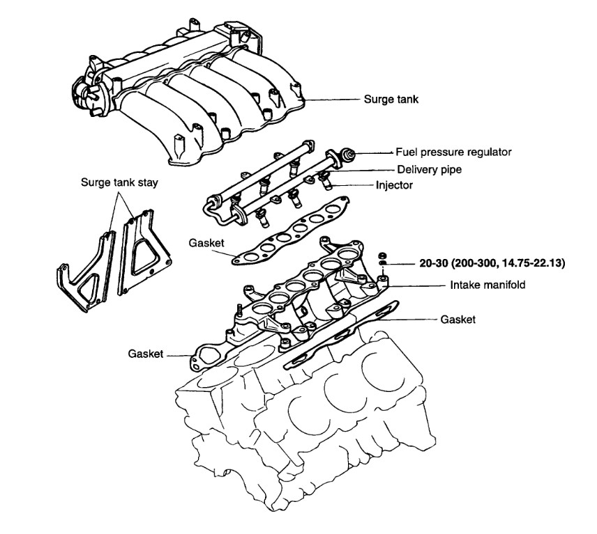

Here are the specs for the intake pieces. Be sure to use an X pattern as you torque it down.
