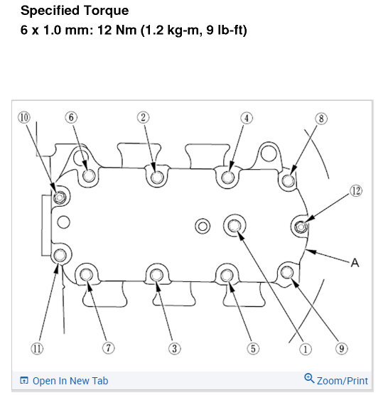

I need torque specification for a j35z8 engine.
Aug 2, 2023 at 12:45 PM

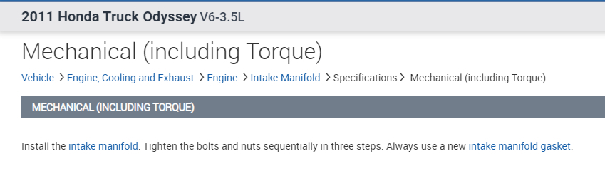

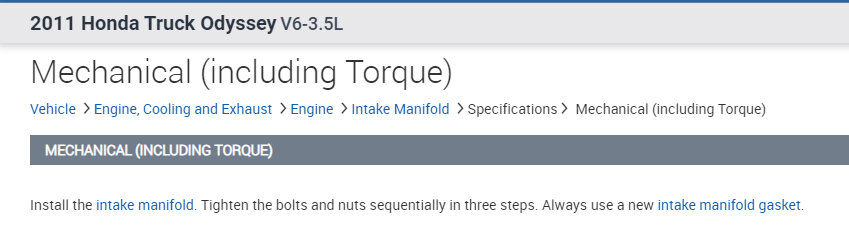

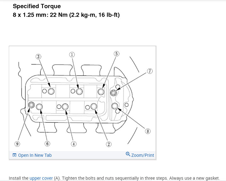

When you do this, it has to be done in three separate steps. Also, note the directions are for both lower and upper manifolds.
If you look below, I attached the torque specifications along with the torque sequence. Take a look through them and let me know if it helps or if you have questions.
See pics below.
