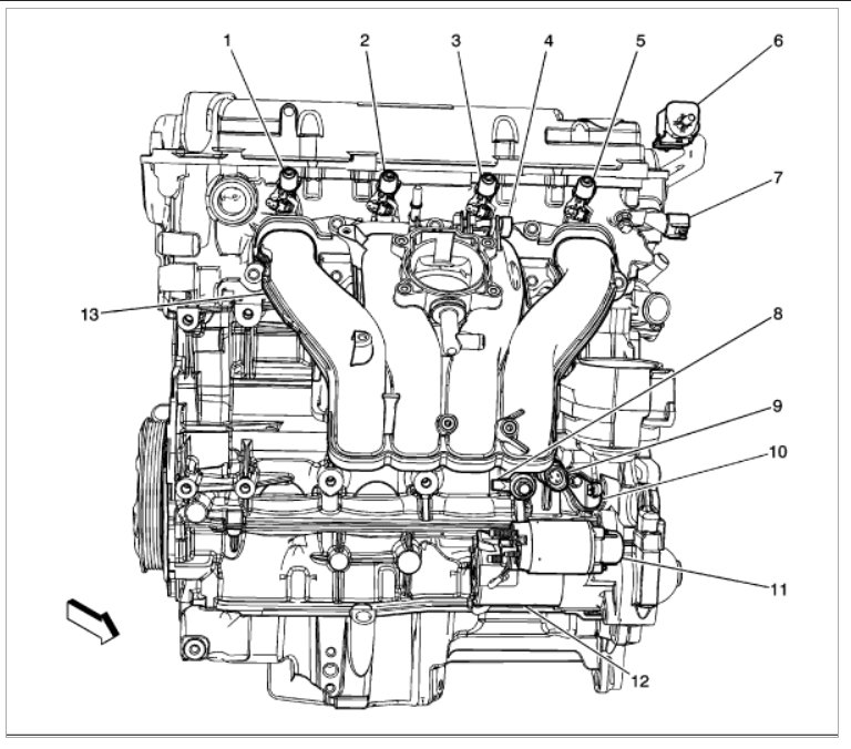

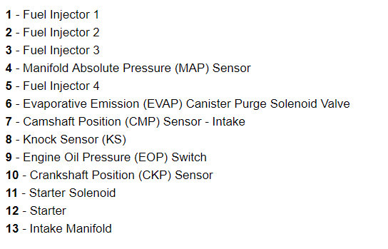

Here is the location for your car.
Check out the diagrams (below).
