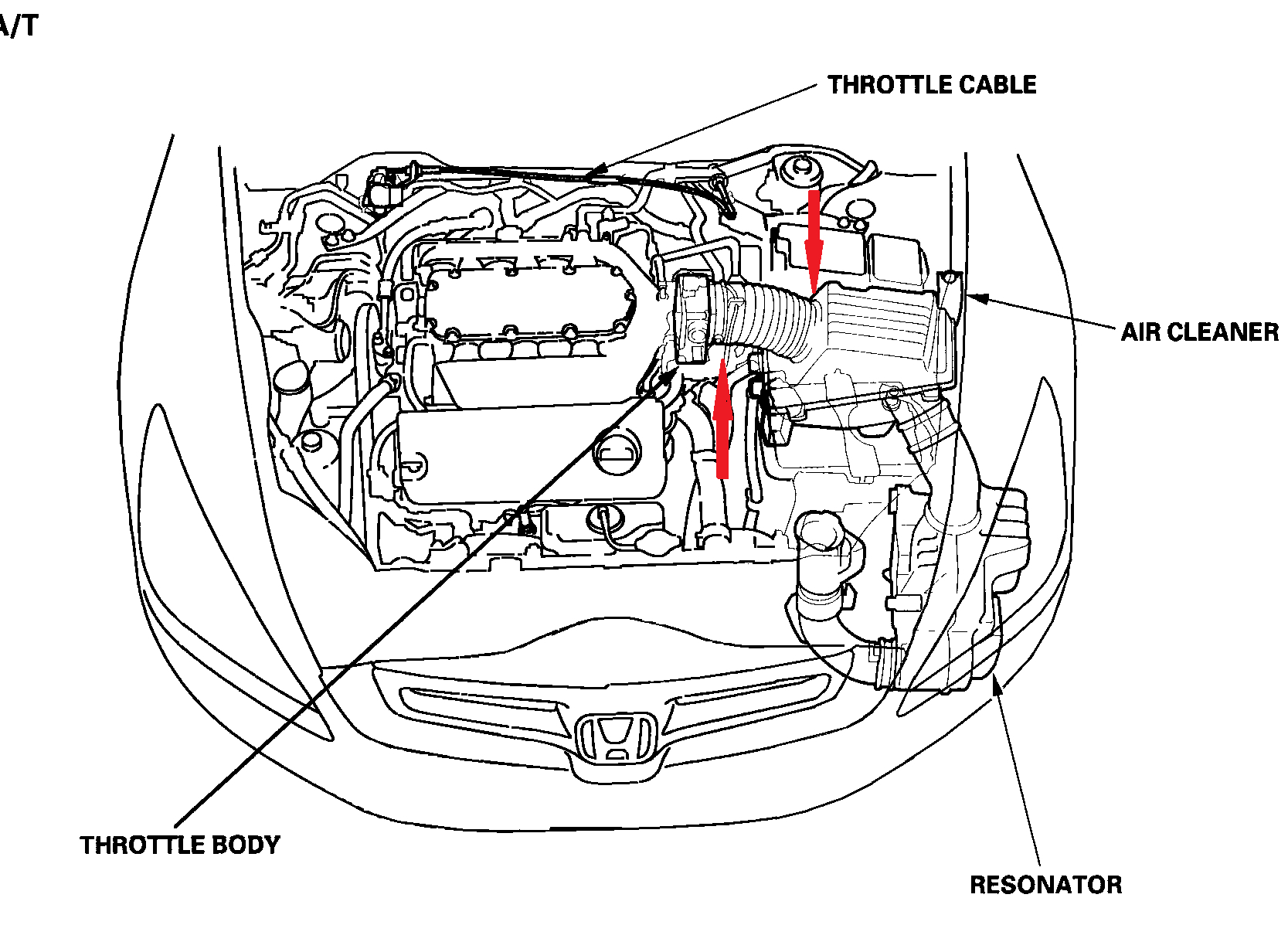

Intake boot is ripped and I need to replace it.
Nov 5, 2016 at 10:57 AM
AL514
CERTIFIED EXPERT
5,465 POSTS
the boot to the throttlebody? can you not replace it?
Nov 5, 2016 at 10:59 AM
AL514
CERTIFIED EXPERT
5,465 POSTS
There should be two hose clamps at red arrows to undo the boot. very easy to replace.
