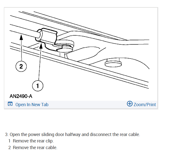

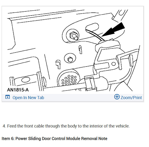

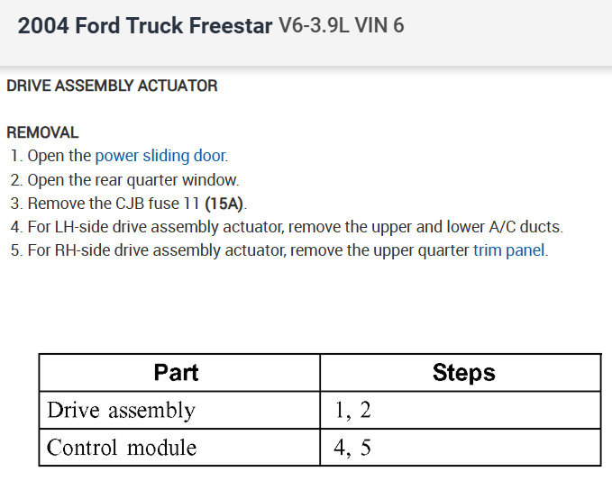

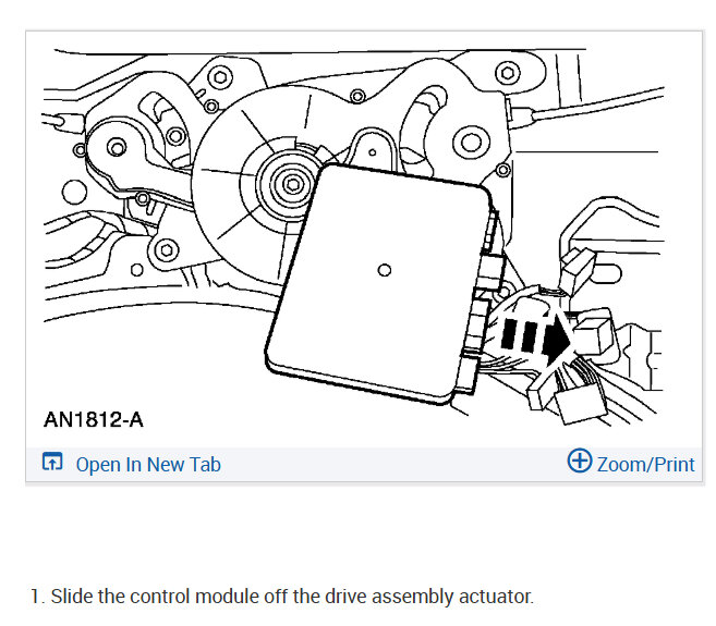

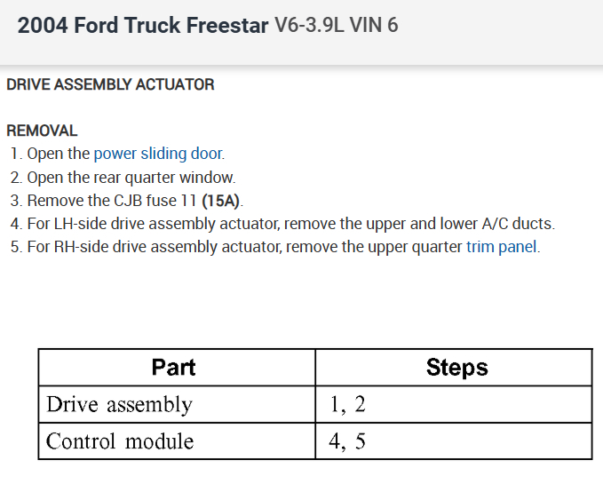

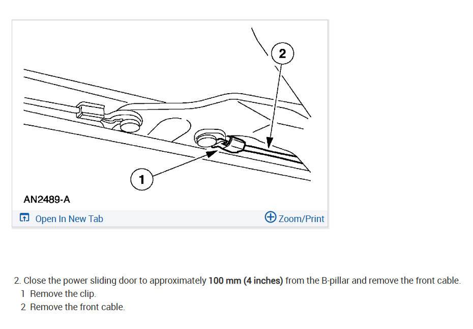

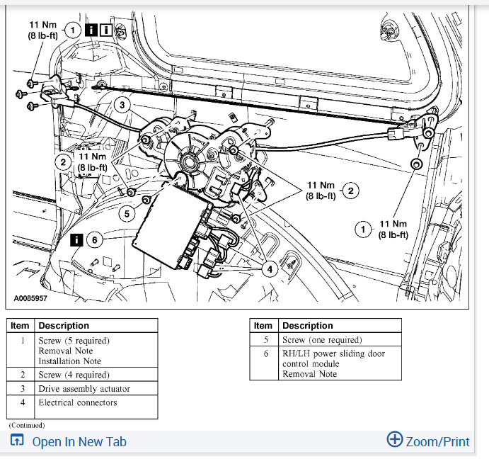

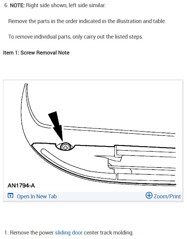

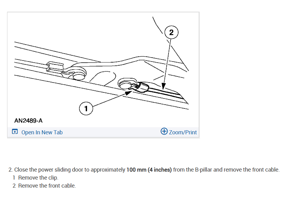

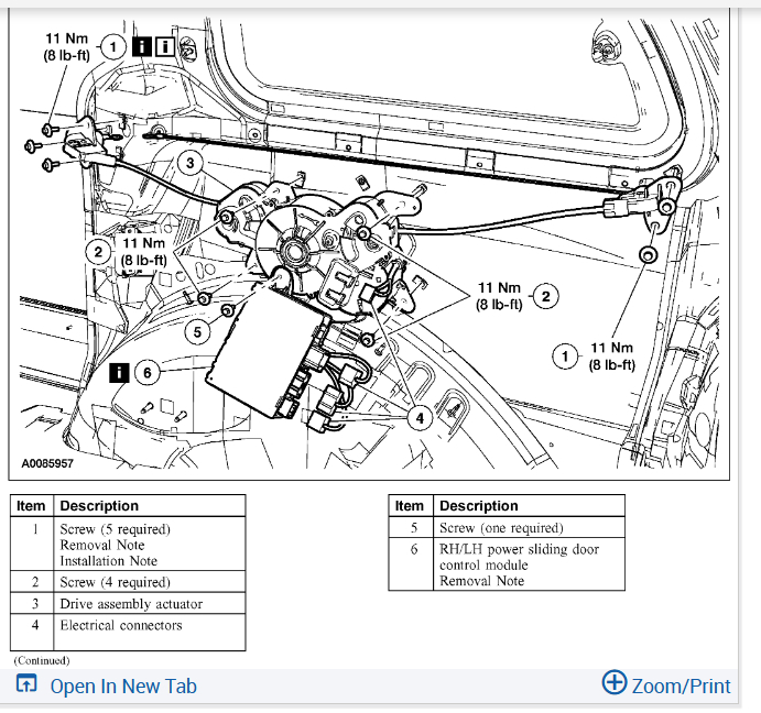

If this does not work here is how to change the motor and drive cables out. Check out the images (below). Please upload pictures or videos in your response of any problems so we can see what to help you with.

Hmm, it only shows the power slider, did someone remove the motor part? I would look in the track to see if a bolt or screw has come loose and is stopping the door track wheels. You can upload images if there are any questions.
