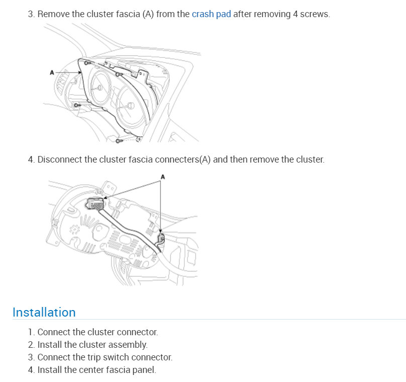

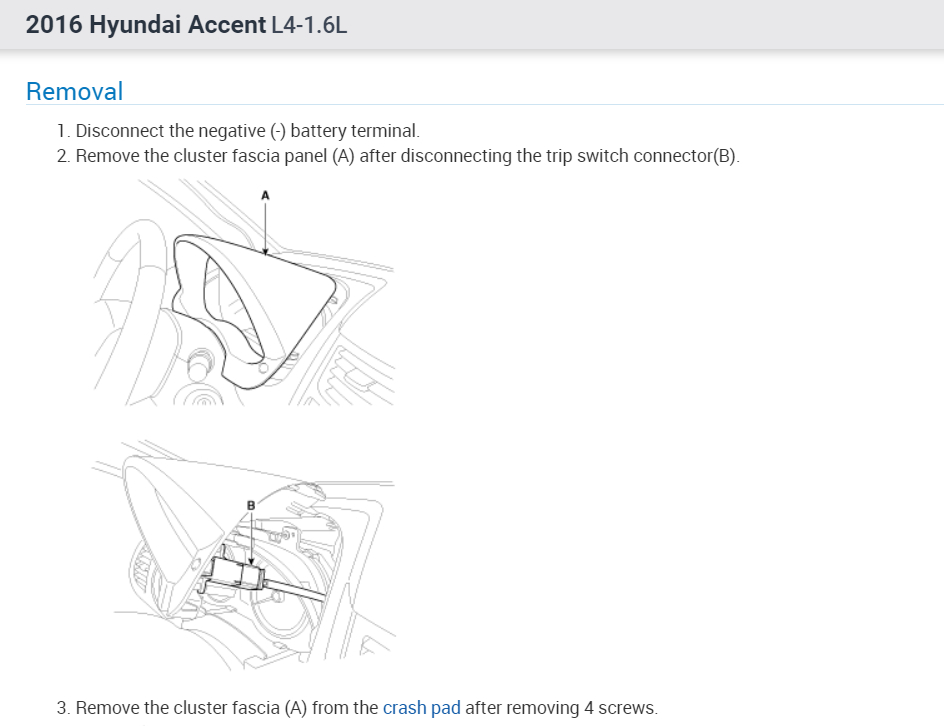

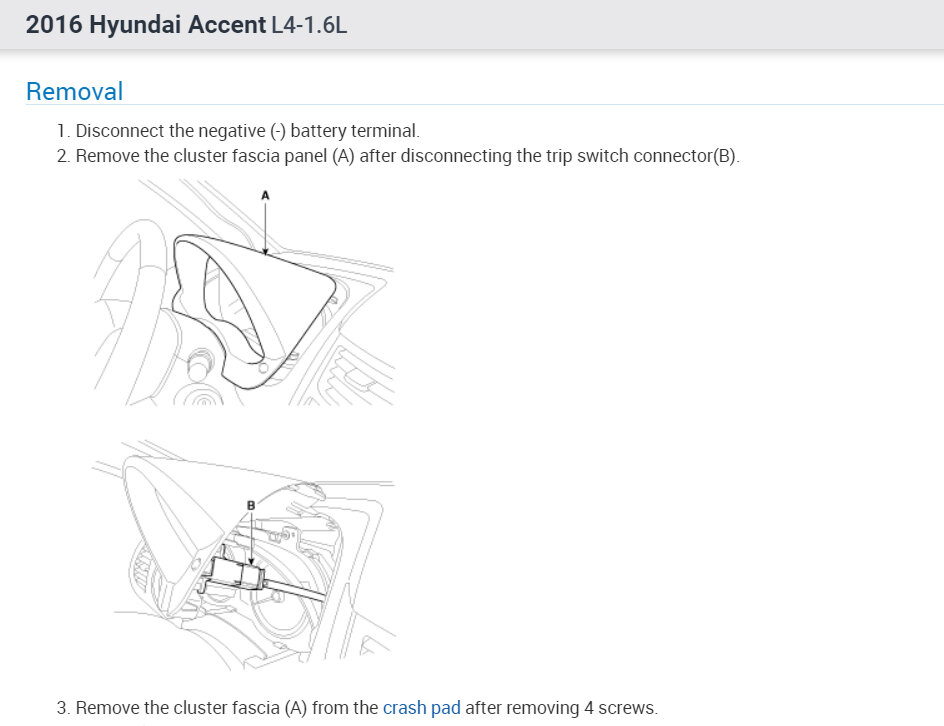

here is how to change the cluster out which you can get a rebuilt unit by searching google or eBay. Check out the images (below). Please let us know what happens.
