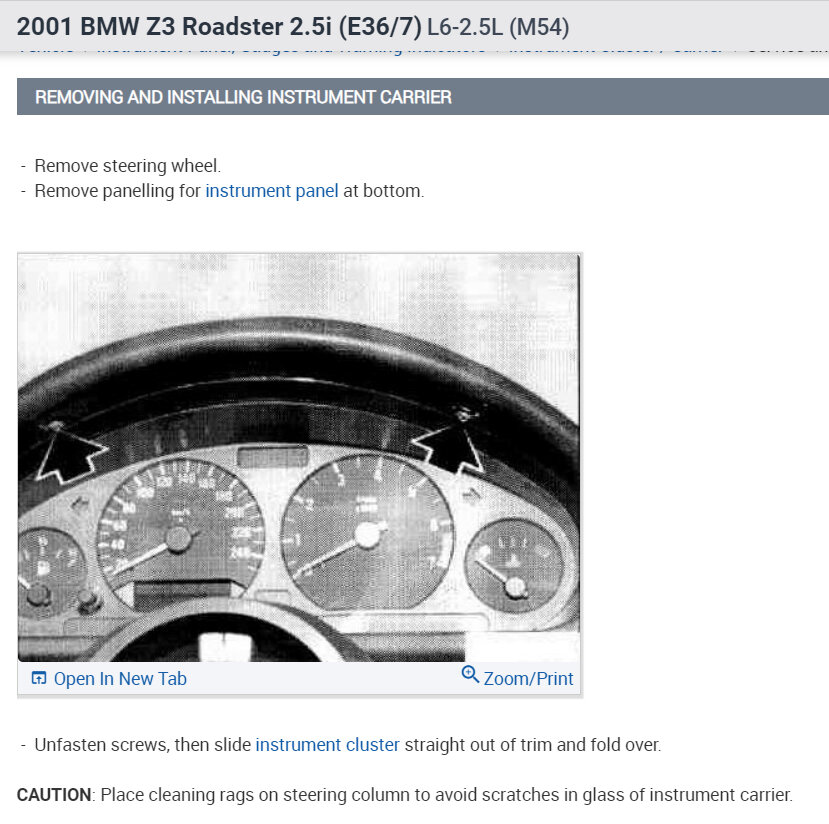

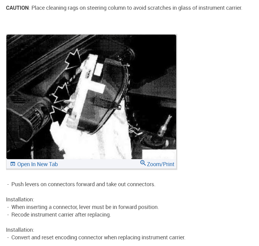

It sounds like the IPC has had a voltage surge which shorted the internals, but to be sure let's check the power and grounds by using this guide and the wiring diagrams below:
This will show you the fuses to check and the grounds, I have also included how to replace the instrument cluster as well. Check out the images (below). Please let us know what happens.
